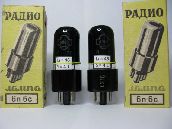

Does anyone have any experience with the 6N6C (6P6S)? I'm using some of those that are black, and came in the yellow boxes.
My readings are:
Plate Voltage 299v
Cathode resistor 470ohm, voltage drop 18v
Cathode current = 18 / 470 = 36mA
Screen Voltage = 299 - 18 = 281
Dissipation = 281 * 0.038 = ~11w
Should I worry about the screen voltage? The data that I could find on these tubes says screen voltage should be 250v nominal, 310v absolute.
Does that voltage need to be dropped or just c'est la vie?
My readings are:
Plate Voltage 299v
Sorry, bit vague. These are the ones I meant.

Those are Russian 6V6 equivalents, made at the Reflektor plant. Never heard of serious issues with them.Sorry, bit vague. These are the ones I meant.
Best regards!
Best regards!
Thanks Kay.
I don't like pushing components outside of their datasheet limits unless I know what I'm doing, but happy to rely on other's experience!
