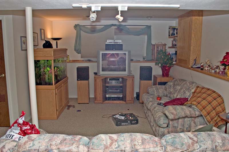

If you were going to build the ht8 and ht2c combo, would you go sealed on the center or ported. The kit for the center gives you a choice. I have always liked the sealed sound, but my reciever is powering the center at 75 watts (sony es). The roll off starts at 90hz for the sealed though.
Probably a question for raw, but I was wondering if anyone here has built these kits.
I really appreciate all the responces. I only want to pull the trigger once here.

If I were to build the ht8 and ht2 combo... well, actually I wouldn't, as the ht8's will probably be too much for your room and sound way, way too heavy on the bass! You said that you already have a sub, I believe, so you already have a means to touch up the bass if it later proves to be insufficient.
I don't want to be the Grinch and come between you and your dream, but your room dimensions are nearly the same as my living room, so I feel I'm on safe ground when I advise that you'd be happier with the HT-3. In a small room like yours (and Mine) the amount of room gain (or "cabin gain" as the car guys call it) is going to be fairly substancial and having 2 Extremis drivers per side will, IMHO, be too much. The HT-3 kit is also less expensive which will give you enough cash in your pocket to actually do some serious upgrades to the rest of your system.
As for the center channel, I would build it sealed. You'll have enough bass as it is and the sealed version goes down far enough that the sole purpose of a center channel is fully realized.
However...
I'm not a HT guy, so I may be way off base here, but given the size of your room I really don't think that you need a center channel. If you hold off on this, you can try it without a center channel and see if you feel that you're missing anything at all. If you don't need it, then you have saved even more money to put toward a serious system upgrade.
I hope that I don't come across as an entirely negative person, but I've been there and done that, and I'm trying to save you from having to learn what may turn out to be an expensive lession.
Whatever your decision turns out to be, good luck with your project.
