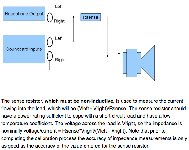

With REW, which can run on Mac computers, a rig using a series resistor can be wired or clip-lead connected to test impedance:
Impedance Measurement - REW - Room EQ Wizard Room ...
Dont even need a Computer or software.
2 meters and Series Resistor and Signal Generator / Function Generator
connected to any basic amplifier driving the speaker.
You can just use a Function Gen on a phone...if your phone has a audio output.

REW great. But good lab practice is to substitute and plot one or two resistors of known resistance (like a 5 and a 12 Ohm) and then run the driver to see how the three curves compare on your test set-up. And no calibration needed working that way.

With a tiny bit of soldering, one could make an impedance box or DATS "clone".
There isn't much into it.

Anything you need - including phase, if you take enough resolution to get accurate derivatives. Big if.
Or use a dual trace scope - one measuring voltage, the other measuring current. Well, voltage across an ohm other ten, same as the sound card test jig. Invert the “current” probe if the scope has that button. Plot the two traces, adjust amplitudes to match, then you can measure the phase. Just take the frequency points you need. You need fewer than if you were trying to construct phase from amplitude only. I even made a little “jig” amplifier that has a 10 ohm (selected to be exact) carbon comp resistor in the return, and the signal/chassis ground floated to the junction of the resistor and speaker under test. Have to float the signal AC ground (but not the feedback return) to the same point. Made it easier to connect a scope, the test jig, and sig-gen without chopping the ground prongs off the plugs. That got me thru the college years when the only computer I owned was a Trash-80. It did the T/S and filter calculations.
Amplitude is still best measured with a DMM, as you can get more than two significant digits and eliminate errors reading it. Frequency response of the meter is unimportant, as long as you use the same one for V and I. Or two of the same.
