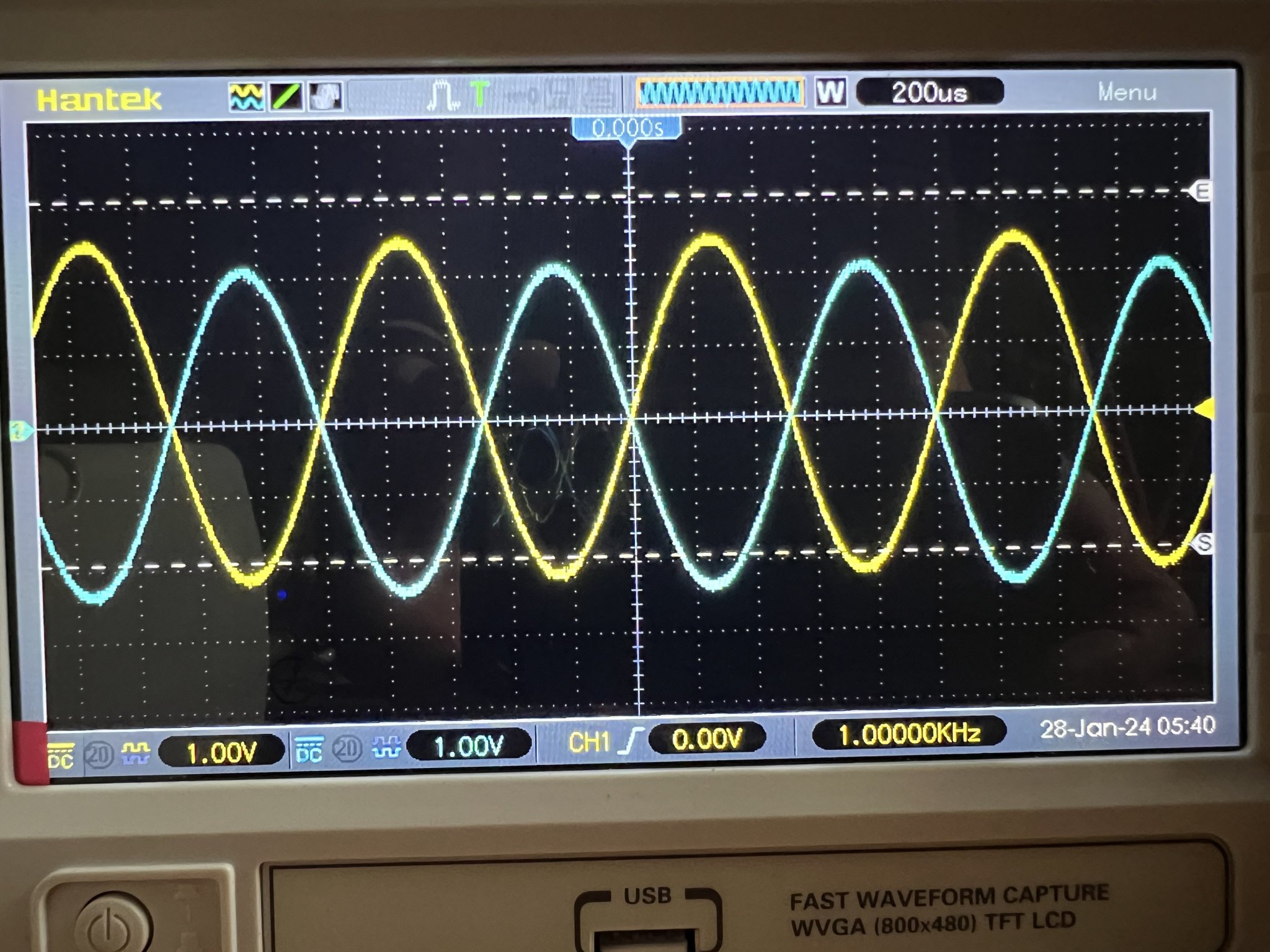

Been working on this "F7 inspired" clone, which has been a very fruitful adventure. Just as I was finished biasing the amp, the GND on one of the power rails jumped out and shorted to the V- on the same (this is at the PSU board) as I saw it happen I quickly I was able to power down the amp before "anything" happened. But as we know sometimes things happen in instants.
Before you scold me, I know, shouldve done a better job of soldering and confirming, which I'll you I thought I did, but alas, we've all been there I suspect.
After the frustration and panic subisded, and I got back to and and carefully checked and powered up the amp again after repairing the loose wire. All checked out and it plays normally.
Now, I've hooked up to a signal generator and an oscilloscope. The Oscilloscope was connected to a 8R 25W resistor meanwhile the signal gen is run directly to the RCA inputs. I am running a 1000HZ signal @5V to the amp, and I am hearing a high pitched whine coming from the amp somewhere. If I raise the frequency, so does the pitch go up.
Admittedly, I didnt get to this step before my incident, and this is my first rodeo with the oscilloscope and generator in this way. Inevitably I wonder if its related to my previous mishap. My intention was to check that the response was the same on both channels, though for all I know I am going about it all wrong. This is prior to hooking up to a analyzer to run THD etc.
All in all, looking for the best way to proceed - big DOH moment, and sadly, just before crossing the finishing line.
with thanks,
Ah that makes great sense - I dont know why I thought I had read that was a valid voltage to start. The scope sine wave is good, as far as my eyes can tell, attached is 1V @ 1000HZ, one channel each, so there is some mismatching with the channels, I defer to the pros if this is within tolerance. I dont have a before/after sparks flying to show for, however. Inverted one for clarity in the image.
Scope was given to me by someone getting rid of it from a defunct business, its like-new and ostensibly a nice unit despite my inexperience.

If you use 5% resistors, there could be as much as 20% difference in the amplitudes of the two channels.
Alway use 2% or better feedback resistors.
Or your scopes' probe adjustments could be off. Check both of them with the scope's calibration square wave.
You'll find that a triangle wave will be much better, for comparing amplitudes, and for checking the clipping point.
I think you're like on the right track there, Rayma, I need to place another mouser order (which usually times to be about 24 hours after placint he last, or abou when the last arrives.) and I can order some replacement, might be worth swapping those out universally and better match them
