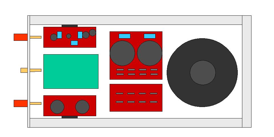

For the sake of reducing interconnect and allowing amplifiers to be located near speakers, I am considering the following for a bi-amp set up
per channel:
1 trafo with dual secondaries.
1 snubberised psu feeding LM3886 for bass
1 regular psu feeding LM3875 for mid+hi
Is it possible for each secondary to feed 2 bridges in parallel?
ie do the diodes isolate the 2 psus from each other?
or do you end up with both chips drawing from the snubber caps?
or does it just all go up in smoke?
or MUST I have 2 secondaries per psu?
TIA, Jim

thanks for the reply, But.. no, that's not what I'm doing!
I'm just thinking of using a different chip for the mid/hi and low and using each chip with it's favoured(?) type of supply. I would like to get away with one transformer per channel (per box).

As I'm not short of trafos I can protoype with a trafo per amp, but i'd like to keep the final product small(ish)
never did get an answer!
I'm finally building.
My box design is now a generously proportioned split level design, So I could use 2 trafos. However at 300VA I think one is plenty.
I have a total of 2xLM3886, 2xLM3875, and 2x snubber. I will be driving a FR125S from 160Hz-20kHz, and a 10" woofer from 30HZ-160Hz, both are 8ohm.
My current plan is LM3875 driving the FR125S and the LM3886 snubberised driving the woofer.
However I could reverse this, or I could run both amps from one snubber.
What would you do?
