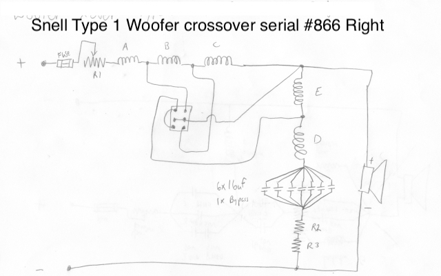

This project is almost finished. I have speakers with crossovers! All that is left is to enclose the crossovers that are now external to the speakers.
Here are some pictures documenting what I did and found.
First picture is of the crossover removed from one speaker. The plate was used to mount the fuses, tweeter level variable resistor and a 3 way switch for midrange level.
Here's the outside of the plate. Even though the poles allow bi-wiring, the grounds are wired together.
Lots of wire cutting was up next. Considering the electrical tape and the wire nut, I wonder if I was the first in here? Also the woofers were both wired out of phase with the tweeters!!!!! I wired it correctly, but must admit, I bi-wire and wired the woofer out of phase for now.

For the tweeter side, I used Sonicaps. Woofers used Solens. Replicated the values everywhere except on the tweeter side, where the 2mfd in series with the 8 and those in parallel with an 8 was replaced with a 5.6mfd in parallel with a 4mfd. I retained all the original small bypass caps and bypassed further (using the 1% rule). Here's an in-progress picture. And you can see the Stripall's and the glue.
Here's one crossover completed, without an enclosing box (to come later).

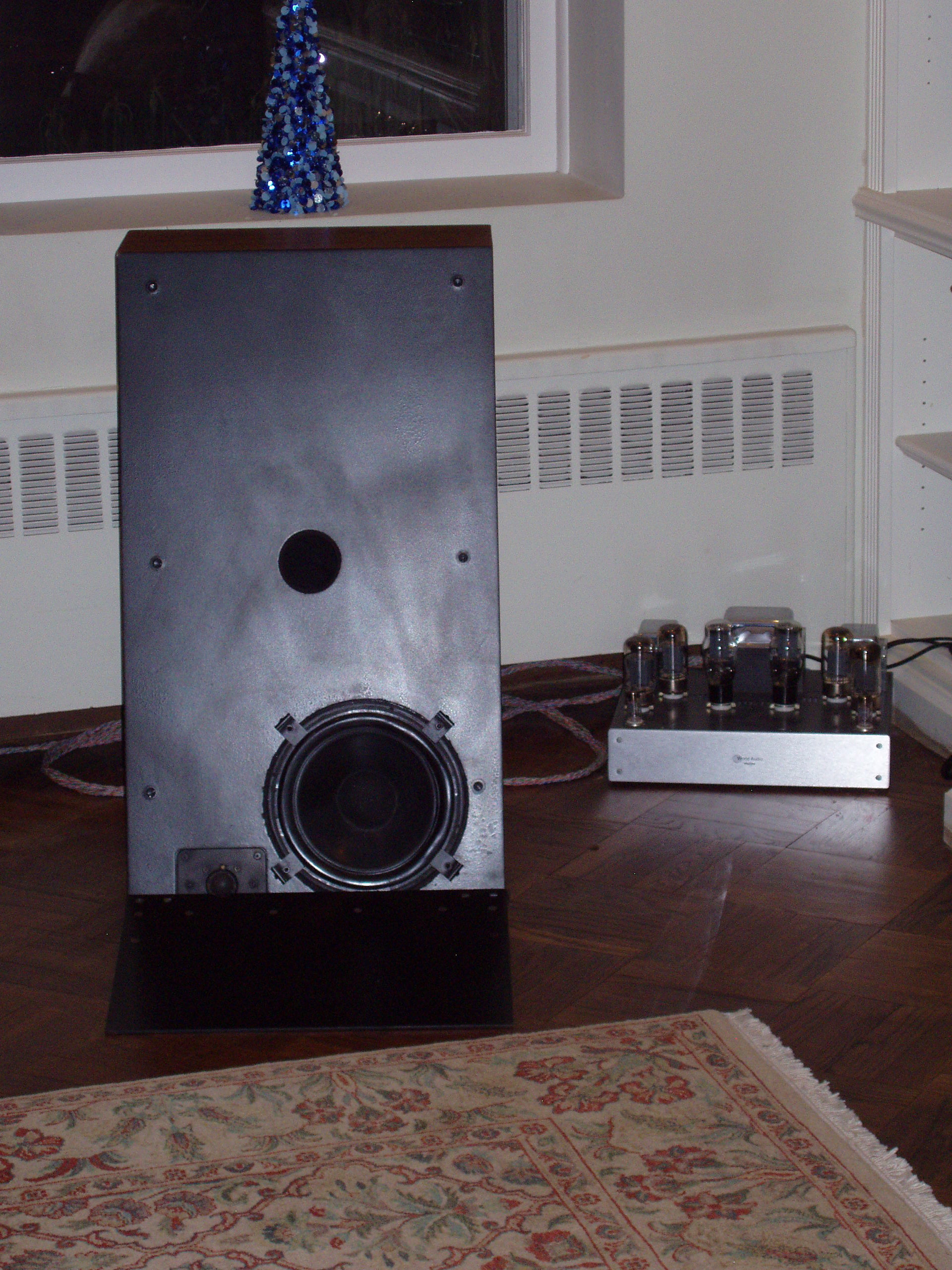

Picture of the crossover behind a speaker for now.
And the front shot.
I managed to give a bit of a listen and they sound great! (But they did before the tweeter fuse broke too!)
Seriously, I was always concerned with the clarity of the tweeters. The new crossovers removed a bit of "congestion." But time will tell as the caps break in.
The woofers were just starting to flap around before. Now with the repairs, solid tight deep bass!
