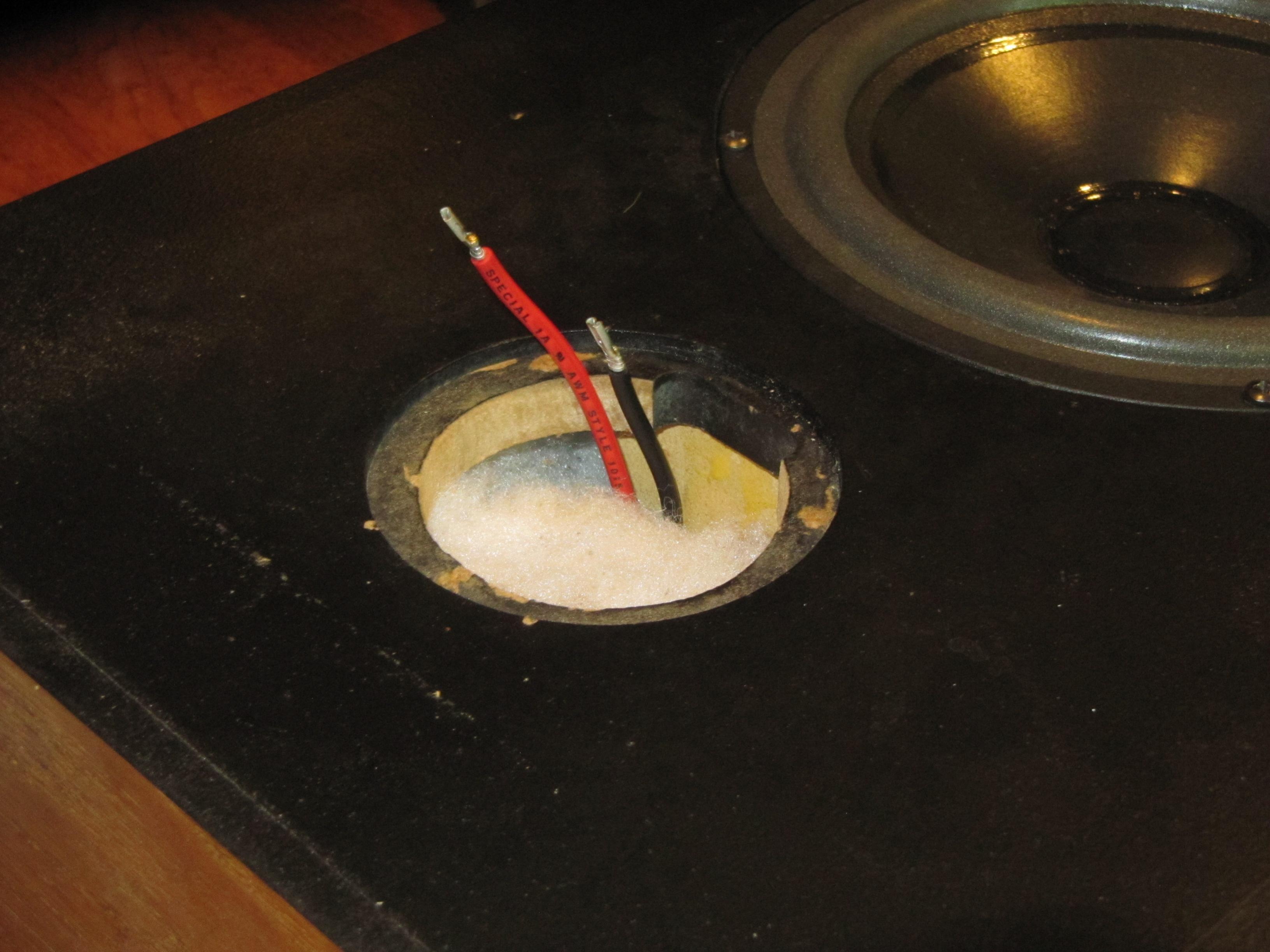

Okay, I went with Morel 1-1/8 soft domes. I'd say I did a lot of research, but they had the correct size faceplate!
Just listening, but I'm super happy.
I had to get out a wood rasp and open up the hole a bit more than taking off the paint.
And what was up with one speaker having such short wires. What a pain that was.
Look at the state of that old tweeter!
