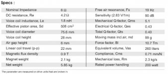

If those specs are fore real :hot: I doubt you will find any :cannotbe: though, SBAcoustic 12" is pretty close 😀
A repair could seem like the best way, but I doubt it will maintain those specs after repair...could end up being way off 😕
