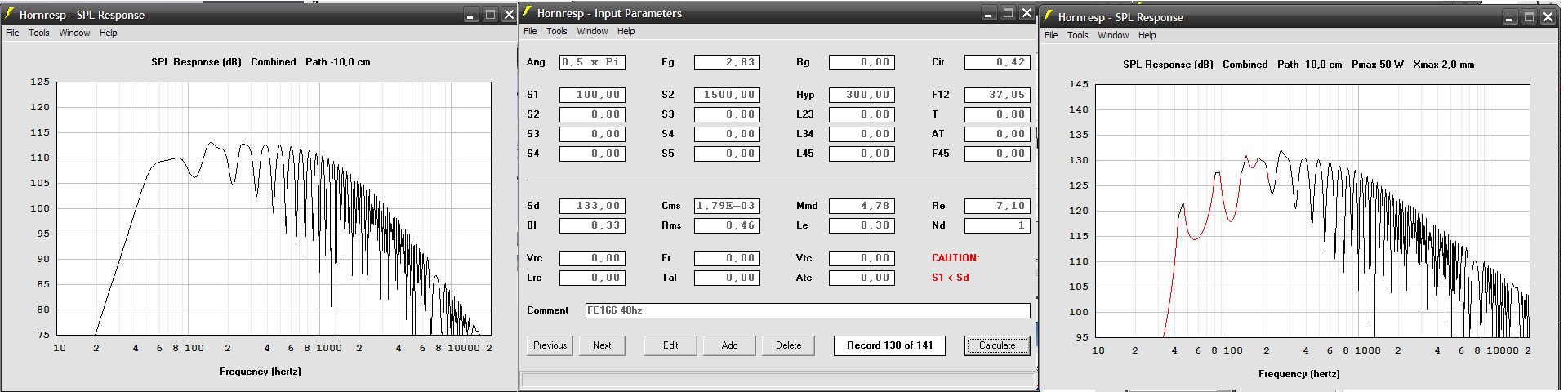

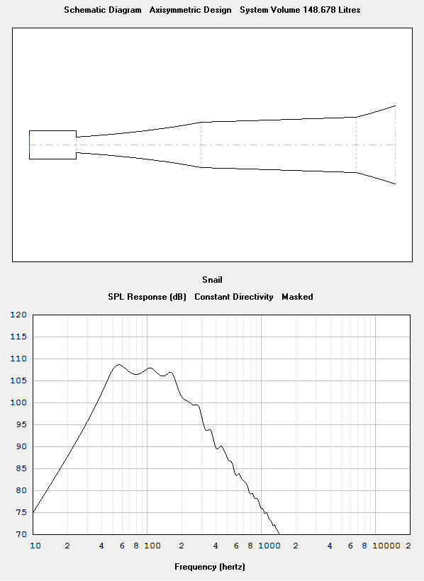

What is k then? As far as I know all of this design is blind as I forgot to design any eyes onto it. None of it is real so far, I have not started building it yet!
I said in the original post this is not a simple horn, therefore I'm unsure how accurate the predicted response is. That is in fact the main thing I was looking for comment on!

As far as I know all of the horn is blind as I forgot to design any eyes into my snail. None of it is real for that matter as I've not built it yet!
I fail to see why you need a fully completed cogniscent speaker system to estimate it's bass response or how easily a tube amp would drive it!?
In my firt post I said this was no simple horn and was unsure how accurately hornresp would deal with that. It's one thing I was hoping someone familiar with the program could comment on.

Ah! I was hoping someone might expand on these 'other matters'
The coiling of the horn was a slight concern of mine but less so than things like
-the aspect ratio of the mouth (300x26 mm)
-the narrow bandwidth of the horn effect integrating with the rest of the driver's response.
-the physical chalange of creating a stiff enough curved path (current thinking is kerf cut mdf for the curve with voids filled during construction with pva, ply for the faces.
And hopefully a host of issues I hadn't even thought of.
Would I be better off just building a BR for instance? I need fairly high efficiency, I want lots of bass, I don't have much room. Is this a 'pipe dream'?
Frankly, given what it is you state you want, I would be more inclined to run the 166 sealed, or loading a short midrange (front) horn, with supporting woofers crossed in at a suitable point.
The aspect ratio of the terminus is a bit high; you may get away with it, but YMMV as always. I'm not a big fan of MDF, but it should do the job in this case if you decided to go ahead & try it. I probably wouldn't bother with a BR; the 166 isn't ideal for that type of box -not if you want lots of bass anyway.

Oh you have my empathy, hearing that you've spent hours simming. I've done the same and it is ridiculously labor-intensive. So here's my two cents.
If you want the flattest response in the smallest enclosure, theoretically, MLTL would be the way to go. To fully flatten the response (considering baffle step), you'd most likely need either (a) a second driver (which you've said could be a budget breaker), or (b) a circuit which would sacrifice a bit of (perhaps a very tolerable amount of) efficiency.
But the horn has other advantages. Your sim shows a bandwidth of roughly a couple octaves. Those octaves will potentially sound very dynamic, airy and exciting.
So the trade-off is MLTL (more compact, potentially flatter, potentially deeper bass) vs. backhorn (bigger, more efficient, very likely less flat and/or less extended in the bass, but coupling to more air which some find exciting.)

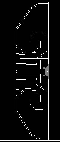

I'm really leaning towards the saburo / mikasa just at the moment or maybe my snail horn contour worked into a similar double mouth design.

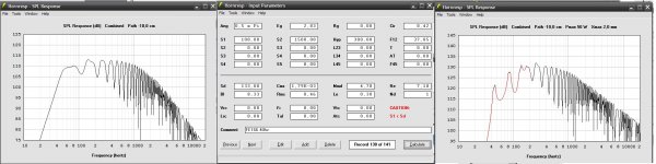

What I'd really like to know is how my contour is likely to perform (see attached).

Probably not too badly; at least the graph looks promising, & the different expansion contours are not necessarily a bad thing either.
Generally speaking, I don't advise trying to smooth out a manifold style horn; in a lot the bends are functional, including these. Typically, you'll end up raising the upper corner frequency, which may not be such a good move.
Pretty much what I thought. Part of the reason for using a smoother contour for the snails where I don't want to lowwer the upper corner.Typically, you'll end up raising the upper corner frequency, which may not be such a good move.

Where do you feel it falls short? Have you looked at my sim? Is it faulty somehow? Or do you not feel that 115db(corner loaded) is suffecient? What do you feel would be a better driver? If I'm not mistaked this is exactly the sort of application the Fostex drivers were designed for. I have had personal experience with the FE206E in this sort of application and it more than excelled. All of the other drivers that have been mentioned have much higher Qs which makes for ill defined bass IMH.
