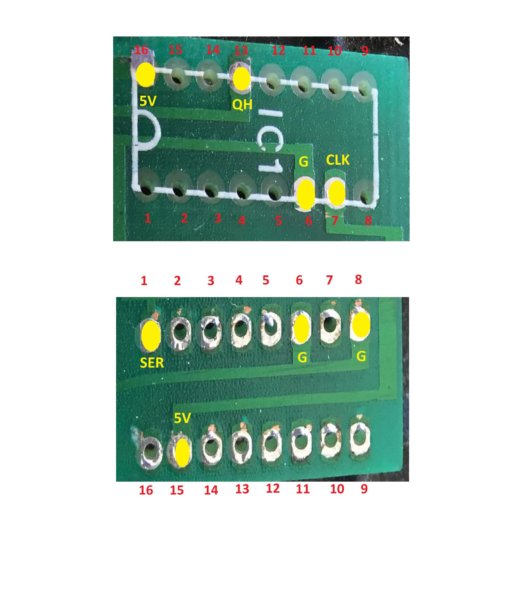

This chip is/was used in Cambridge CD2, CD3 and the DAC3 (I think) from my understanding the digital data signal goes into that then goes to the DAC chips.
My question is I repaired one that failed, it was the only real problem that needed addressing to get sound out. Why was it so simple? well it seems to be a very very common problem and my question today if anyone has any answers ias to why does it fail so often? Its a bit late to complain to the manufacturer since its 30 + years old but just very curious as to why those particular chips fail even before the caps!?
There seems to be not much information online and I wondered if there was a replacement but when I googled the replacement part nothing came up. Thanks!
I have no idea why it failed. Even though IC's are generally very stable, they can fail without any apparent external reason.

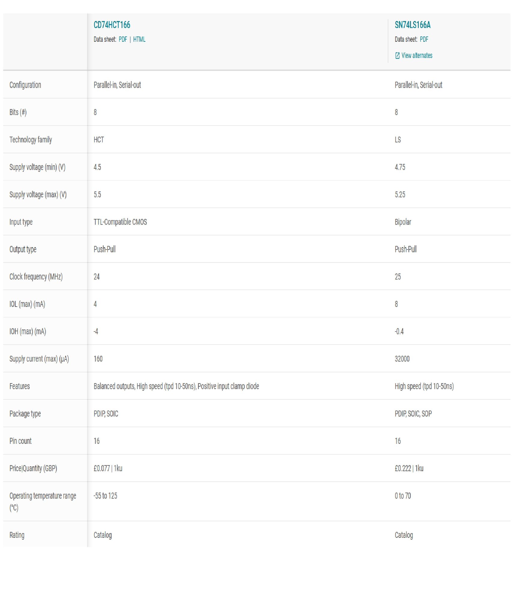

Regarding replacement, there seems to be plenty of options. A direct replacement could be:
https://www.ti.com/product/SN74LS166A
This can most likely also be used:
https://www.ti.com/product/CD74HCT166
Both are available in SO and DIL packages.

The IC itself seems to have a power consumption of around 150mW.
What kind of PCB is used (does it have a good or poor heat transfer)?
Over-voltage might be another reason. The LS devices have a fairly narrow supply window.
The HCT version has a wider supply window and of course a much lower power dissipation.
But there might be reasons why a CMOS part won't work in this application. Without a schematic and tests, it is difficult to say.

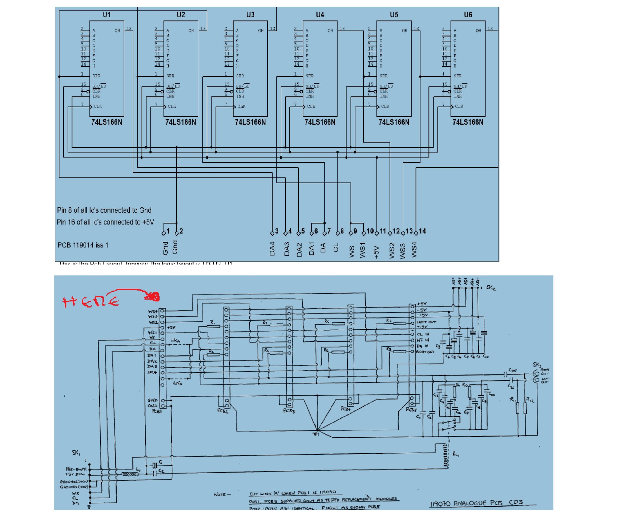

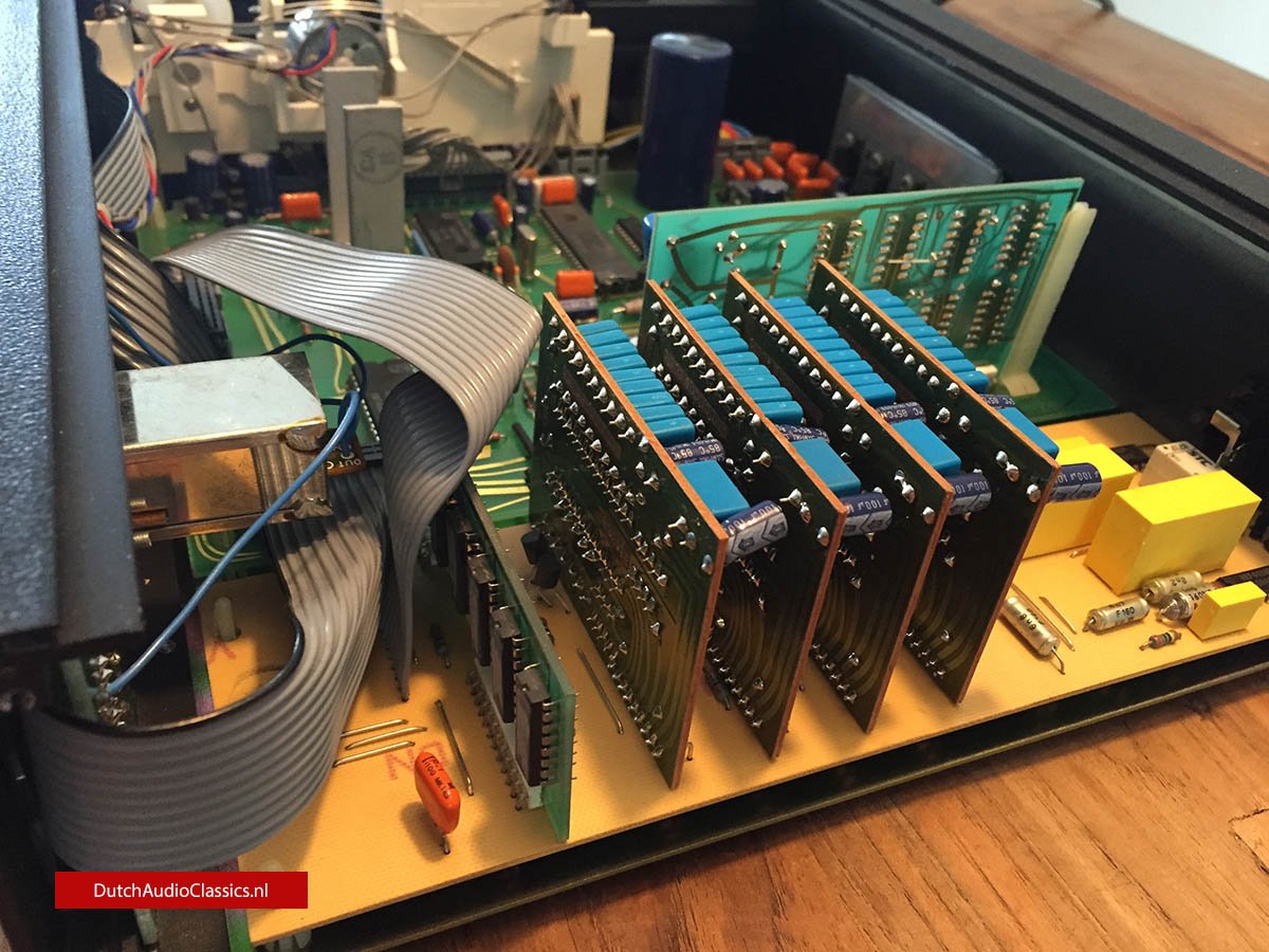

You can see from the photo attached its the PCB being the 4 vertical DAC boards. The schematic shows wheres it connected. Someone has drawn the schematic and I hope they dont mind me using it for studying purposes. As you can see all the main data lines to go it, get buffered? then output into the DACs, DAC1, 2 3, 4.
I didnt post a schematic of the PSU as its just one 7805 regulator. Also the picture is CD2 but the shematic is CD3. The PCB with the SN chips are identical but in the DAC3 according to a post most are SN but some are different. Its in Diyaudio if anyone wants me to find and share?
The only oddity I see is the pre-emphasis relay coil has no diode. Maybe some voltage spike getting to the LS devices. As Jens mentions, LS is 5V and not very tolerant. Heat would be another, but the photo shows a layout that doesn't look bad for heat. Plenty of space. I've got LSTTL stuff I built in the 70's or 80's still working.
Only one capacitor for an entire board with shift registers, the board being a two-layer board without ground or supply planes? (At least that's what it looks like on the photo.)

OK from my understanding this is what I got so far. In orignal board the CLR pin 9 was left floating. In this case its tied with 1k to 5v.
Also all the inputs are left floating and not used A-H in original. I noted it was mentioned noise may be introduced if it was connected via 1k to 5v. So is there a need?
My original question was why does this fail? So far from my basic understanding of this chip, the relay may have had some affect, although it was a pre-emphasis and I guess only switched on when certain CD's were used.
And the other cause may have been from the pin 15 not having a resistor?!?

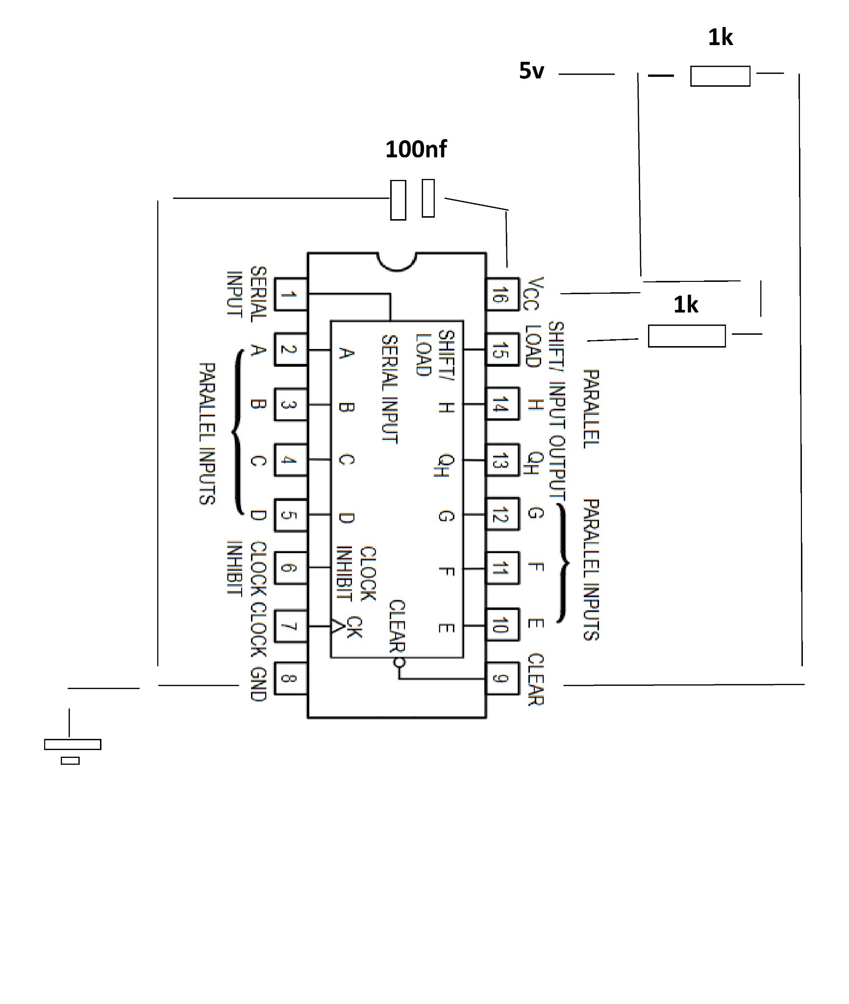

Lets just assume the pre-emphasis relay was taken out. With the design now given in the drawing attached would this be performing optimally and free from circuit design failure?
Another question just came to mind, would I use 1k for pin 15 and pin 9 per chip or would I tie all pin 15 to one 1k. What about pin 9? Each 1k or just one for all 6 chips? Note pin 9 was left floating before.

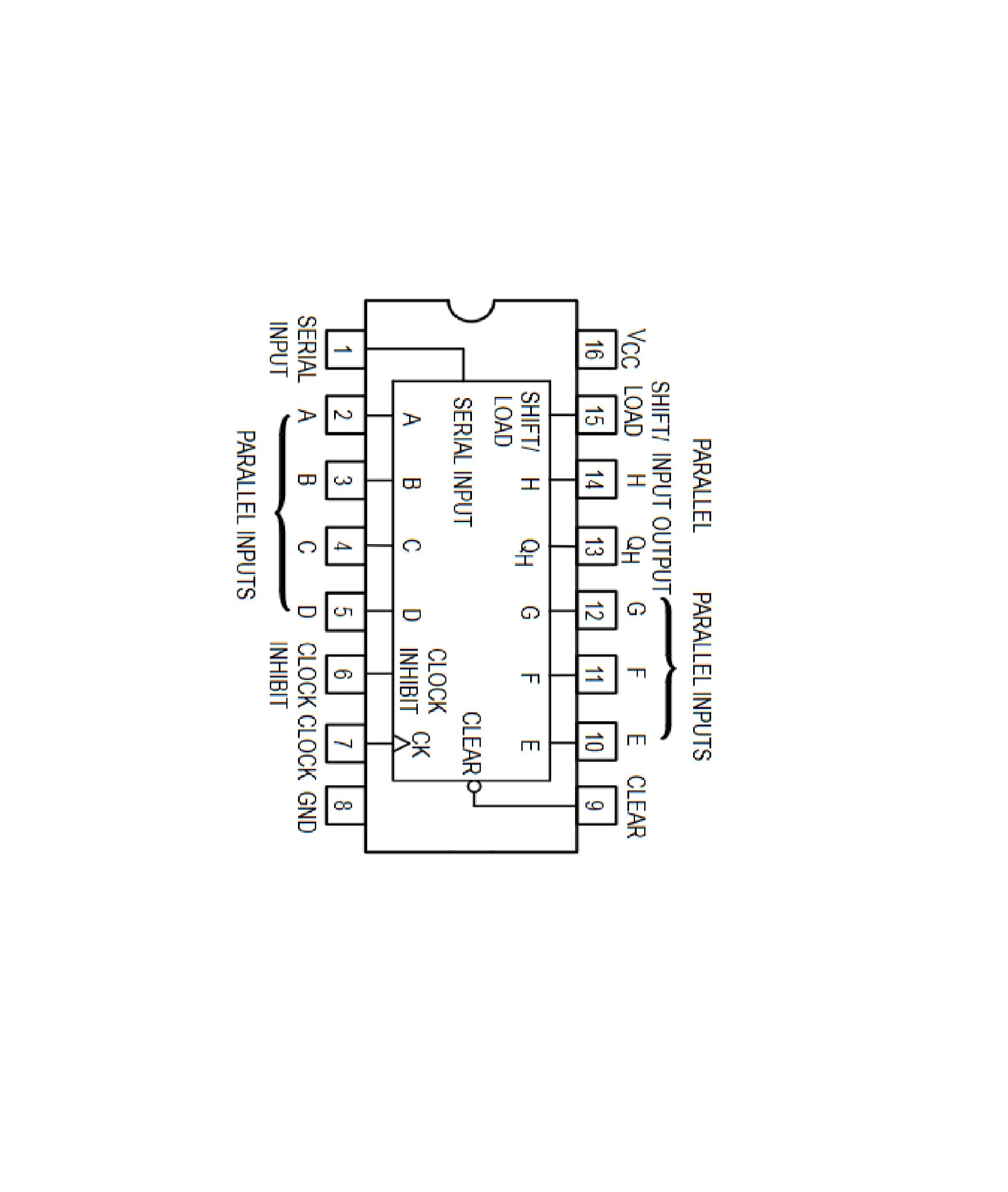

That's not quite what I meant. Noise margin is jargon for the difference between a high or low level and the switching threshold of a digital circuit.
When you leave 74LS inputs open, they are seen as high, but it's a bit wonky. With some crosstalk from other digital signals, they might occasionally be seen as low.
For inputs A...H, this doesn't matter, as the levels on these inputs are never used in your circuit anyway. Connecting A...H to the supply via 1 kohm would do no harm, but no good either. (This is all assuming you stick to 74LS logic, it's different for 74HCT.)
Pins 9 and 15 should be tied to the supply via 1 kohm resistors. Tied high to ensure they are always seen as high and via resistors to make the circuit more robust against supply voltage peaks.
You can use a common resistor for several inputs. In theory up to 100 inputs, but I wouldn't go above a dozen or so.
