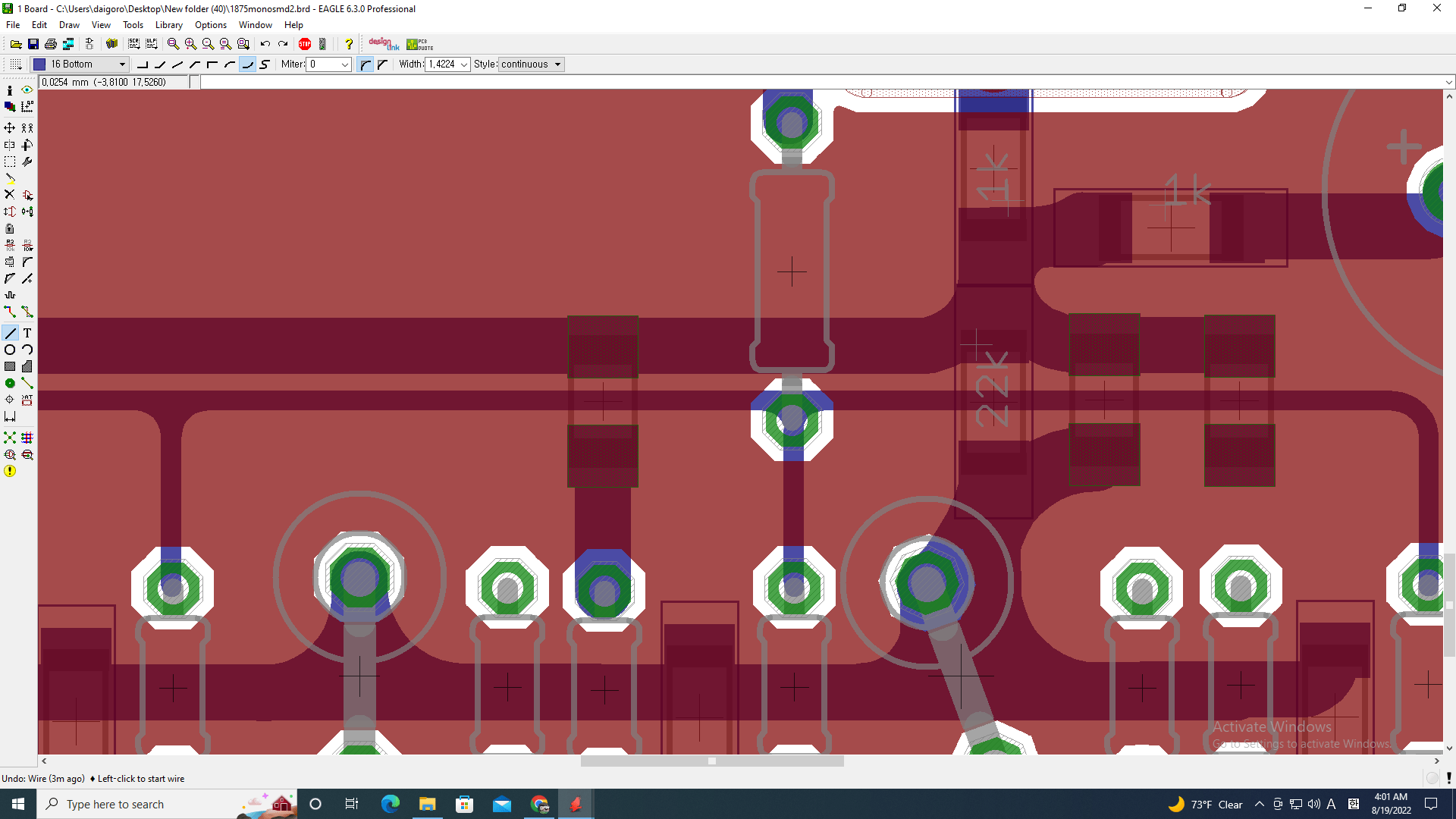

im drawing a pcb for a nested opamp power amplifier and one routing option i have is to route the output trace from the opamp between the pads of the smt caps like so. the smt caps are local feedback that returns to the opamp negative input. the output trace is meager 0.5mm for safety margins. i'd like to know if this is an acceptable practice or not. is there modulation issues? or is this actually good coupling since whats passing thru the caps are the opamp signal anyways?
below is the situation in question
also the output trace has no choice but to go between the feedback resistor pads (22k ohm)
