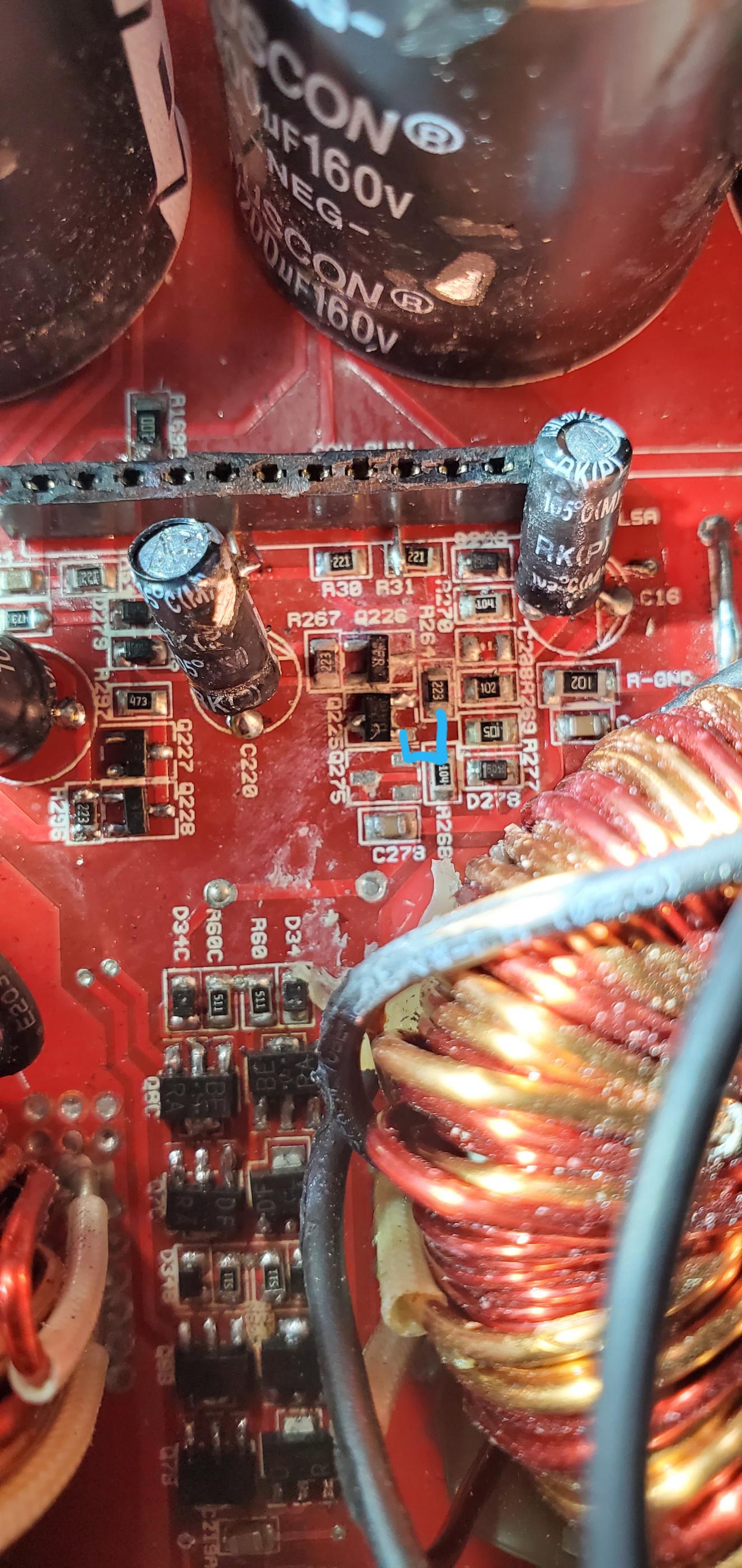

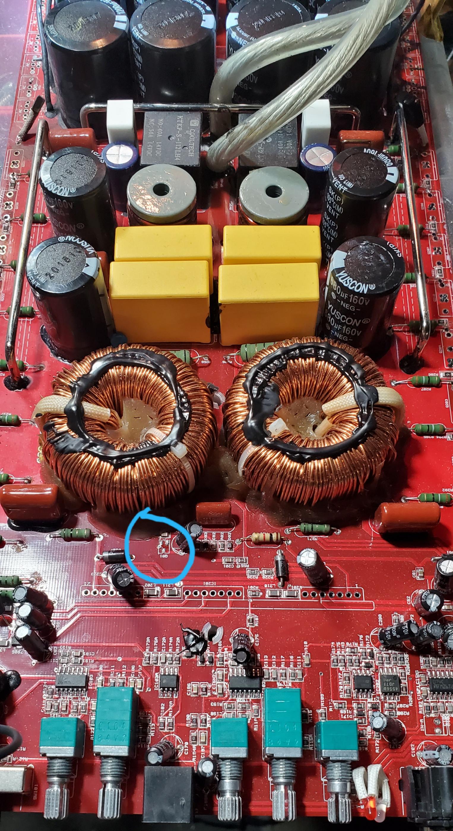

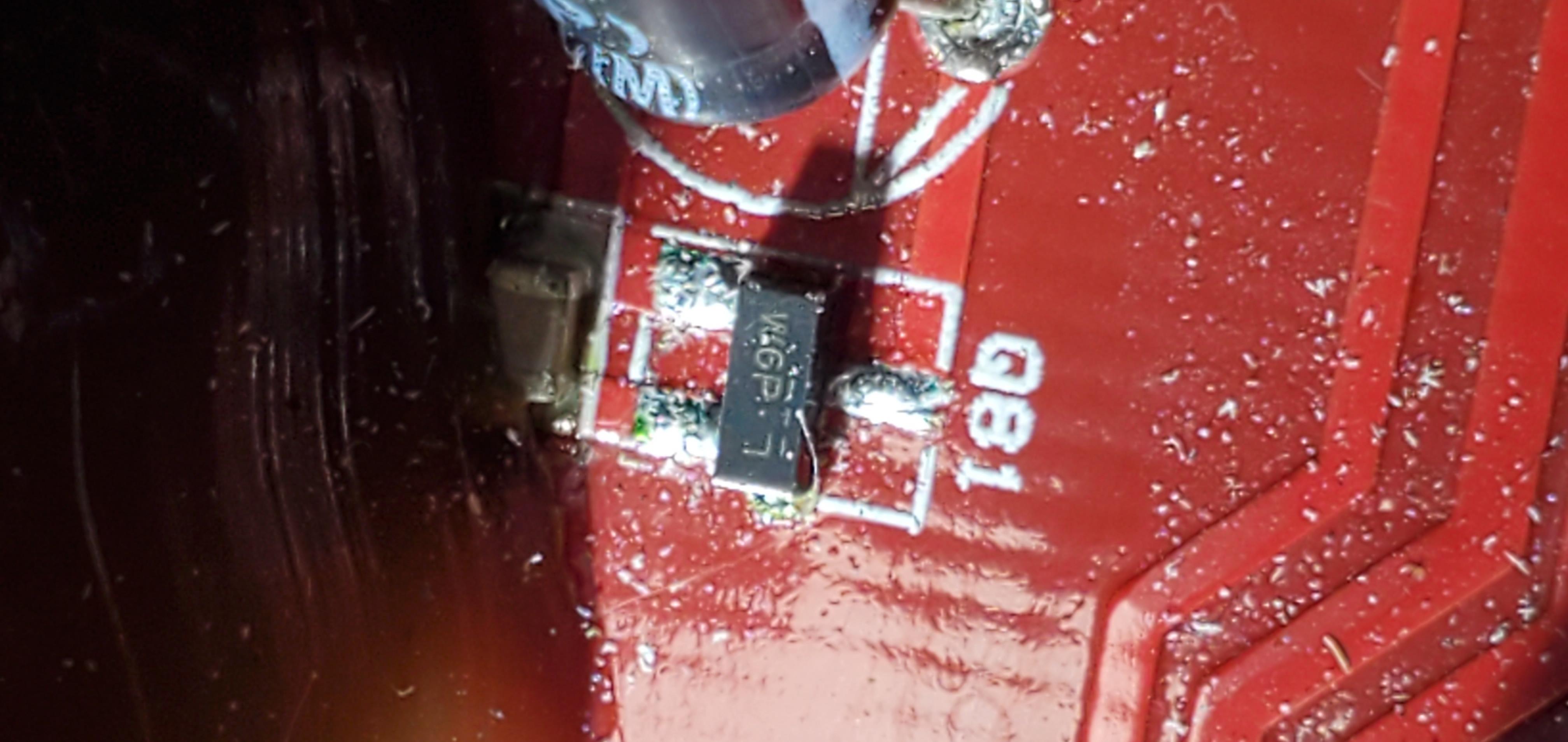

I am trying to identify Q81 in a Skar RP-4500. I believe its part of the remote or protection circuit. I dont know what to replace it with.

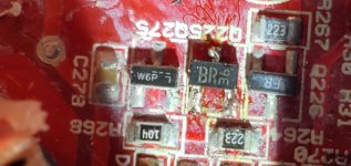

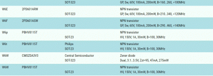

I believe the identifier is W6 and the P is the date code. I dont know which manufacture uses this style of date code marking. It appears to be the same transistor used in Q275. See attached.
I believe it is a pnp because I have tested in diode check off board.
black probe on base red probe on collecor =.701v
black probe on base red probe on emitter = .012v
in resistance mode its showing 25 ohms between the base and emitter.

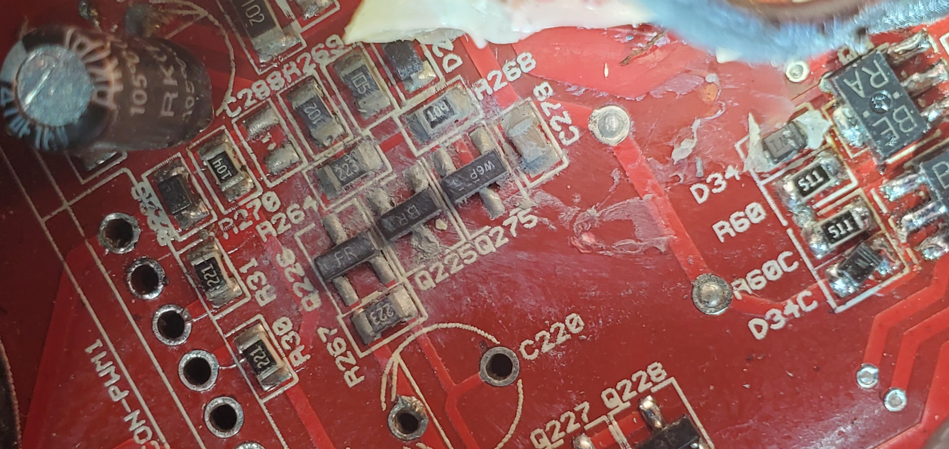

It is possible seeing as i have no signs of life and the relay doesn't engage and i believe Q275 is part of the remote circuit but i am unsure.

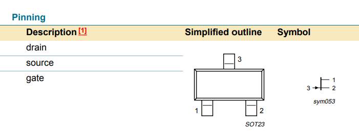

Q275 pin 1 is directly connected to ground.
Pin 3 of Q275 is connected to the base of Q225 (2sc2412k).
Pin 3 of Q275 to ground i measure 99.7kΩ

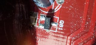

Starting with resistance mode.
Red on pin 1.
Black on pin 2: OL
Red on 1 Black on pin 3: starts at 45Ω and decreases to 25Ω with a time span of about 20 seconds.
Black on 1 Red on 2: 6.6MΩ
Black on 1 red on 3: starts at 45Ω and decreases to 25Ω with a time span of about 20 seconds.
Diode Mode:
Red on 1 Black on 2: OL
Red on 1 Black on 3: Starts at .040v and drops down to .015
Black on 1 red on 2: .703v
Black on 1 red on 3: .015V
