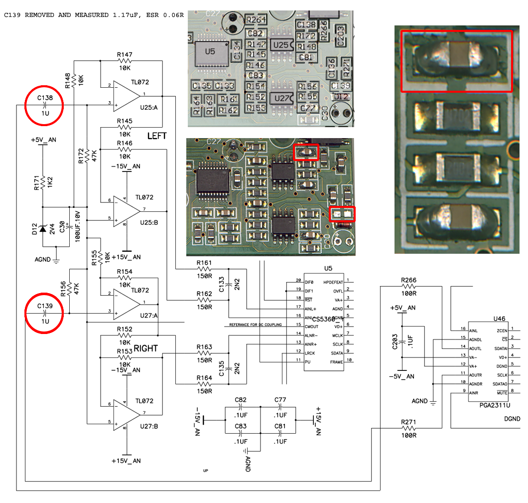

SMT ceramic cap found in critical audio path in high end AV amplifier, please advise?
Hi, it's a while since I've posted on this forum but I would really appreciate some opinions from other experienced engineers on this one please if possible...
Attached are high quality photos and schematics of the circuit in question.
The outputs from the PGA2311 DCAVC are AC coupled to the inputs of the next stage via 2 x 1uF SMT ceramic caps. The legend on the schematic is incorrect, they are non-polarised caps.
One has been removed and measured. I believe they are not NP0/C0G types, or indeed any other different type such as film, due to their physical characteristics. As far as I can tell they are X7R or similar. The amplifier was designed approx. 10 years ago and the capacitors have not been changed since it was manufactured.
My immediate thoughts are I believe in line with conventional wisdom, that this type of capacitor should not be used in these locations. Does anyone have any different thoughts on this?

Looks like the capacitor is an excellent choice and the ESR is very good. One cannot expect to fit wire ended components on an SMD board and after all, the conductivity of SMD components usually exceed wire ended, as long as Lead Free solder is used to solder them or replace them, (it stops leaching of the tin coated conductors at each end of the component).
Hi Jon,
Thanks for the reply. I was not intending to replace with a through-hole component, rather upgrade to a SMT film type.
I can find very many references from reputable and classic sources, articles and books arguing against using ceramic caps in a signal path as shown, I realise they have improved over the years but I don't think this is a type which has been improved - the equipment is fairly old and it looks like a bog standard ceramic as would normally be used for supply bypassing, etc. and I have not seen such caps used in the signal path before, I don't think?
You'd be surprised at how often caps like this appear in AV equipment.
Panasonic ECPU1C105MA5 is a good replacement, but beware the low voltage ratings of film capacitors in relatively small sizes. This limits the maximum input voltage (I think these are limited to 10VAC, check datasheet). These ones are 1210, which should just about fit into the existing 1210 pad. The presence of bias complicates matters as it reduces the overall voltage handling ability.
If you are aware of the parameters determining the possibility of using them, you can substitute the caps for film types. In this specific case you may have some issues because of the circuit itself.

Yes, use a film type surface mount. You're going to be further ahead if you pre-tin the capacitor and one pad. Once the new capacitor is positioned properly, solder the other side.
I use eutectic 63/37 solder - leaded. You need the lower temperature and superior wetting too. A touch of liquid flux can do wonders. In this way you can avoid damaged new parts.

Yes this thread was mainly posted because in 20 years of working with audio equipment I don't think I have once seen ceramics used for AC coupling between high quality audio stages, and in fact in all that time so much advice has soaked in to the contrary so this came as a bit of a surprise. But I understand there may be minimal distortion for the above reason... it just seemed an unusual choice by the designer.
It is a leaded board and I'm experienced with working with SMT, but thanks for that additional advice all the same. I think I will replace with film as I originally thought, I'll do some careful selection considering the circuit topology and physical constraints.

I found huge improvement in replacing tantalum 5 uf input caps on my amp with 50 V cop ceramic input caps, aerovox gold to be precise. The original 1970 caps passed less bass, the tantalum replacements had frying pan popping hissing noise. I suspect my local parts store was selling rejects, as was common before e-bay consumed the stock of rejects.
Look at the capacitance versus voltage curve of ceramic, and imagine a 1 v signal impressed on a 50 v cap. The curve is a lot straighter if you use only one fiftieth of the curve.
In your circuit with no diode clamps to the power supply, I'd be more worried about static blowing the TL072 through a low voltage rated film cap. Small size is a limiter.
My amp had an input impedance of about 500kohms to be compatible with 12AX7 plate drive preamps. You might straighten out the curve by curring current flow. Change the input and feedback resistors to achieve an input impedance of 200 kohms or so. If you have to change to metal film resistors to minimize hiss, so be it. Above 100k the difference hiss between metal film and carbon comp resistors is very audible. I've never bought any carbon film resistors to see how they fare in the hiss dimension. A diy poster said metal film was the standard in hiss reduction. I find no reason to buy anything else.

That cap is likely of x7r or similar type ceramic which means its capacitance varies with the voltage across, which is what gives ceramic bad reputation for audio application that it rarely deserves. Properly designed circuit ensures minimal voltage variation a x7r ceramic cap is exposed to within the frequency range of interest during operation, usually at lower end of audio band, and minimizes the ill effect the material's characteristic may cause. In this AV amp, if concerned, you can stack mount a Non-polar electrolytic, 4.7 or 10uF, on top of the original 1uF, to further cut down the voltage at low frequencies. The size of the SMD caps appears to be 0805 in the pictures, so this is quite doable.

So I'm curious as to what has led to this determination that something is wrong with this pre-amp. You've read some references, looked at the parts used, and called out a fairly experienced manufacturer for using a "bad" or substandard part. Have you measured this system? Are these caps for certain causing some sort of measurable or audible problem? I'd love to see THD vs. frequency plots at various operating levels passing through this circuit. This type of measurement is something most hobbyists are unable to measure properly, but most established designers have the equipment to do so.
I looked into distortion from ceramics used in AC coupling capacitors last year and found that it took surprisingly low corner frequencies to eliminate additional distortion. A rule of thumb that I developed from those tests were to put the corner frequency 2 decades below the desired passband to prevent distortion from the coupling capacitor. My test results are shown in this video on TI's website around the 5:35 mark: https://training.ti.com/ti-precision-labs-op-amps-low-distortion-design-4?cu=14685

1decade below the passband is used by D.Self for electrolytics. The same can be applied to the higher distortion plastic film types like MKT/MKS.
2decades for a medium K ceramic seems to be about right.
10uF into 82k gives 0.2Hz F-3dB, or 4u7F into 160k.
and is just about workable.

Isn't is best to avoid this problem to begin with? Seems to me that replacing that capacitor is the most responsible thing to do.
Hi nattawa,
