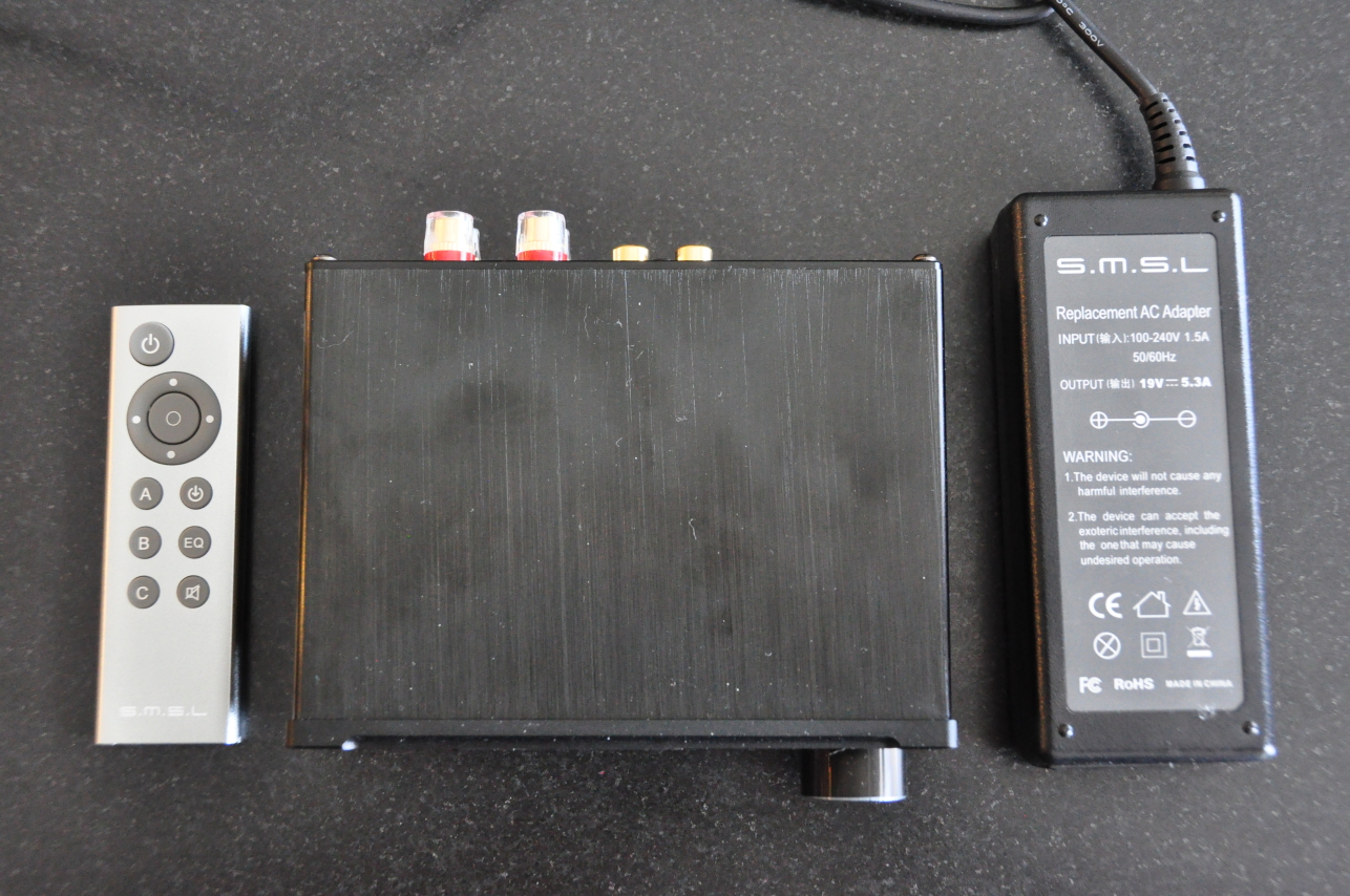

The included laptop-style PSU is 19V; likewise, the DC input label on the device itself says 19V. Does anyone know if I can safely run this thing at other voltages? In particular, I'd like to feed it 13.8V from an Astron power supply. That's the only "mod" I can really do right now, as all my stuff is boxed up for a move to a new house. (Which was the justification for buying this thing in the first place: one small device that just works so I can pack up all the DIY clutter I have strewn about the house.)

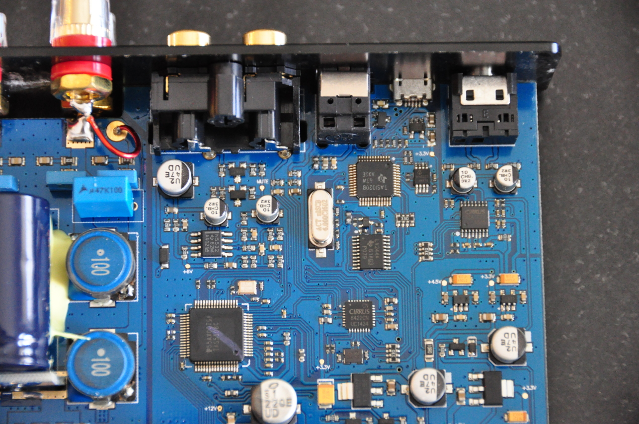

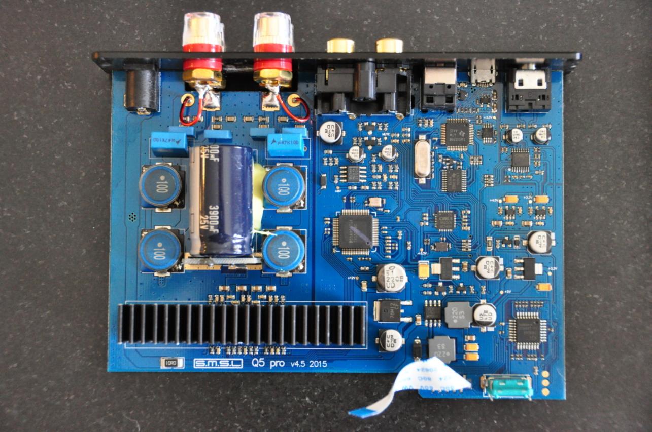

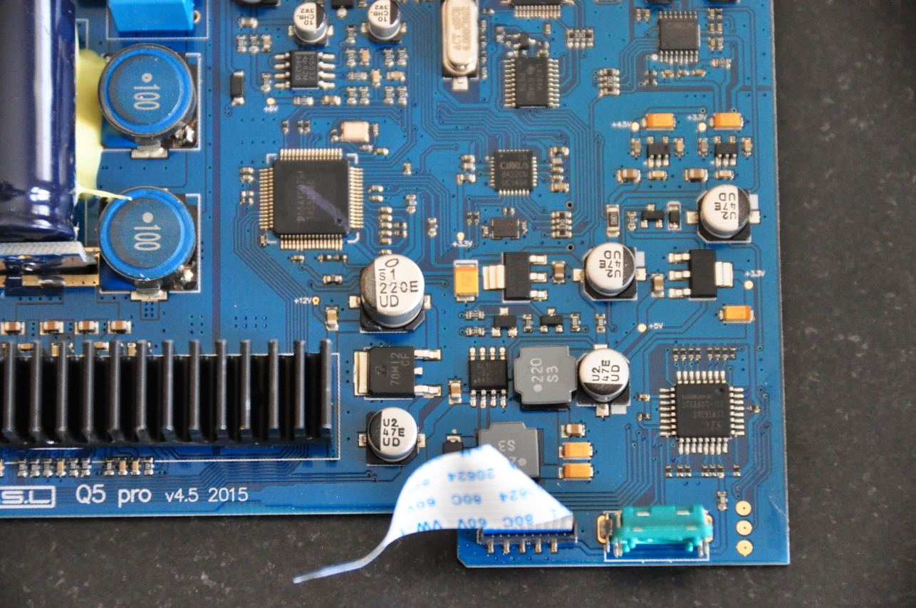

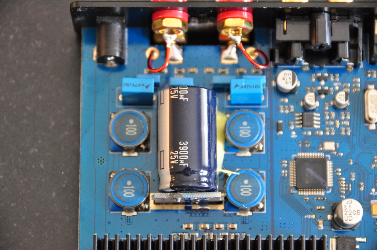

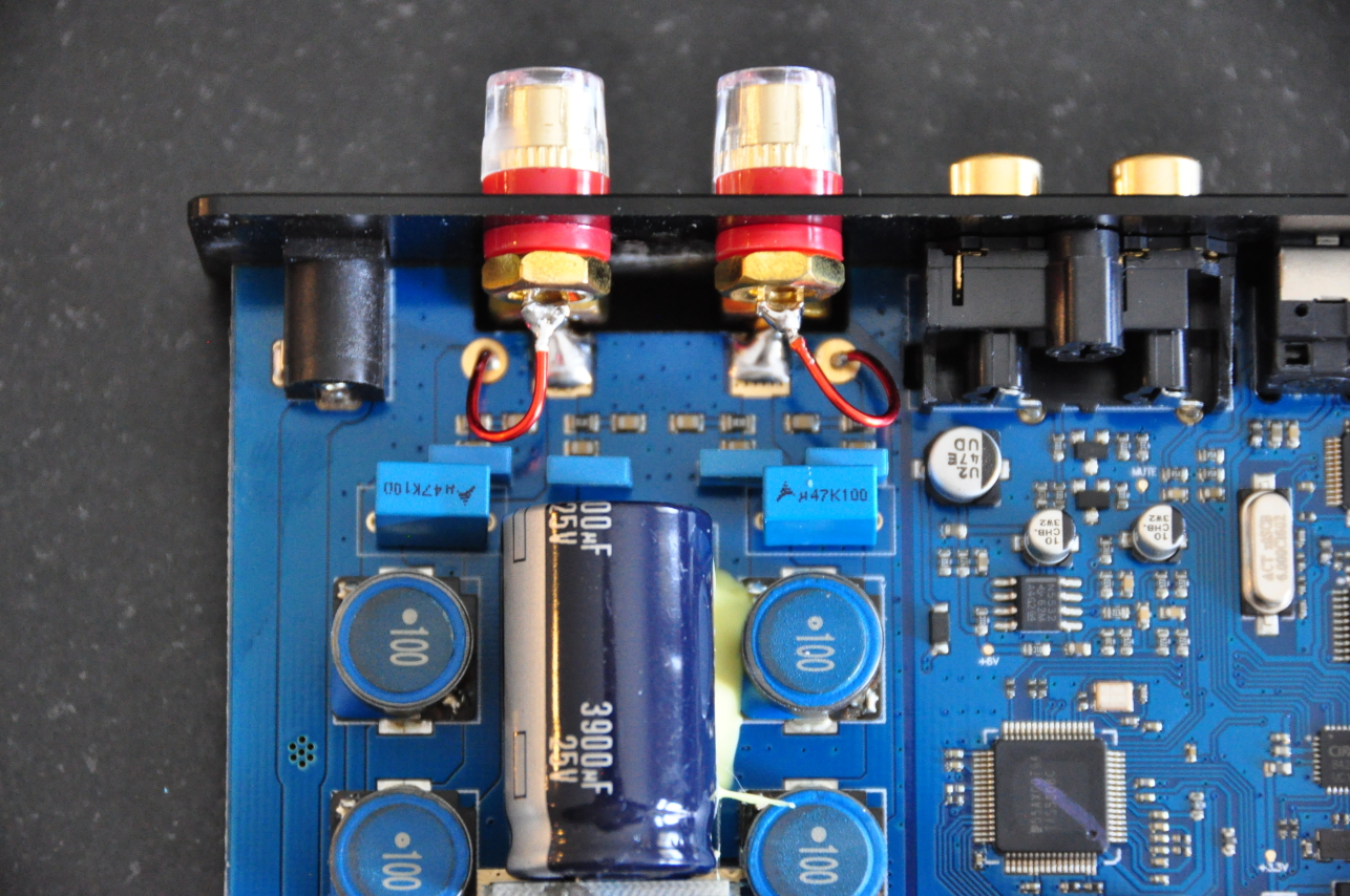

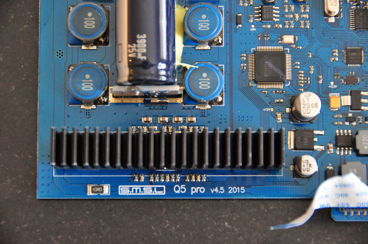

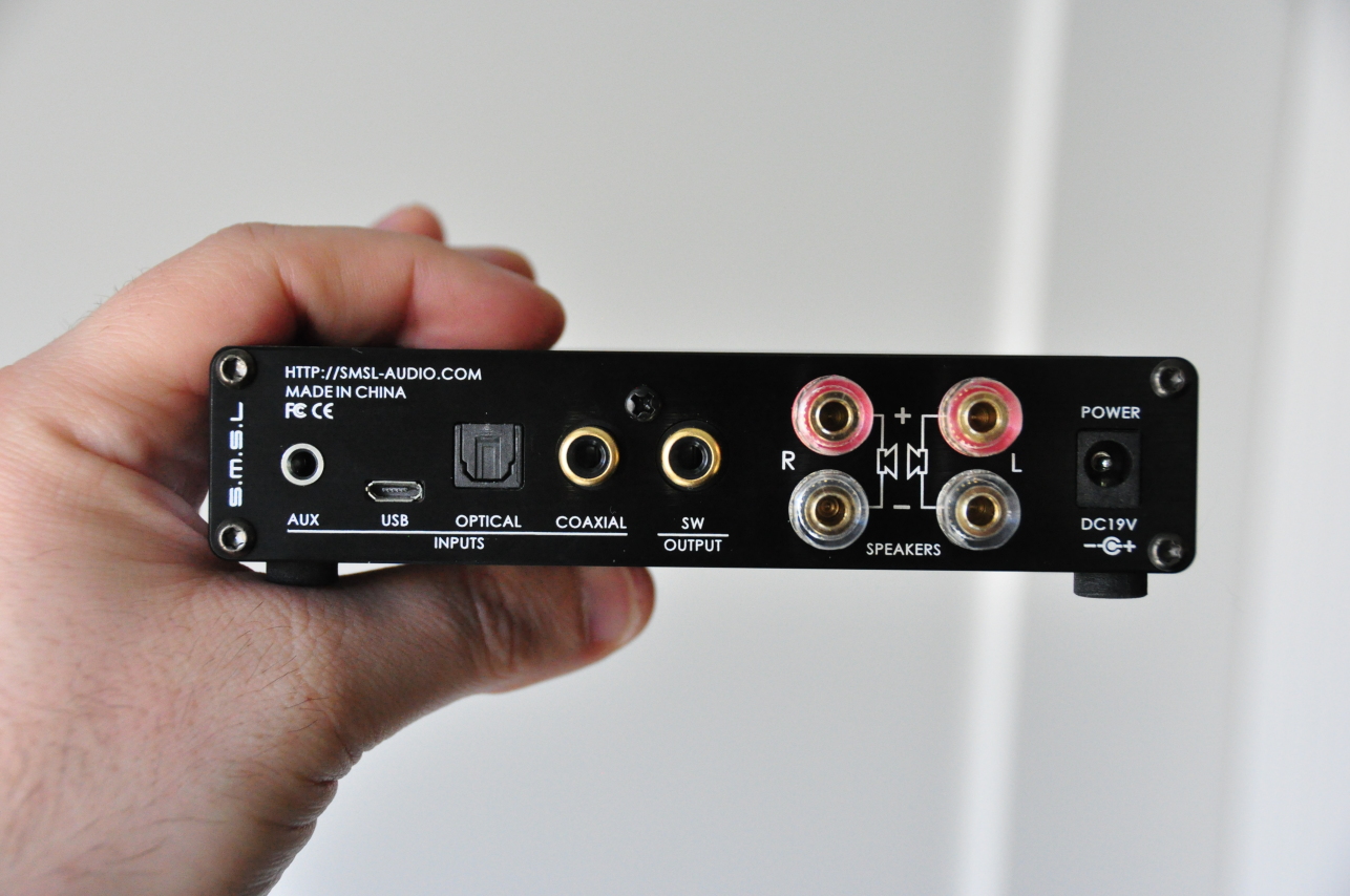

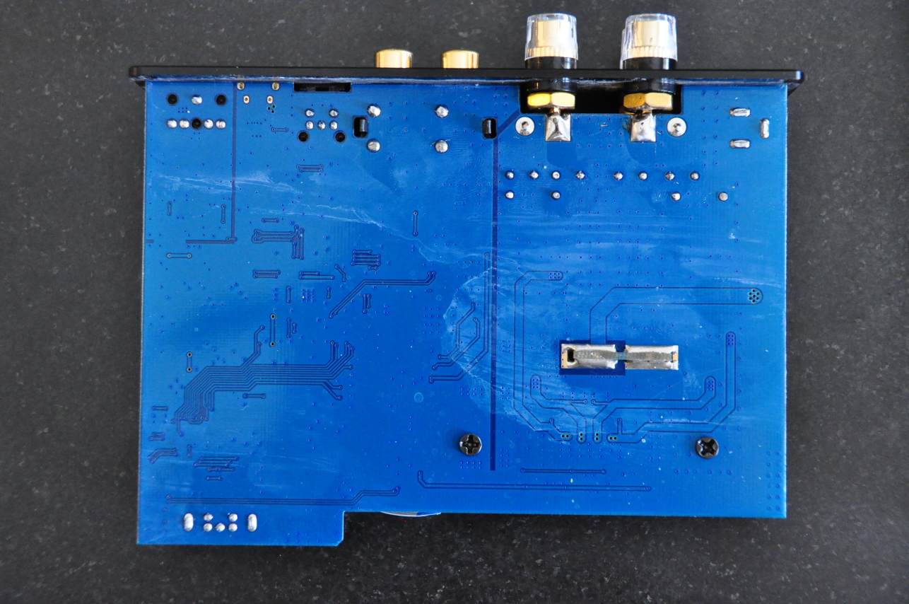

I finally pulled the PCB out of this and looked it over, took some pics.
Looks like they used 78M12, which as far as I can tell, is effectively the same as 78L12, but supports higher current. At least for the ones made by ON Semi, minimum input voltage is 14V, so 13.8 is cutting it too close I think. (But I believe I can adjust the Astron above 13.8, so I might be able to use it yet.) On the other end, it says max is 35V, so I I might be able to experiment with something above 19V... but not too much above that, the big PSU decoupling cap is 25V.
Practical considerations might rule out air core anyway, as you can see from the pics this thing is tiny, and there's not much room for bigger inductors. Definitely no way to get air crores in there if you want to use the stock case. The tiny size of this thing has scared me away from doing any mods other than simple PSU switching.
At any rate, here are some pics. The one of me holding it up is just to give a sense of scale. The remote control is two finger widths' wide, and barely longer than my fingers.

I'd not recommend using this part with 8R or lower speakers connected as its maximum current wouldn't be sufficient. You'd probably need to use two, one for each channel which would involve some PCB mods to separate the rails. I modified my amp to run at higher impedances with an OPT.
Bit late, but I just got one too. It runs fine on 13.8v, however the power is lacking at this voltage. I run it at 24v and it sounds better that way. It does get a bit warmer. The USB input is not the best, I get better results with my LJM CM6331 USB to Coax. Great value amp. I am waiting for an Alientek d8 to compare.
