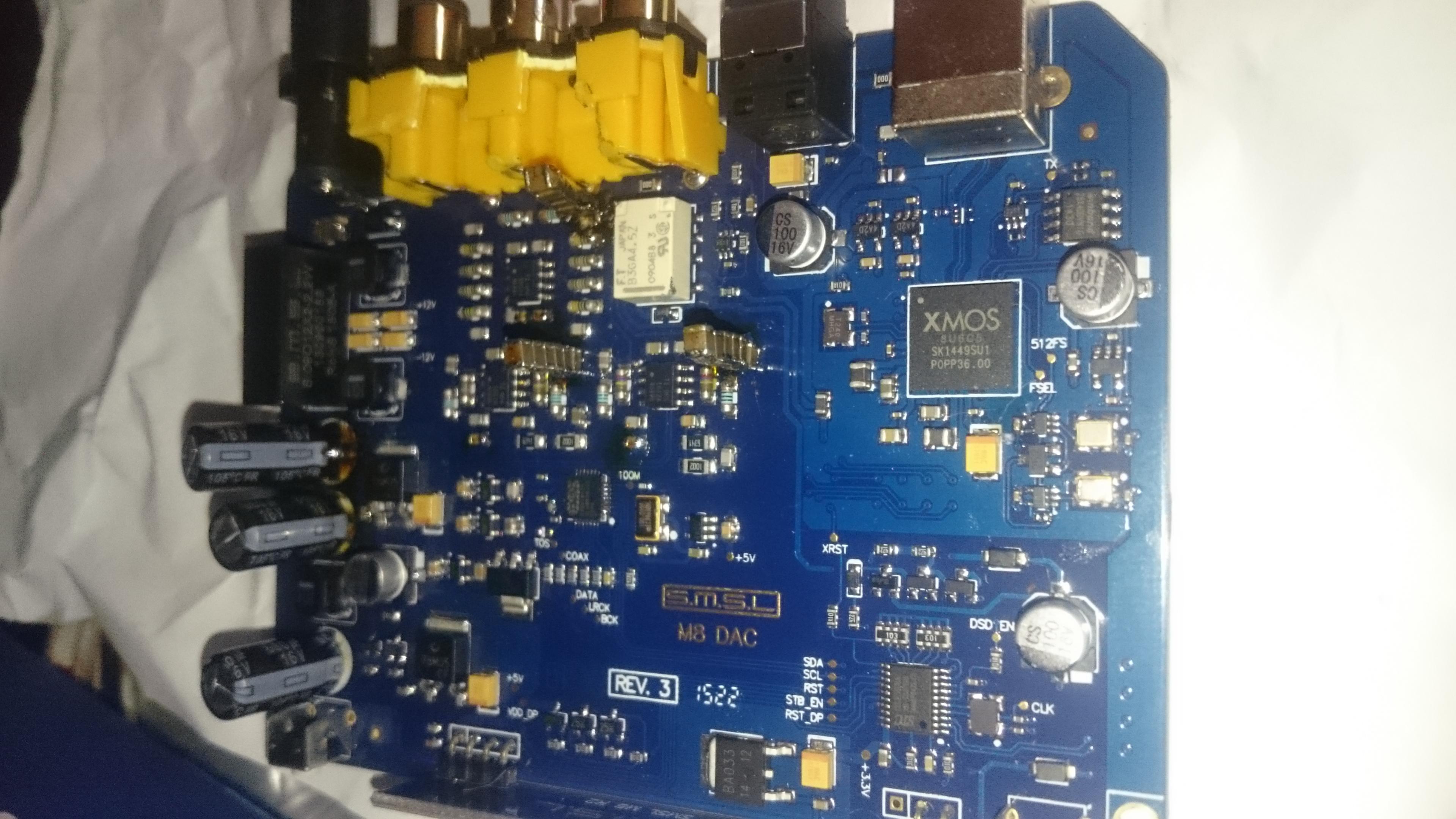

I modded my m8 by way of the caps in the opamp power rails and lower esr on the main caps. Improved the bass, soundstage, and slight bump in the hf, not that it needed it there. This simple mod puts this DAC in out performing DACS over a 1000+
Erik
What are those stacked smd caps near the opamp? The I found that treble bump is more noticeable with the minimum phase digital filter. At the same time the sound is more coherent with this filter than the slow and fast roll off filter.

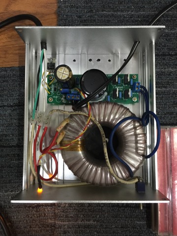

What linear supply are you using?

The PS is a DIY one. I use a huge 70 watt toroidal transformer (12vac). the rectifier bridge uses schottky diodes. The regulator chip is LT3080. One LT3080 is enough for this DAC but you can parallel this reg chip to obtain as much power as you want.
LT3080 is very easy to use. It can replace LM317 with some minor tweak. the LT3080 sounds much better than the common LM317.

The three DC caps on the mains are 16V around 14 mOhm ESR.
The 6 stacked smd ceramics in parallel on the opamp power rails are low esr/low inductance, low leakage .20uF COG/NPO. We know that everytime you add a cap in parallel, the ESR improves by 50% each. With 6 in parallel the ESR is uber low, which I learned modding an class a/b amp, then later another dac, that opamps in general like an uber low ESR supply. Incidentally, the extra capacitance also adds to the overall improvement in the bass registry.
