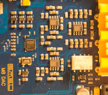

Here are some..
I received it yesterday.
Well, the sound is very good. I had used x-fi elite pro before..(upgraded).
Of course I opened the box, almost all components is SMD. Very nice and carefully made. I think need some time to warm it. In plans, I think to change the external PSU unit and maybe op-amps. Regarding op-amps what they used, no marking on it, so I can't recognize exactly.
One issue is automatic power off after 10 minutes if no input signal. Hopefully they will change that option in the next driver release.

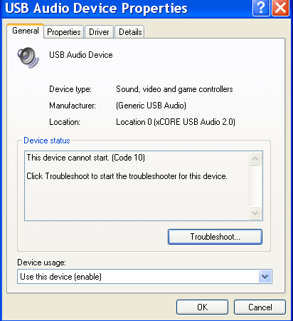

Hello,
I just got a smsl m8 dac. Connected it via usb but my pc will not recognize it in any way, shape or form. No icons and it seems to be listed in the device manager as 'usb audio device' with a code 10 error. I'm running windows xp and I know there have been some problems here. It seems to need a driver but I haven't been able to find any. The included mini cd contains a rar file which appears to do nothing (and I can't open). Would greatly appreciate any help.
TIA
The driver you are looking for is in the .rar package (like a .zip file). You will have to download winzip or something to be able to open/uncompress/expand the .rar file.
Let me know if you are still having issues after you give winzip a try. I have a M8 driver installer I know works with win7/10 on my file server I can give you access to if needed.
Downloaded winzip, opened .rar folder which contained 2 files. One was a .pdf manual, the other a zip driver, which, when I clicked on it, displayed the following dialog box "Setup cannot run on the current operating system". Does this mean I can't use the m8 with windows xp? I've heard there were problems, but that it was possible using the right firmware, though I don't know where you'd find it.

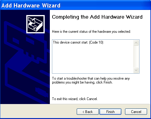

Went to the 'add hardware wizard', ended up with this (fig-1). Clicked the troubleshooter, selected what I think is the device (fig-2) and received this message 'This device cannot start [code 10]' again. Not very encouraging. Maybe the unit is defective, though I hope not, as I could be out a significant amount of $$.

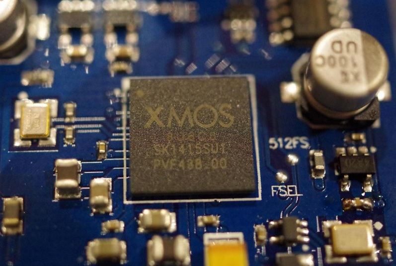

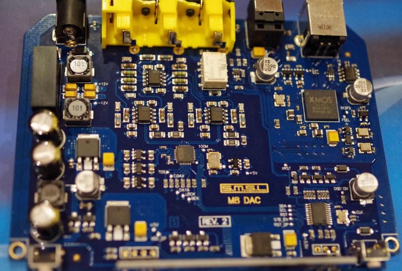

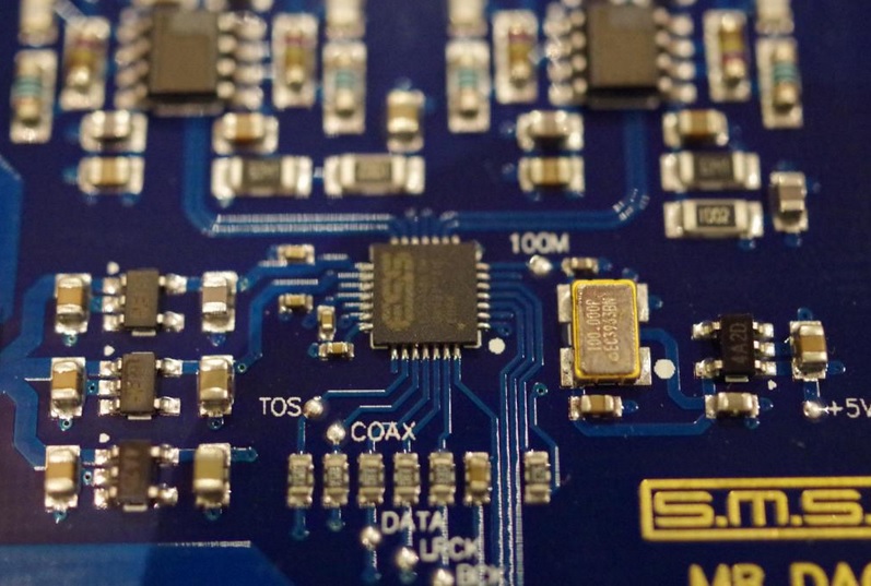

This part seems not right. I have opened and studied the design before. I did not see this part. The Regs for the dac chip look like common ones but I will check again tonight.
My mistake. It does have some special regulator chips for the D/A part.
parts are of high quality and board layout is neat.
