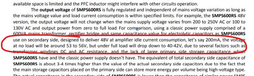

Recently got a new amp board that I'm testing, while hooking up and testing everything, the main power output is reading 69.4v without load! and now I think the amp is dead is this right or do I have a bad PSU? Aux power supply which 12v is reading 11.8v so close, but the main which is suppose to be 48v is puzzling!

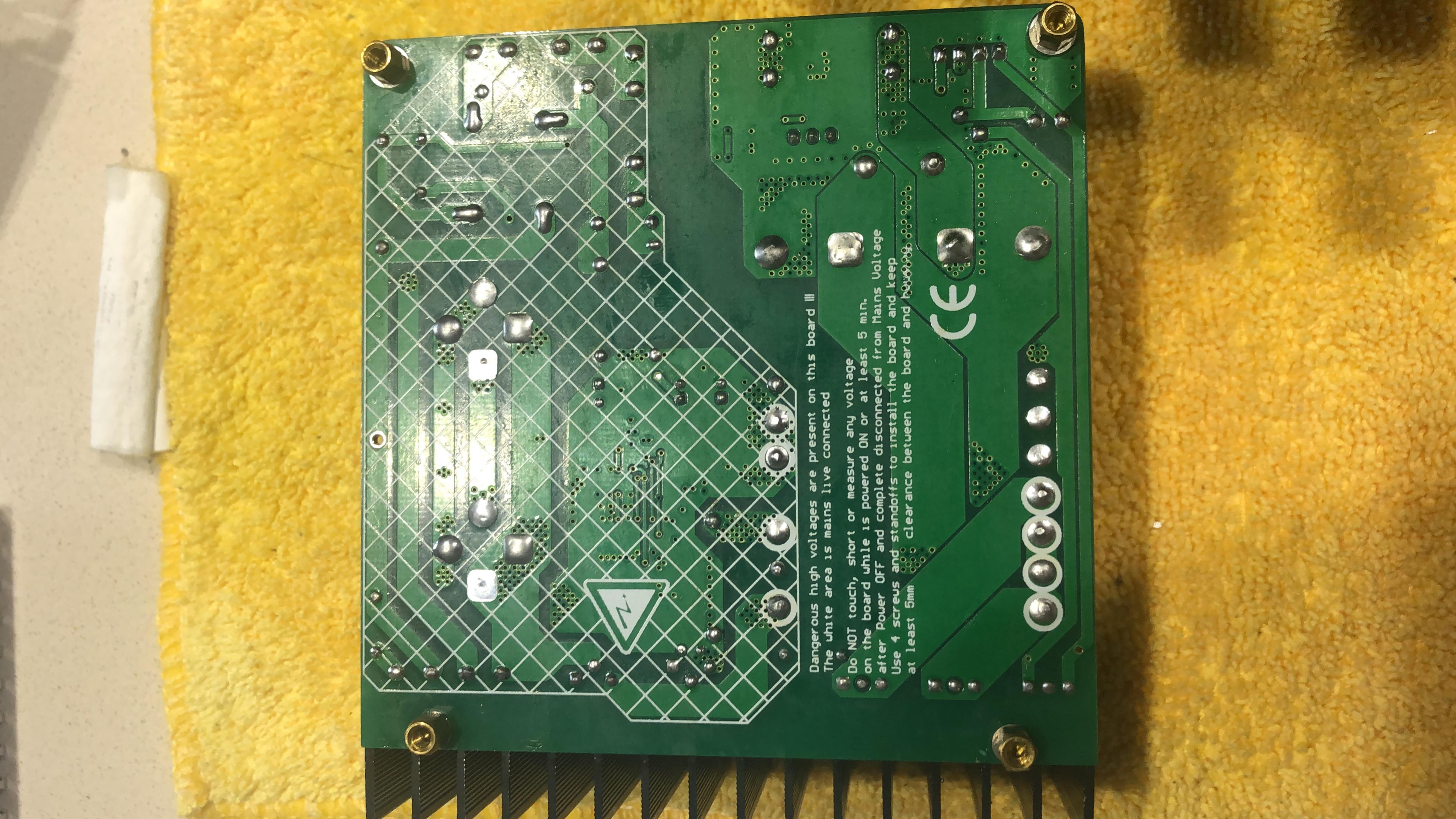

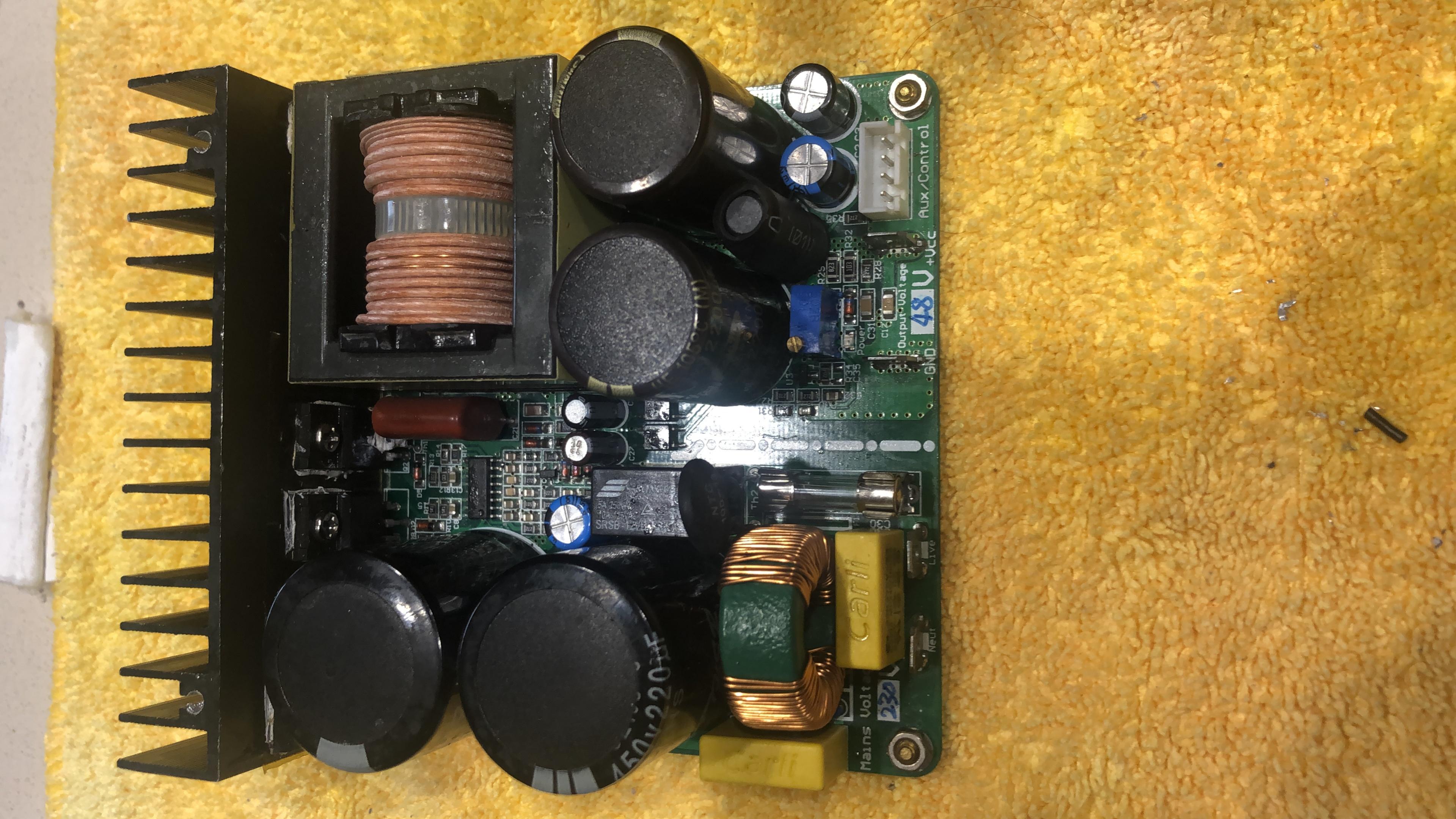

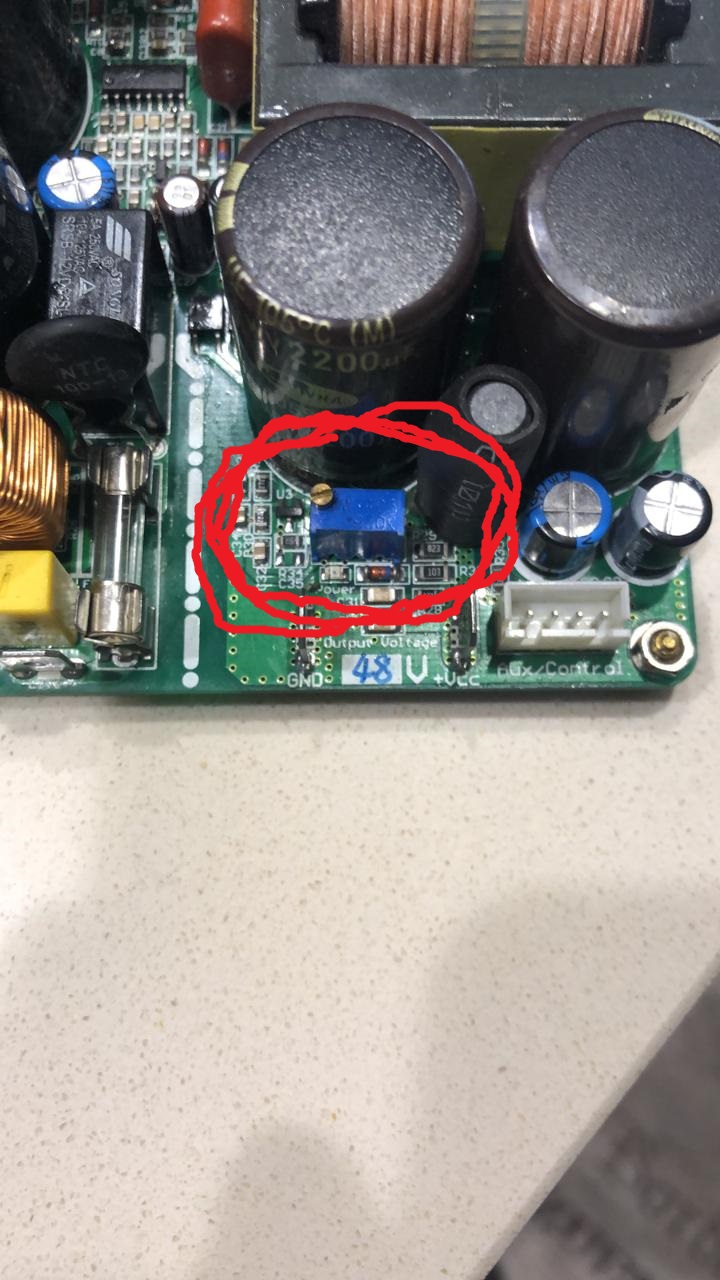

I think the trimmer is the culprit, sharing some pics just in case someone can point out anything that looks wrong in the PSU board
