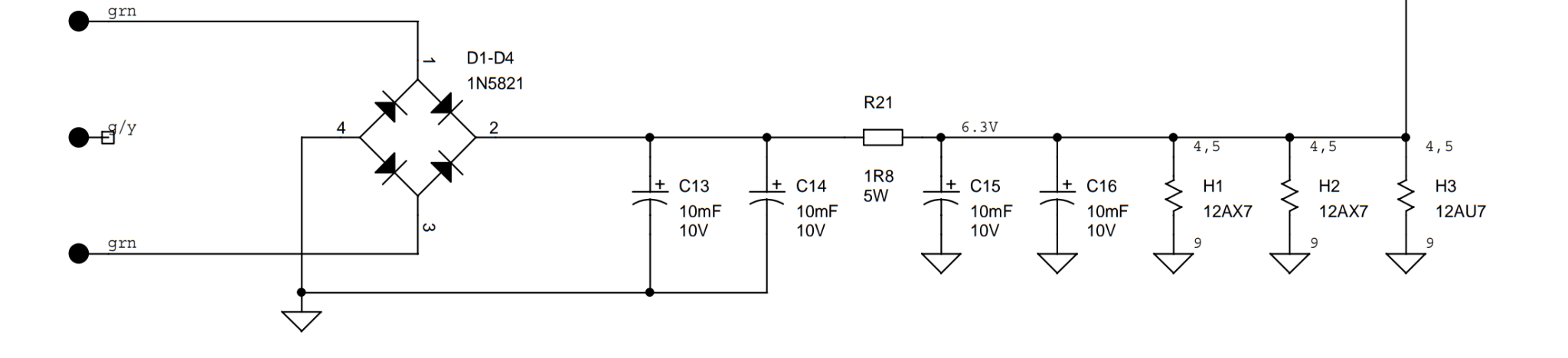

I see. Gets to be cheaper to buy the Hammond transformer. I guess any 12vAC trafo would do, as long as it's quality. Wavebourn recommended DC supplies for all the tubes in that design. I've built linear supplies before... I'm picturing something like this, adjusting the dropping resistor to get happy:
Does the transformer need to be over-rated for this?

The Antek AS0506 Toroidal trafo ships from the U.S. and will provide 2A at 6.3V DC using 0.22 to 0.47Ω in the CRC.
SB1540-3G diodes run cooler, and are recommended.
This is a more reliable solution than offline-> DC boxes. The leakage current needs care with these also, and we are better off without broadband radiated/coupled emissions too, IMHO.

I think your on the edge with this 12V 3A would be what I would suggest. The SMPS you suggest does have main input filter. I not seen one without (except homebrew) as products cannot ship if don't meet EMC specs. They may also need air cooling. Certainly I used one for powering 4x6C33
