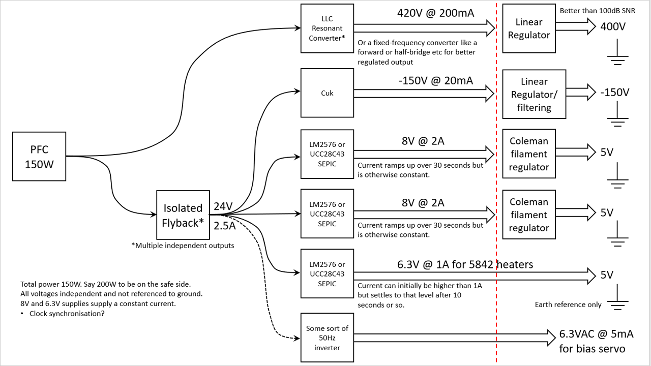

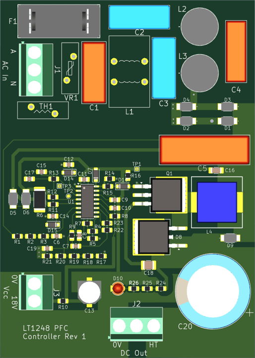

After my bad experience with a cheap resonant half-bridge converter for my stereo 300B amp I'm determined to build my own. I've attached a block diagram of what I have in mind.
The LT1248 PFC PCB is already laid-out and ready to be ordered. I'm currently working on the 24V flyback converter for which I'm hoping to take a shortcut and adjust a vendor evaluation board design.

Am thinking of doing the same for a high power QTL,,,,Allready got two for the filament supplies....16 x 6c33cb...constant current and voltage promised by the modules, it crossed my mind re stacking...will now join in with this....need 170 volts pos and neg at 2 amps....wish me luck
