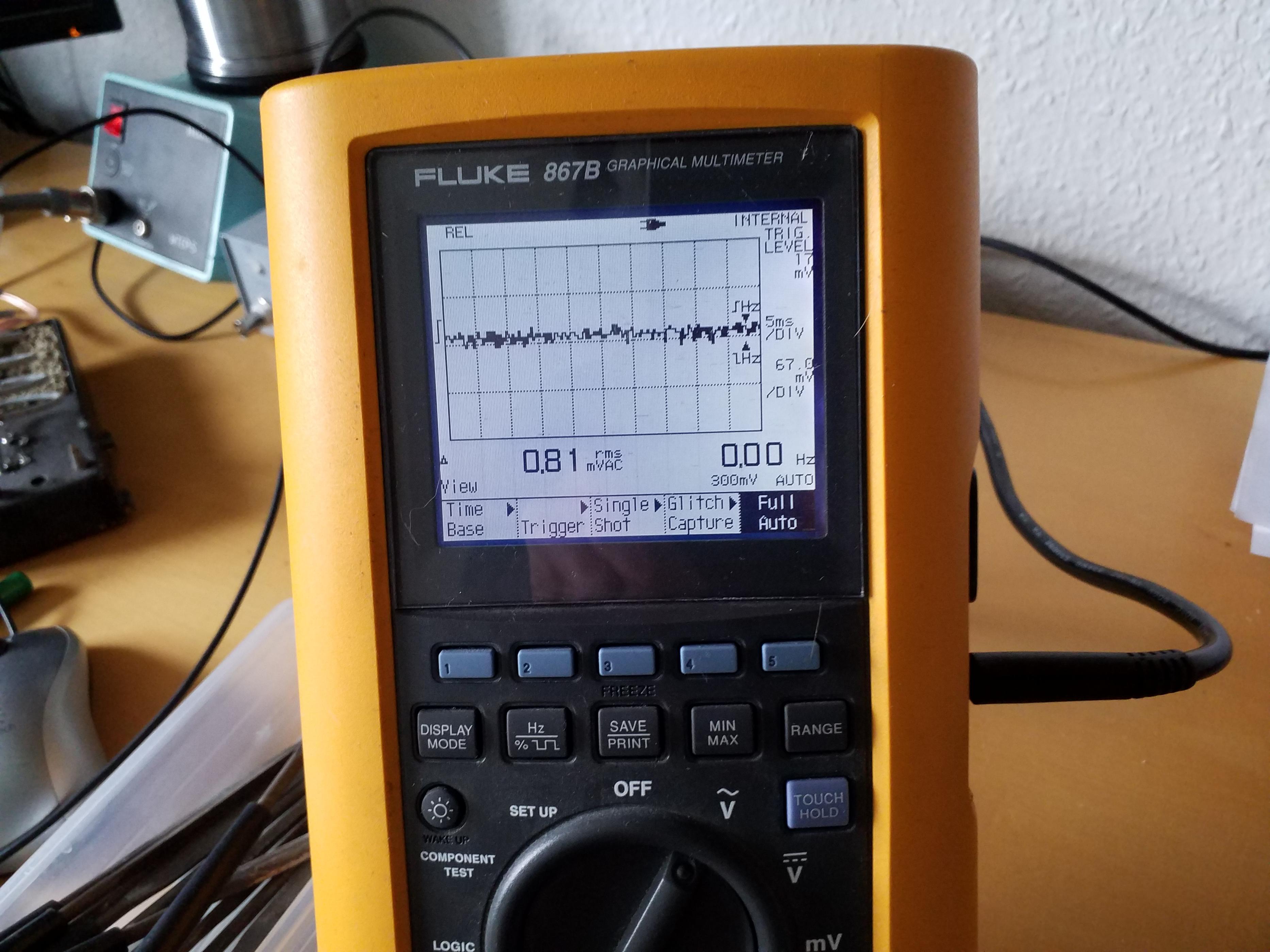

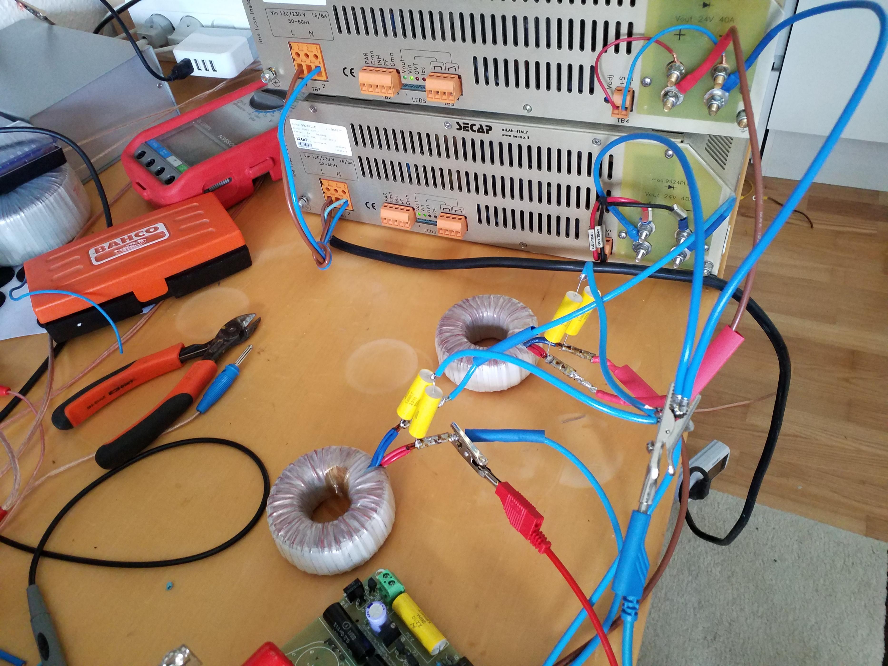

Got curious and had to try 2 smps 24v in series, all outputs fully isolated, I tried hooking them up and got some Mv switching noise, i had some old ulveco inductors high current laying and made a Pi filter low pass roughly 1 khz, now i measure with my fluke only 0.25 mv ripple, and some is probably due to poor ground/shielding, it should work perfect when everything is tidied up and in proper chassis.
I would like to have seen it on a scope, but I sold the old one and haven't found its replacement yet, I could hook it up to my soundcard though.
Anyhow, what's your idea of how low ripple should be to power jlh hiraga flawlessly?
Edit. Mentioned mv ripple is measured with 3 amps current draw

I have modded the two smps a bit today, voltage output was difficult to adjust, it has small holes for a hidden multiturn trimmer, I removed them and added a bourns multiturn pot with knob, voltage can now reach from 20v to 27v.

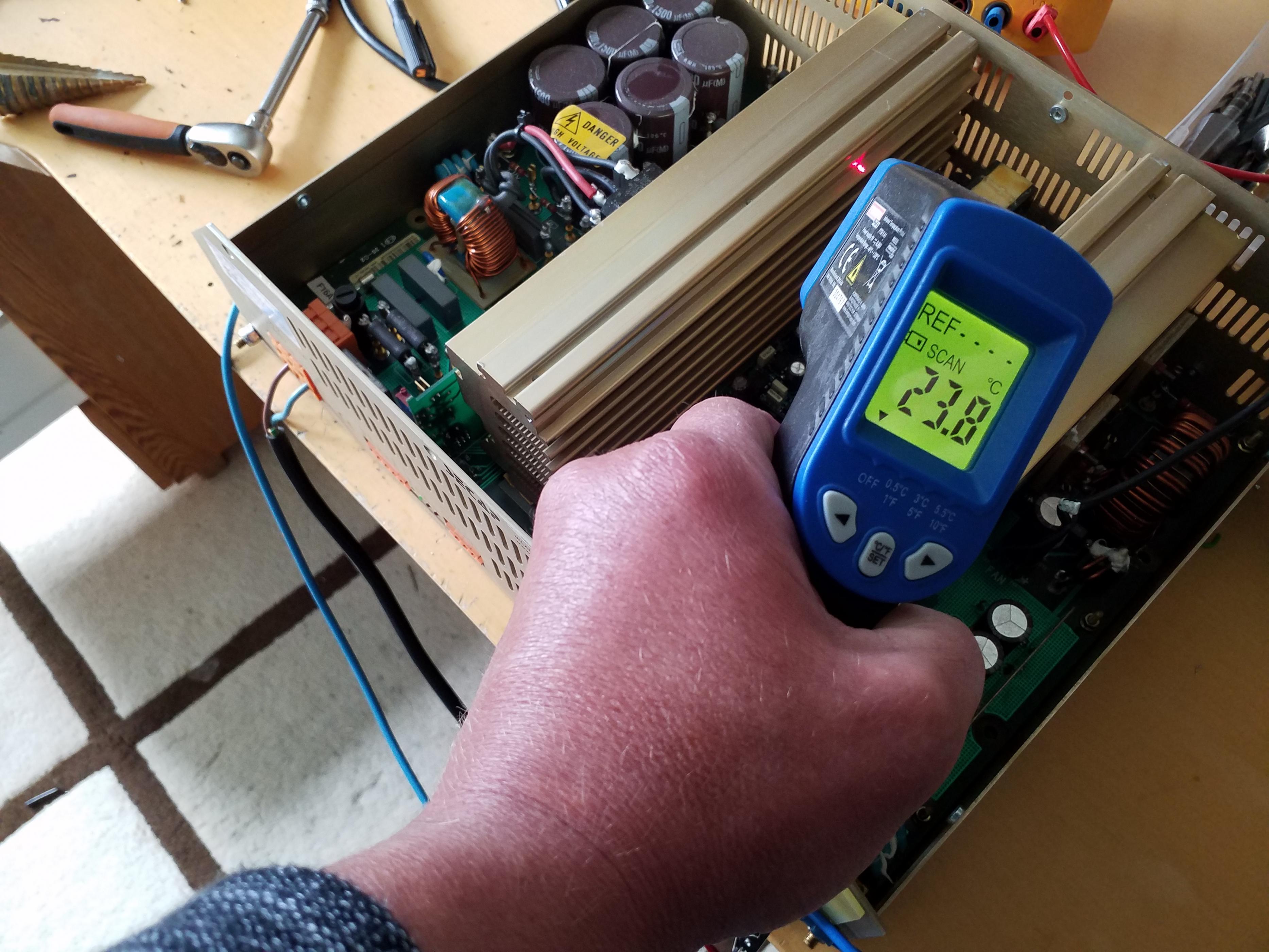

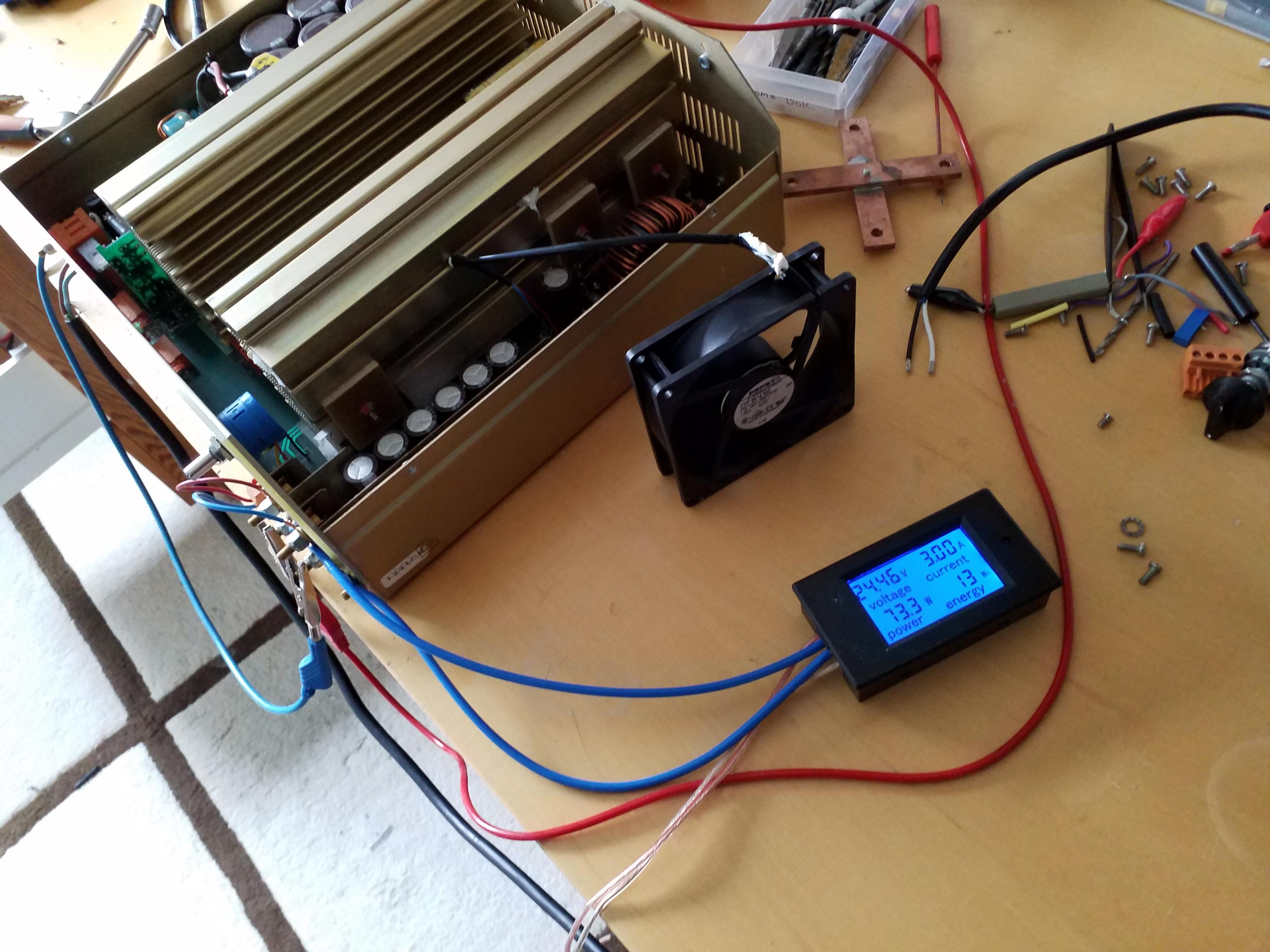

I was a bit frustrated about the forced cooling, very noisy, and permanent, I tried as pictures show to load the one smps with close to realistic class a amplifier load, and fan detached, I used my trusty 8 ohm power load, and let it cook for an hour straight.
Total consumption was 105 watt, and the load took 74 watts, not alot of heat to the smps, after the hour had passed, the left heatsink which was hottest was 5 degrees Celsius above ambient room temperature.
Ripple at that current is quite low, and goes even lower with additional filtering.
I'm not sure I dare running without any fan, but have looked at alternatives for the noisy pabst fan, arctic cooling makes a fitting 92mm fan which has a 20 cm cord with temperature probe attached, at ambient temperature it should run about 500 rpm, and be almost quiet, rpm increases incrementally to temperature, is it worth a try?, or can it simply run fanless ?
