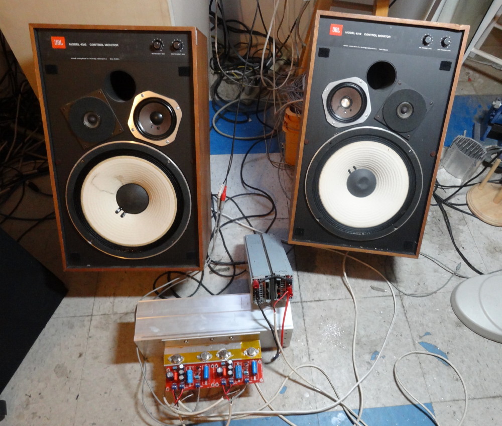

I built a JLH 1969 and used a pair of Server supplies in series for 26V. It worked fine but the sound was less than inspiring and not worth the heat. Interesting experiment though.
I'm thankful for the dented dust cover and the repaired tear in the other woofer. Because of those, these speaker were given to me for free. I repaired the tear and they play perfectly. How many guys do you know who have a set of vintage JBL's that they use for their "test" speakers? 😀 If the amp works on those I move on to my better JBL's.
Blessings, Terry
