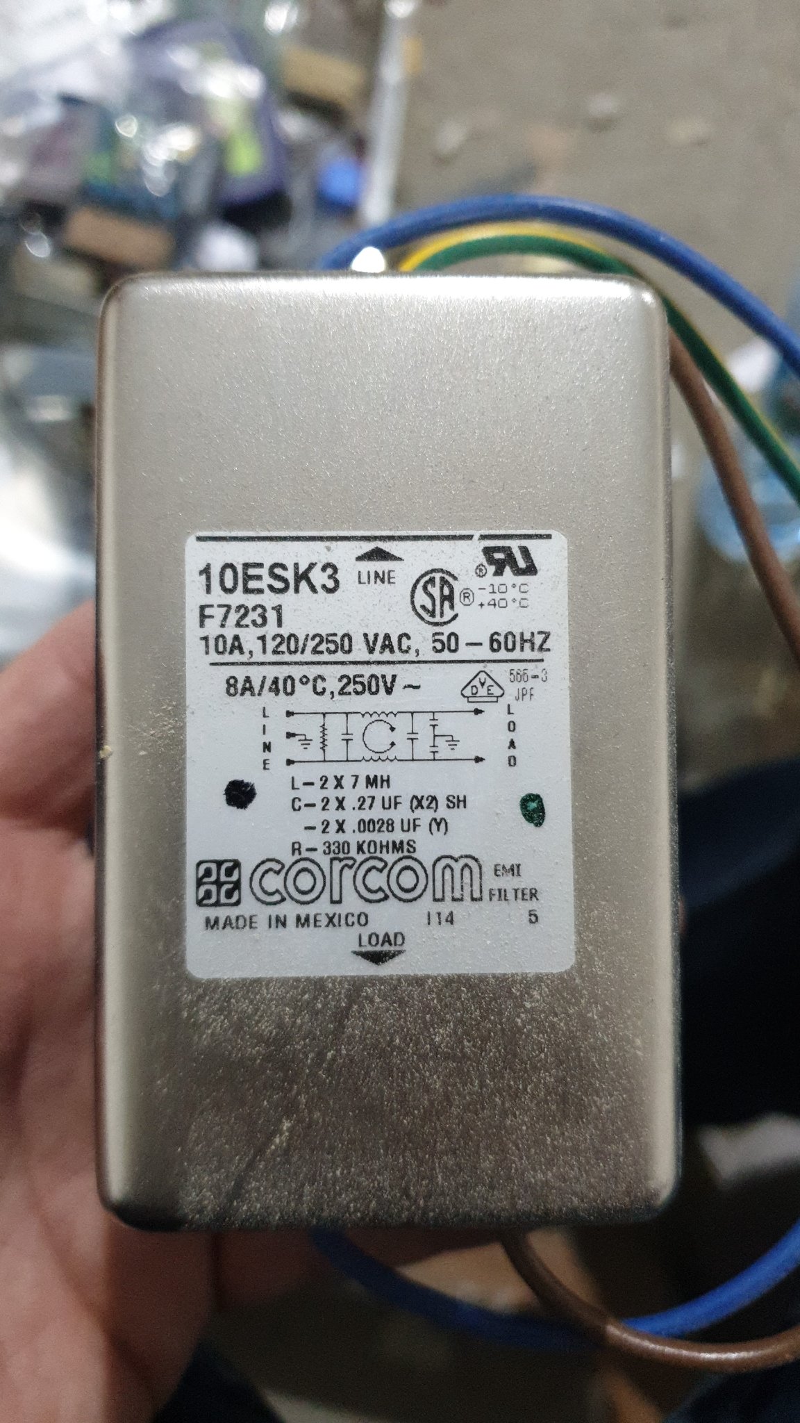

I think i can find common mode filter in my country(importing become very very expensive and restricted in Turkey) and make filters myself.Is it better to use 4 LC dc filters(one filter for every amp) or only one filter is enough for all? I think bias will be 4A totally.

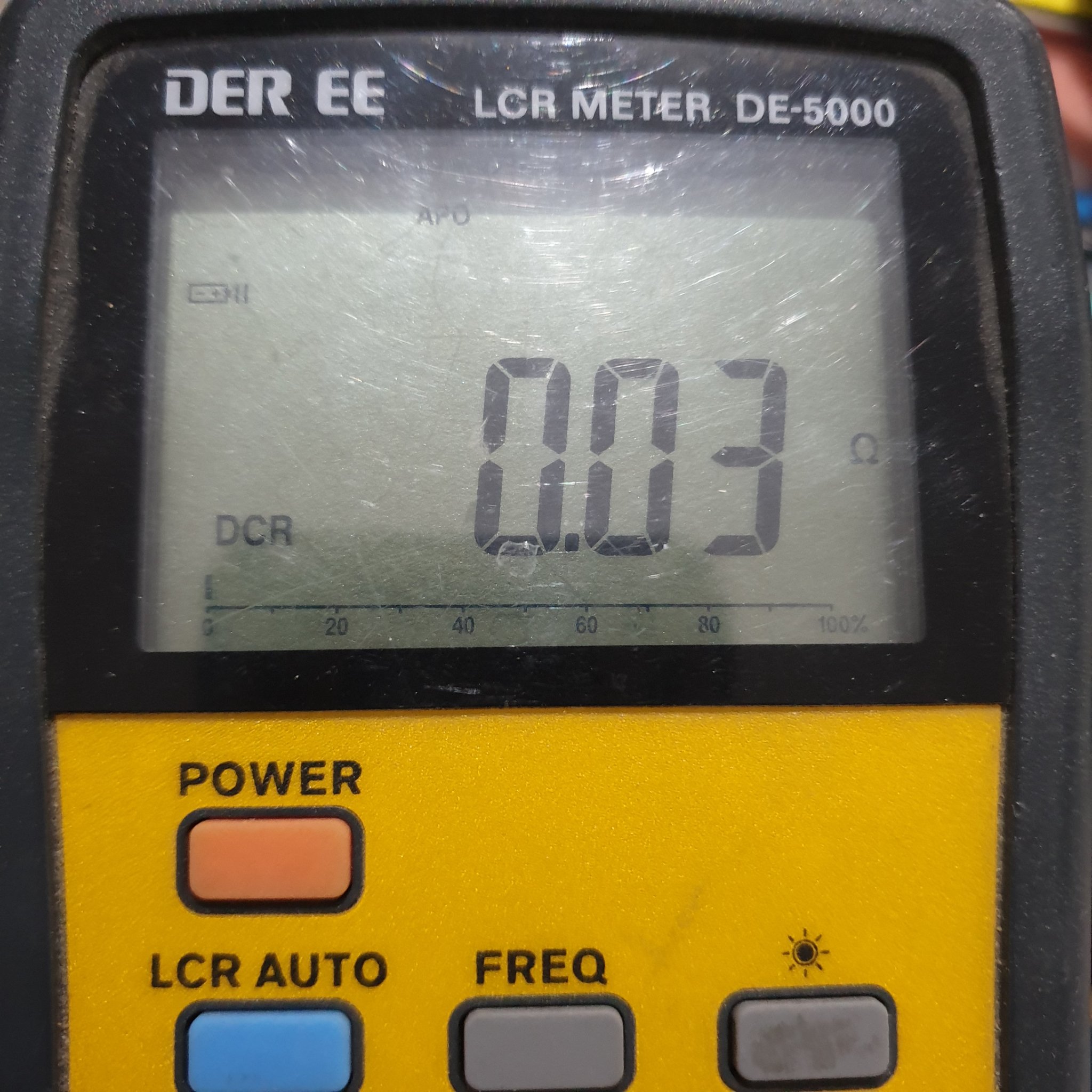

I found this filter in my storehouse. Can I use it after 24v output ? DCR also seems good. Should I connect earth to case? Sorry I do not know much about filtering and and gnd loops a bit complicated for me.

When using SMPS you have to understand common mode noise. You need a common mode choke between the PS and audio ground. You have to filter the ground side as well as the hot. The line side of the PS needs a common mode choke on hot and neutral (not ground) and a safety ground is not optional because it is also a zero-volt reference.
Amy Alice and PO89ZB and amp camp amp filter does not use common mode filter?
