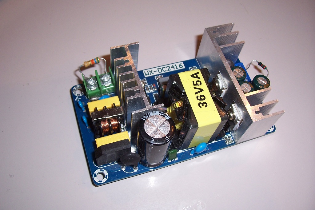

I have had a look at my supply:
attachment.php
I tested it, and it did indeed put out some crap: the FM tuner of my lab was unaffected, but it stands on the upper shelf of my instrument wall, about 2 meter away from my bench top.
Exploring the E-vicinity (without contact) with an oscilloscope probe showed several volts of switching hash 20cm away.
A small portable FM radio was seriously disturbed tens of cm away, and a spectrum analyser centered on the FM band confirmed that the noise level was significantly raised.
Upon examination, I noticed that both heatsinks were isolated but floating. Since the MOS sink is capacitively coupled to its drain, it spat out a huge switching E-field.
This was the most obvious, low-hanging fruit, and I fixed its AC potential, using a Y cap to the - supply input. A direct connection would be possible but the cap has the same result, but is safer in case of accidental contact.

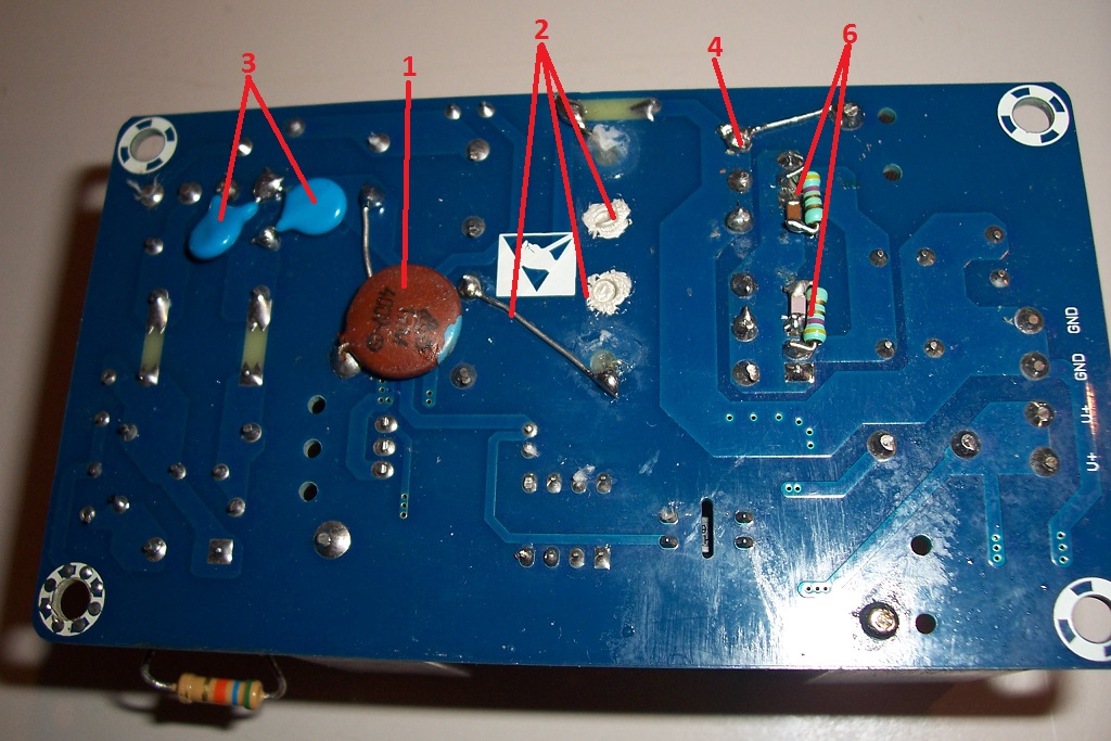

#1 in this pic:
attachment.php
As a result, the LF/MF/HF E-hash was reduced, but some substantial residues were still present. The cause was the transformer. Its ferrite core is floating, and is also coupling switching hash.
As I didn't want to unsolder it, I grounded its core by milling the insulation underneath, and fixed the potential by attaching drain-wires connected with two drops of conductive ink #2.
Now, the E-hash was very substantially reduced. For a good measure, I also bypassed the AC side of the rectifier bridge to the -, with Y caps, to avoid AM modulation of the hash by the mains #3, and I connected the secondary diodes heatsink to the output GND #4.
Results? The E-environment was very clean... but the VHF perturbations and the FM reception were completely unchanged.
Looking more closely, I determined that VHF disturbances came almost exclusively from the secondary side, in particular the rectifying diodes.
They are schottky types, and have individual RC snubbers, but they nevertheless generated significant amounts of VHF noise.
The problem is that the snubbers address the ringing issues, but probably aggravate the VHF emissions: they are loaded with a resistive 47R, which do not mitigate the singular discontinuity caused by the rectification.
The diodes are quasi-perfect, do not "stick" due to the Trr, but even ideal diodes working on an ideal sinewave act as frequency multipliers because of the waveform discontinuity.
The leakage inductance of the transformer could have mitigated the issue by softening the transition, but the resistive load presented by the snubbers prevented it. The 47R is high enough to allow VHF to escape.

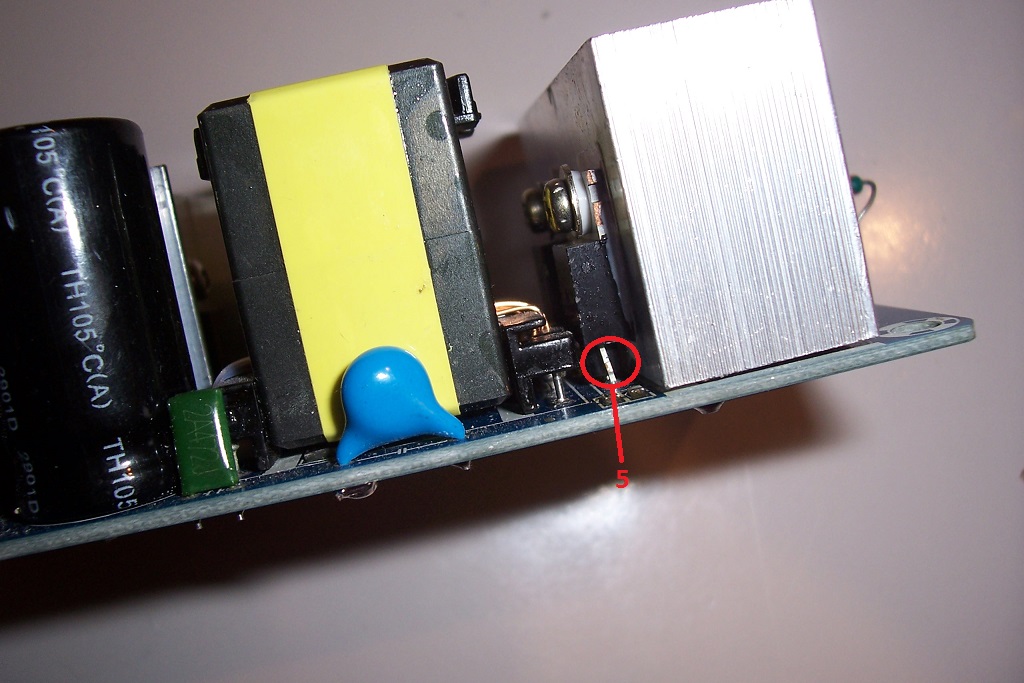

The first thing I did was to reintroduce some inductance, in the form of ferrite beads (~0.25µH) threaded on the center leg of each diode: #5 in this Pic:
attachment.php
The result was spectacular: a ~80% reduction of the problems
The next step was to shunt the diodes, to confine the emission to a very small loop.
I added much more aggressive snubbers (4.7R/4.7nF): #6
This appeared to practically solve the problem: noise was still visible on the SA, but the radio worked undisturbed with its antenna nearly touching the supply.
The solution is not perfect (a redesign of the supply would be necessary), but it works, with some caveats: the snubber should be optimized to disipate less (the resistors become seriously hot) and probably ring less: with these values, a severe but relatively low frequency ringing is present.
It is probably possible to adopt less extreme values, and to add another RC to damp the secondary, but the effect is going to be mostly cosmetic, like the original: what is really important is in fact not visible

It is clearly under-dimensioned. I tested it at 5A, but I don't think it would last for very long under such conditions: most of the parts became uncomfortably hot.
It would be suitable for a class AB amplifier drawing 5A for a full power sinewave output, but not for a class A amplifier (unless some derating is applied)
I assume this is a flyback converter. 180W with a flyback of that size? Never! Flybacks are the simplest and cheapest suitable for small power applications. Increasing power shows their limitations: Very high ripple current in secondary rectifiers and caps, poor utilisation of ferrite core, high component stress, mediocre efficiency and lots of noise and spikes.
For power above 100W there are much better choices like LLC, for instance.

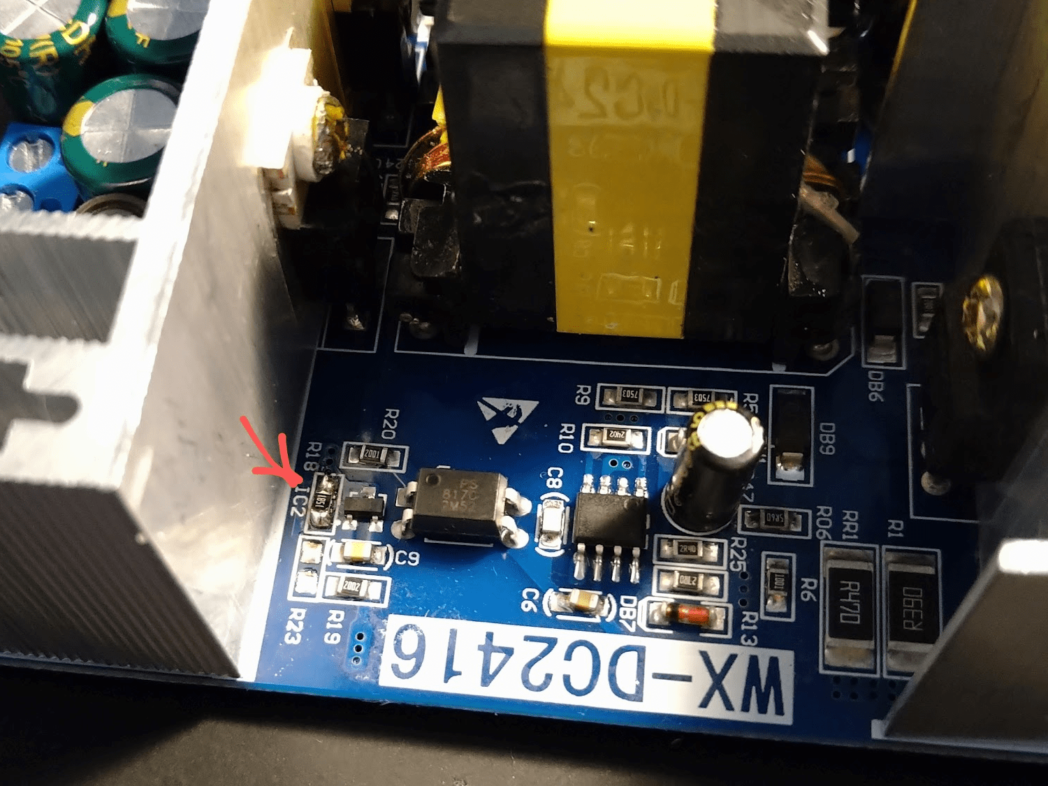

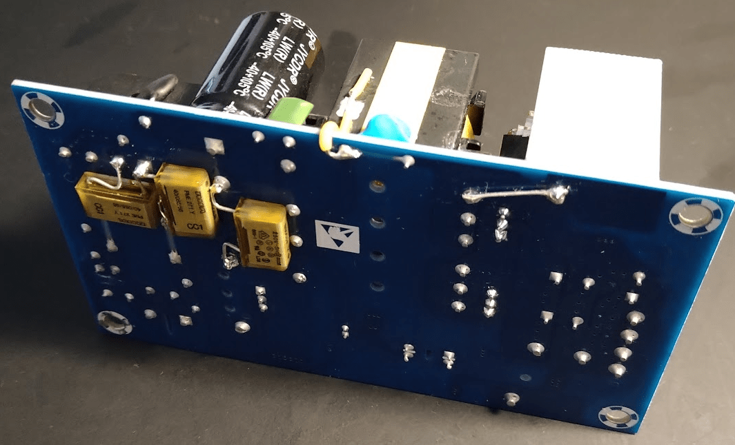

Thanks Elvee. I have the same SMPS and made the modifications that you suggested. I didn't change the snubbers for the diodes, they seem to have lower values in my variant (5.6 Ω, maybe an improved version?).
The transformer ferrite core I scratched lightly, glued a wire to it and applied conductive paint to the bare wire.
To change the output voltage, resistor R18 (1500 ohm) can be changed (shown with red arrow in second picture). I used a 1580 ohm resistor and now the output voltage is around 33.8 V (I wanted it to be below 35V). To get a lower output voltage, use higher value resistor. You can also calculate the desired output voltage from the resistor divider R18 and R20 (20 kΩ) and the reference voltage, which seems to be 2.7 V. So e.g. for 24 V output, R18 should be 2.32 kΩ.
