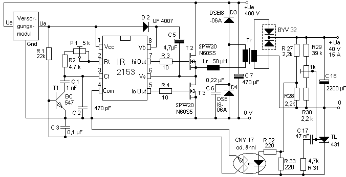

certainly is not easy to develop effective protection for the 21531.
But since they wanted to use the 2151.
TL494 is good, Also you can add a driver eg. IR21xx or a transformer to drive the mosfet.
however I've solved the problem at the start of 21531. in the presence of a short circuit or high absorption. I enclose a pic just for curiosity. worked from 2002 until 2007 without problem in class H amps.
I think it works better, less RFI / EMI of some unregulated on the market.
somewhere in this forum I already put the diagram.

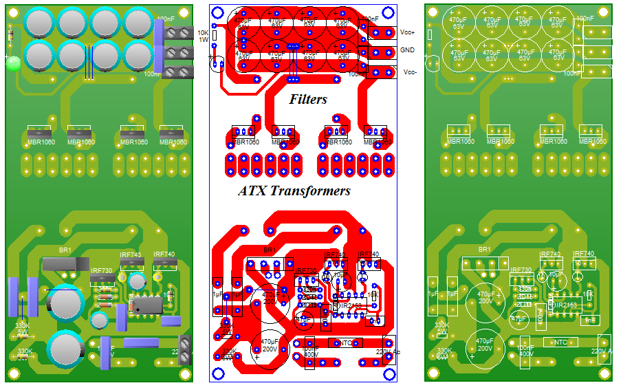

There dosn't seem to be any creepage and clearance between the high voltage input and the low voltage stuff!
??..you mean ac-dc iso? (yes, have 1cm with in side 5mm air gap) this is a ISO line of separation ac-high voltage to dc output.
or you mean dc output to dc low voltage? also this have clearance.
I was looking at the PCB picture on page 1, I couldn't see no obvious space between the high voltage area and the rest.
My photo is at page 2 "IR21531D", blue pcb.

The layout on page 1 post 1, I would say does not conform to required creepage and clearance distance, wich with the voltages present and working to worse cass class 111 polution should be 4mm clearance and 8mm creepage, or 4mm with a 1mm or wider slot in the PCB to ensure an 8mm creepage distance.

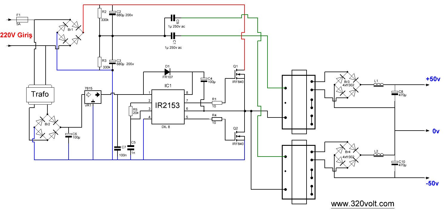

Ok this is main schematic and new layout of PCB. Do anyone have idea for shorst cutcuit protection without curent transformer or curent sens on primary side. Even maybe is better schematic or sugestion with other ic (TL494 on exapmle) but with ATX transforemers in serial for +-50V.
I dont know indutance of that transformer or ratio but on primary side it has 30 turns and on secondary it has 2x7 turns with central GND for 2x12V but in serial its almost 25V. Core is EI 33 without gap
Can one TL494 and one pair of mosfet "push" two of these?
now pcb is better but not perfect, some layers need modify.
your trafo (pr=30:sec=7) with ir2153 circuit, produces 36,9V per side @ 230 Vac. also, requires low frequency of switch, around 40Khz max.
