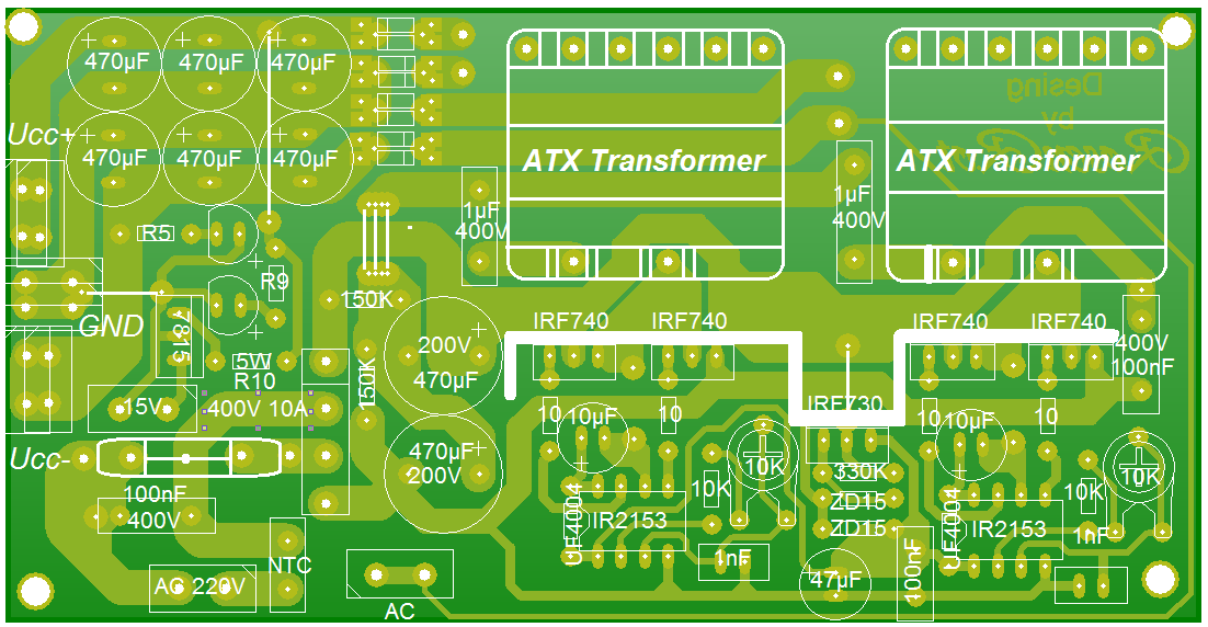

Hi to all. I draw this schematic and PCB layout for SMPS with IR2153 and ATX transformers P4
I take apart many ATX trans. and all are the same, only different is wire ticknes and size of ferrite core. Number of turns are the same.
I want to use 12V rails (without GND- that is 14turns) from trnasformer to get +-50VDC or more, changing the freq of IR2153. I use two pairs of IR2153 and Mosfet drivers IRF740 for two ATX trans, two bridges on secondary side.
For +15V to power IR2153, I use IRF730 with 330K and ZD15V on gate and ZD15 with 100uF and 100nF on sors.
Output bridges are 4xMBR10100 ich.
This is the best assumption that I had.
What do you think about this?
(One think more, on schematic, on primary side +marks are mistakes)

You can use a single IR2153+MOS-FET's pair, even with 2 transformers. both primaries can be connected in parallel and secondaries in series with correct polarity to get +-50V or more. with a standard ATX smps transformer you can get about +-25V under heavy load and up to +-33V with no load. connect 2 of them in series to get almost double. use just 4 shotky diodes for rectification, and don't forget to add a ovecurrent protection scheme, otherwise all will blow up at short-circuit, or even at start-up due to the capacitors large inrush current.
further improvement which can be done, to increase the efficiency, if you could dismantle the transformer core and add a 0.3mm gap to decrease the magnetizing inductance to about 500-700uH and use a 0.22 uF series capacitor, then the transistors can work in zvs mode and they don't even need heatsink for up to 200-300W. the Rf resistor should be 10k only and Cf=1nf. you will have about 70Khz. the transformer will also run cooler due to lower flux and will get hot when the current draw will be high only, but for audio application, this is not a major concern, the peak-average ratio is high enough to not create significant temperature build-up.

For a MOSFET dissipation is primary RMS current over RDS(on). Since there are two switches in a half bridge, you divide the value you got by two to get dissipation in each MOSFET. But, MOSFET RDS(on) is temperature dependent, so you should follow the datasheet graphs to find on resistance at the expected operating temperature. Btw, you have three major wrongs in your schematic.
1. The whole point of half/full bridge is full wave rectification, so why are you hooking up only half the transformer secondary? And you only need two diodes (or one double diode) per output. That's why you have a center tapped transformer.
2. No output inductor. High ripple and premature failure of the capacitors will be the result. Rod Elliot may be a good audio engineer but he certainly has no clue about switching power supplies.
3. No provision for regulation. Not only does the lack of regulation make a huge difference between idle and load voltages (SMPS transformers by themselves regulate a lot poorer than mains transformers), but it also forces you to use very large primary capacitors because all the mains frequency ripple will get thru.
For protection, you have that shutdown pin. How to use it is your business. As far as i can see the IR2153 does NOT support regulation. I'd just use a TL494 if i were you.

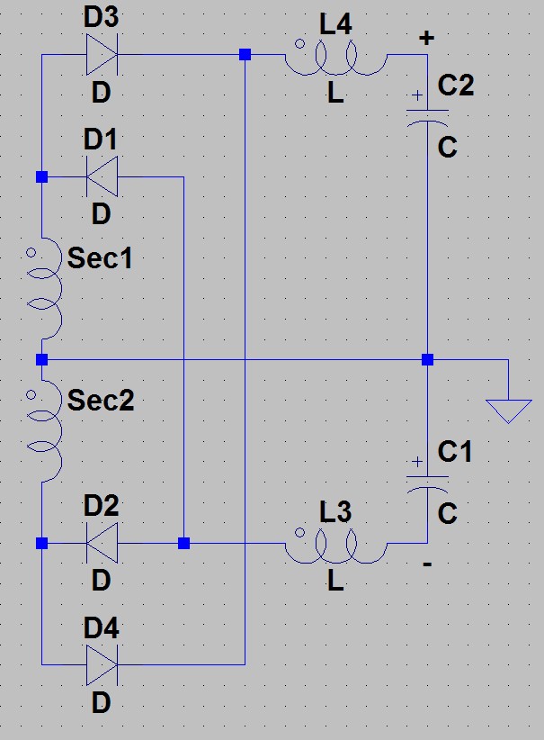

Here's one trick that will help you on your quest. Hook both transformer secondaries in parallel. Center tap and everything. Now, both rails will track each other perfectly.
But how to get positive/negative voltage with both windings in parallel you may ask? It might not be immediately obvious but check the attachment. The downside is that you're going to need diodes wired "the other way round" (common anode) for the negative rail. So, you'll have to use your double diodes as single ones. But i'm sure you have enough of them.
