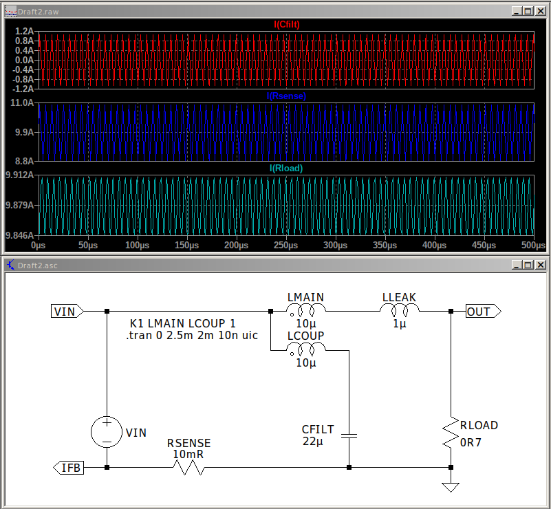

My head is stuck in ETD and EFD ferrite cores. You seem to have arrived at the right ideas. My assumption of an output voltage requirement was misplaced.
If you want to go mad or otherwise be evil then...
http://www.audiodesignguide.com/ClassD/azrtatad.pdf
https://www.ti.com/lit/ml/slup105/slup105.pdf
Coupled inductors again. The method proposed by Dixon gets in the order of 10% leakage inductance.
You design the inductor as per the previous for Lmain then Lcoup is wound close to the core. Lmain is wound on top with the spacing between the windings. Lcoup carries the, low, ripple current no DC. Lmain carries the high current DC. Lcoup thin wire for 1A AC. Lmain thick for 10A DC. You more or less don't care about skin/layer effect.
Don't worry too much about Dixon's inductor being 2mH and yours being 11uH. It's the winding geometry that sets the leakage ratio.
CFILT is sort of chosen to such that the resonant impedance SQRT(LLEAK/CFILT) is close to that of your load impedance. Otherwise you have to insert some damping into the circuit. The bigger CFILT is the smaller the output ripple.
You use Current Mode Control with feedback from RSNS referenced to ground to control output current. It is located outside of and therefore not affected by the resonance but does measure the total load current.
It's almost one of those things where you just build it then measure how it behaves and bodge on the right values later.
As shown output ripple current is 63mA peak to peak. 0.3%

using gapped ferrite as inductor is complicated.because DC bias characteristic VS permability is unknown and calculating real inductance under load is very difficult.so i think using powder cores like MPP or SENDUST or ... is better idea.(my experience)My head is stuck in ETD and EFD ferrite cores. You seem to have arrived at the right ideas. My assumption of an output voltage requirement was misplaced.

coupled inductor design is useful when lowest ripple current is our goal, is that right?so when we don,t need that very low ripple current using simple inductor is enough.
another question: can we using dual phase(interleave) buck converter as alternative way instead coupled inductor technique?
That's not strictly the case. The characteristics of a gapped inductor are largely determined by the gap. The problem is getting the right size gap in standard halves. In powder and similar cores the gap is intrinsic so you have to by from the available range of permeabilities. It's kind of the same difference but you are more likely to find a manufacturer producing a wide range of permeabilities.
Coupled inductor design is a bit niche. That probably should be taken as meaning I don't know enough about it or have otherwise been disappointed in my ability to implement it satisfactorily . Most times I would have to add extra circuit damping wasting more power than I would like. Things get horrible if you find one of the resonances internal to a loop that you wish to regulate.
Interleaving does give ripple current cancellation but only for certain duty cycles dependent on the number of phases so 50% for two phases or 25%, 50%, 75% for four phases. The input/output voltage ratios have to be well defined.
take a look at this curves.
a little change in current causes a huge change in H.but in powder core it's not.
another graph shows 2-phase interleave has less current ripple than 1-phase at any duty cycle specially at 50% duty
Sorry. Point, kind of, taken. Yes for pure ferrite the transition is sharp. You design so you do not hit it. Soft materials are... soft.
In respect of your ripple current graph it is given for a boost convertor. I was referring to your buck convertor.
As your picture suggests in a boost convertor the output current is discontinuous so, although inductor ripple current contributes to output ripple current it is not overly significant.
