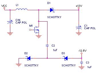

Are you doing a step up converter?
If so, see tha attached drawing. Adding C2, C3, D2 and D3 to a standard boost converter creates a negative output. While this output is not regulated, it is relatively predictable. If the positive and negative currents are the same, this also counteracts some of the errors.
Alternatively, the Maxim MAX629 can be used. Use one for the step up, and one for the inverter. See the datasheet.
For your applications, set SMPS to 14.5 or so. I checked the LM79L12 datasheets, it has a typical dropout of 1.6V with a 40mA load current. Use an LM78L12 for the positive.

not what I would call a low-noise circuit -- btw, some folks have used RS232 converter chips (max232) to derive +/- 18 V -- but noisy!!

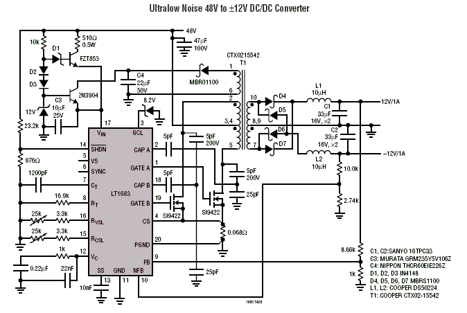

here's an example of a low noise bipolar supply:
