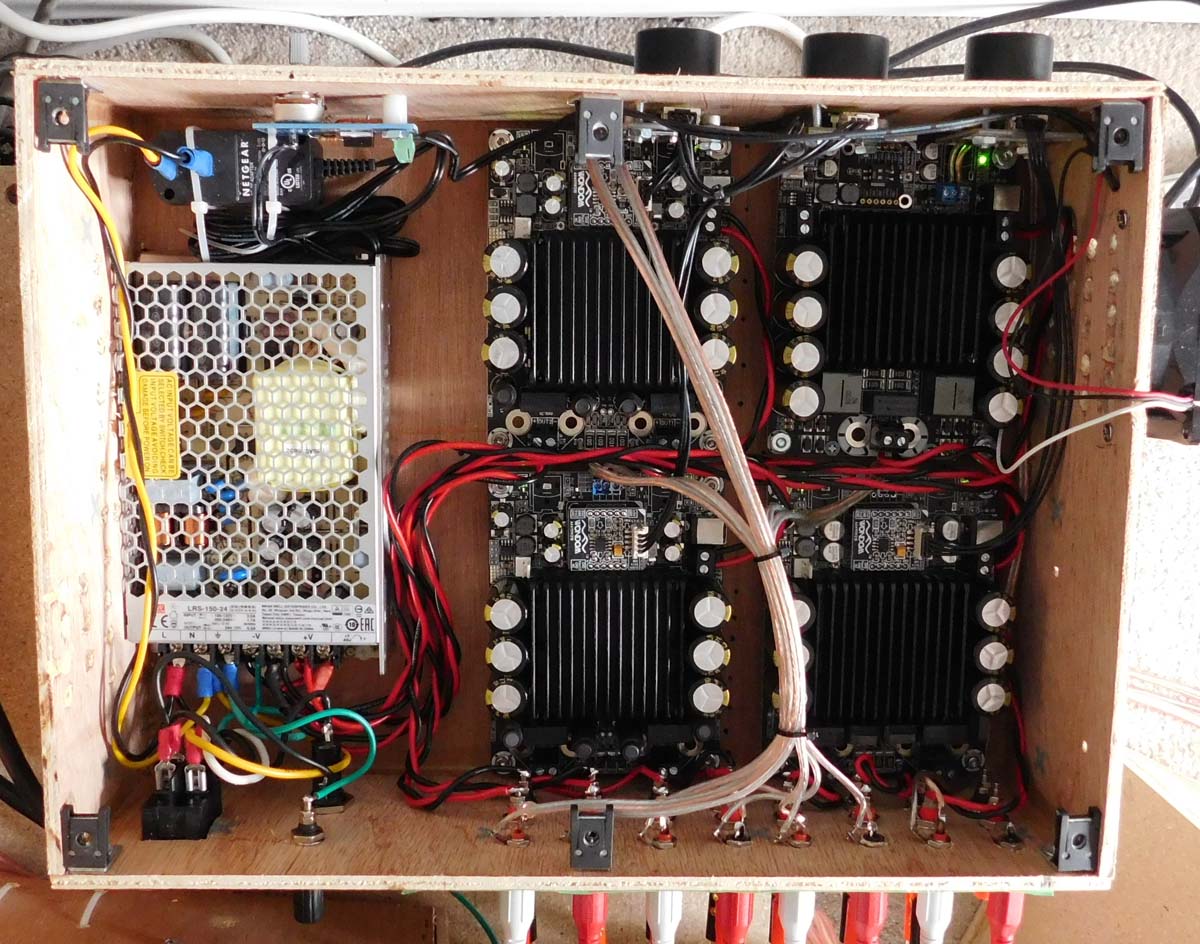

Sure you can, and I do something very similar (see pic). I don't need much power either, so I have an undersized power supply as well. I have had noise problems due to poor grounding and ground loops but those are separate issues from the Amp/PS.

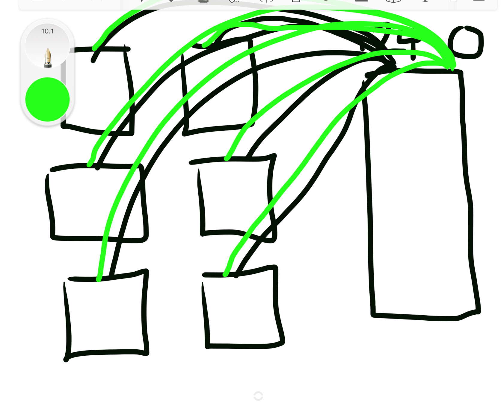

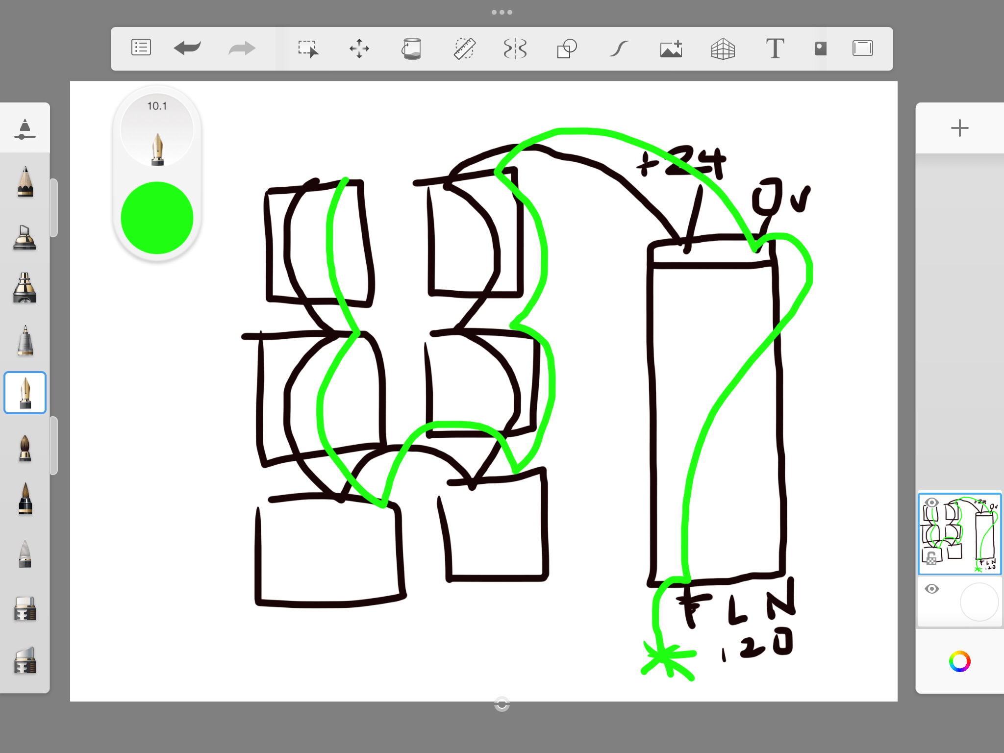

Thanks for the replies. To make for cleaner wiring I ran power to each amp in a daisy chain, with the thinking that each of the 6 + and - amp nodes “see” the respective 24v and 0v PS outputs. See attached. Would it be better to star groun as in the second attachment? Besides the possibility of a slight voltage drop at peaks, what other issues does the chain introduce? And thanks again for the help.
Using the star arrangement (pic#2) ensures equal V+ current and V- return current in each wire segment to each amp. The equal V+, V- currents create equal B-fields that mostly cancel each other (less radiation). Using a wire pair, or twisting the pair ensures minimal loop area so it radiates less and is less susceptible to interference (radiation reciprocal). A grounded shield on the power pair would be even better, but I did not require it,
The daisy chain has incrementally more current in each segment (closer to supply) and it will not be balanced (equal current in V+, V- of each segment). There may also be some common mode modulation from the wire impedance that may appear as supply variation at the amp supply terminals. This is not a DC resistance V drop, it is AC modulation from wire impedance. The T amps switching freq varies between 100Khz - 1Mhz and it's load dependent.

Hi Don, I will re-wire using the star arrangement. It sounds like this is a no-brainer as it addresses several potential and actual problems at once. (Just doesn't look as tidy.) I made shorting plugs for each amp input. Same result, as soon as a second source is added, that shares a common ground, using any pair of the amps, I get this noise, (most audibly 640 Hz.) So I connected instead, 2 separate input sources, (iPod and cell phone) neither connected to ground, and the noise is gone, both channels sound fine. This repeats with any combination of amps.
I will report back after re-wiring, but I will eventually need to have all inputs referenced to ground as they will all be going to a DXO. Thanks for the help and talk soon.

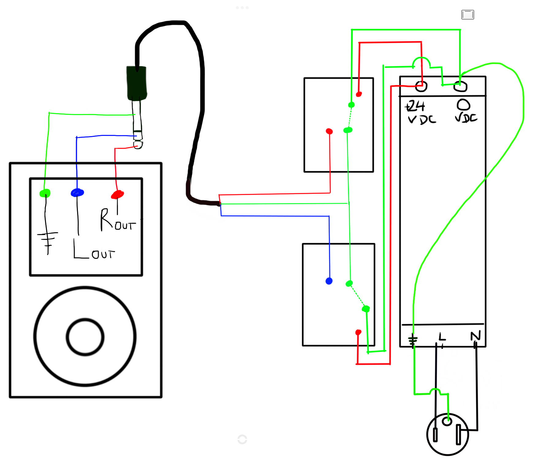

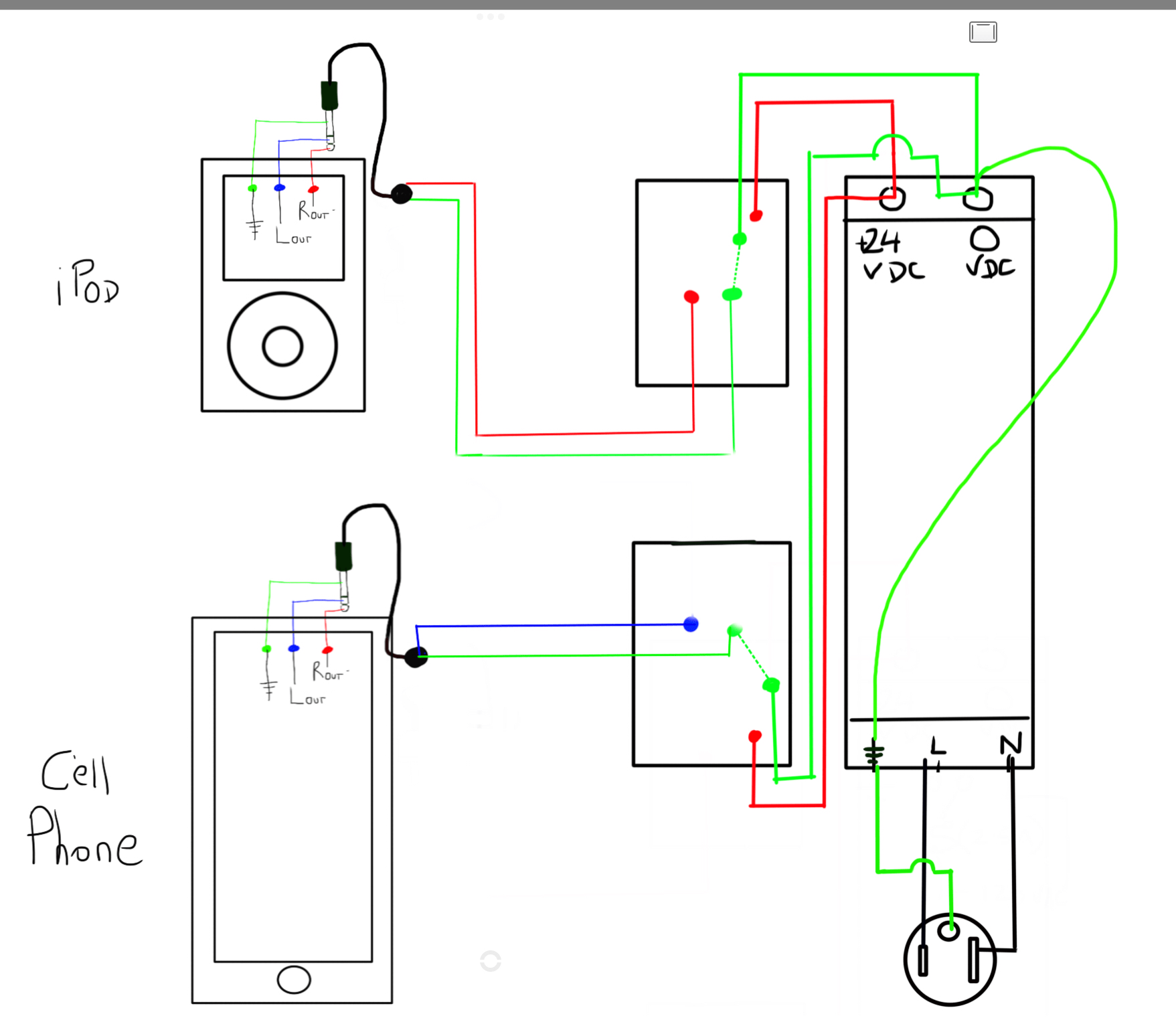

Hi Steve, thanks for the insight. I am doing my best to digest it. First response is I have no intention to bridge any pair of these amps so that issue is averted. No speaker terminal will be connected to any other. If I understand you correctly, the T-amp circuit is inherently a bridged design in which the speaker midpoint is at half the supply voltage, in my case 12 volts…? 12 of those volts facilitate the push of current one way and 12 of those volts facilitate the pull of current the other way. Which would mean signal ground can never be shared between amps because they each determine where that point is depending on what the input signal is doing at any given moment. I’m totally confused. I have built many amps, all enjoying a positive and negative supply with 0 in the middle as an impartial referee. I need to search for a visual aid to help me relearn what is going on here with class D.

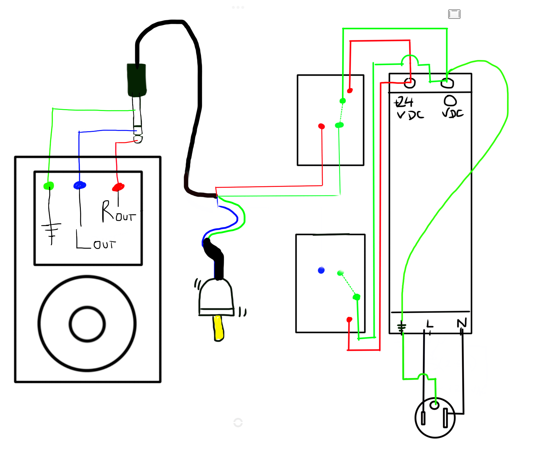

While I do, and reread recent posts, I am attaching diagrams of my 2 successful and ultimately useless configurations, and one showing the problem, which I suspect you already understand and I don’t. Yet.
1 - how are you measuring the frequency of the noise?
could you be an order of magnitude out?
60 Hz (rather than 600Hz) would suggest a ground loop.
2 - move the power supply away (long cable on LV side). If this reduces the noise then radiated noise from PS is the problem.
3 - diag 1 (noisy), what happens if you disconnect blue, leaving both green input grounds connected?
4 - diag 1 (noisy), what happens if you disconnect green input ground from second amp, leaving blue connected?

It's unusual to have a ground issue when using a battery powered floating device like an iPod or a phone. There is a strong hint that the connection from the iPod has a problem. Apple products have various jack pinouts and often use 4 pin TRRS, and not the standard 3 pin TRS. Even the pin assignment can be different depending on the model. The iPod shuffle uses the TRRS for battery charging as well (uses a 4 pin TRRS to USB cable).
Which model and generation of iPod is it?
Can you use 2 channels (LR) from just the Phone connected ? or is it the same as the iPod.
Responding in reverse order: Don, I swapped out the iPod of the cellphone only and got the same results. So unless they both share this connection issue, unlikely the culprit. It is an iPod Classic 160 GB.
Russc: 1. The frequency of the noise was measured two ways. The audible manifestation was simply compared to a tone generator. As mentioned before, the frequency declines over time. (When I first meaured it was at 666 Hz! Over twenty minutes it had fallen to 620 Hz.) I just recorded an mp3 of it on my phone, but realized it isn't allowed. (Are there any audio file formats allowed?) I got the 1.2kHz from an oscilloscope, which shows it also.
2. I will have to do this later as it will require much disassembly, and I only want to do that once other simpler diagnostics are considered, like your others...
3/4/5. Baseline reading on my dBv meter 6" from speaker is 36 (no noise condition). The noise condition shows a roughly equal 52 dBv on each side. When second channel (R) signal is connected only, R ground dangling, I read 70 dBv on the L channel. When I connect second channel ground only, Signal dangling, I read 50 dBv on the R channel only. When L signal only is sent to both amps, same noise as before.

I use 1 supply with 3x Stereo+ 1xMono T-amp boards with a single ground, no problems. I also connect it to either a PC sound card or an active analog XO and no problems. I have an active 3way horn system. It can be done.
