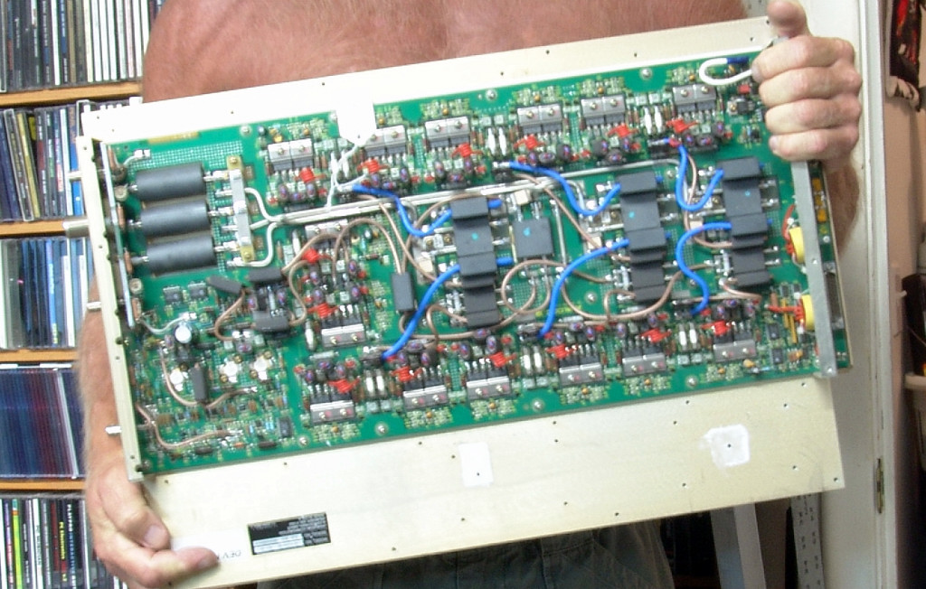

I have been grabbing scrap stuff from an MRI machine repair company at the Dayton Hamfest when they bring it.
I bought this 2.5 KW MRI amp for $50 several years ago. I wanted the RF power fets and the ferrites for ham radio power amps. I separated the PC board from the big heat sink, and took the RF stuff I wanted. I then resold the big heat sink to a guy that was building a big class A audio amp for almost as much as I paid for everything.
There was a 48 volt 1KW SMPS and a few BIG caps that dealt out the power pulses for the 2.5 KW RF amp. That power supply is now running a TI TPA3255 EVB to slap around a Dayton subwoofer from Parts Express.

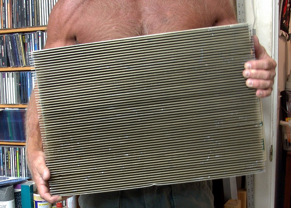

I grew up in Miami Florida in a time when only rich people had air conditioning, and we were not rich. There was also a lake nearby and I spent quite a bit of time in it....or the Atlantic Ocean for that mater. For most of my life I wore just a pair of shorts unless more clothing was required. So did most of my friends.
I lived in south Florida for 62 years, and spent much of my time outdoors and in the water, so that habit is still with me even when nobody is around and it is not so hot now that I have moved 1200 miles north.
Sorry, old fashioned person here. Had to wear a shirt on pictures and dinner without t-shirt meant no food (whatever the temperature was) 🙂

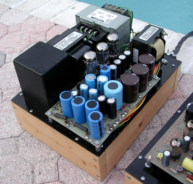

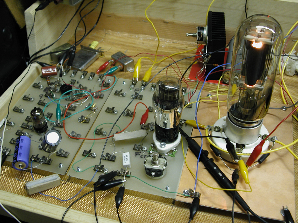

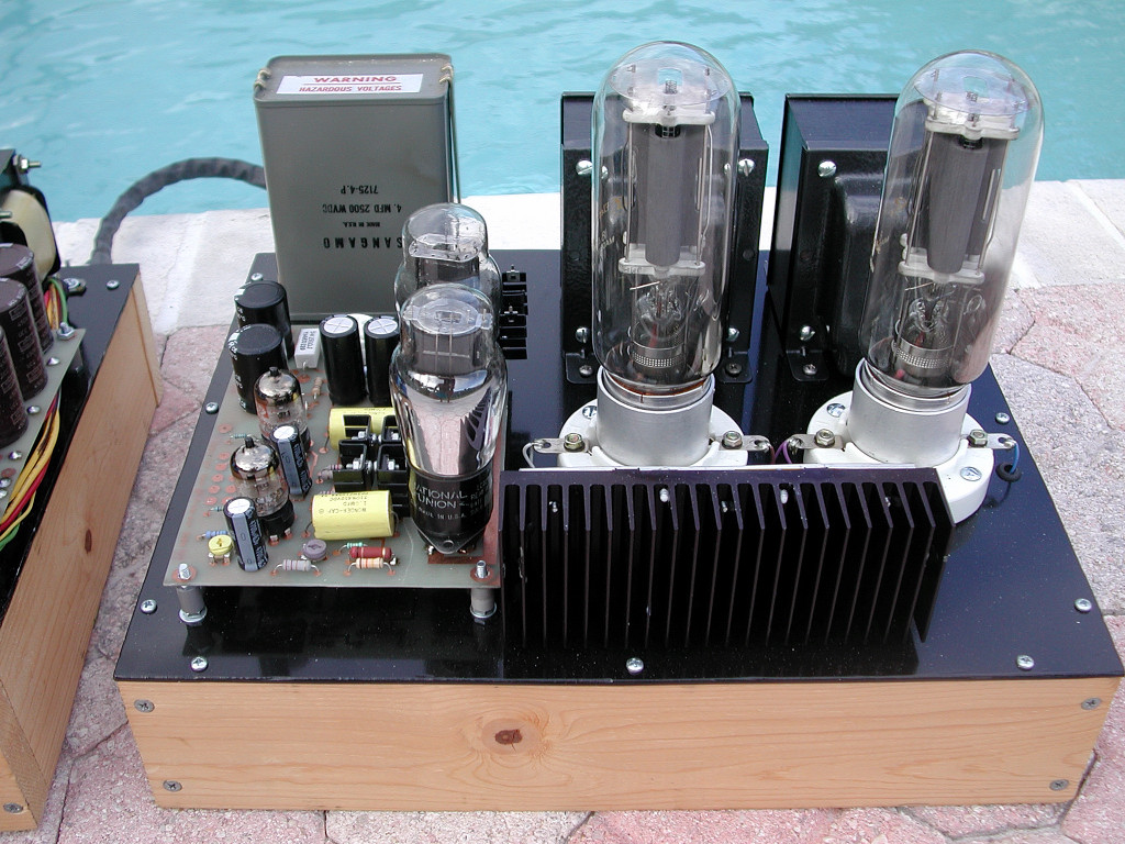

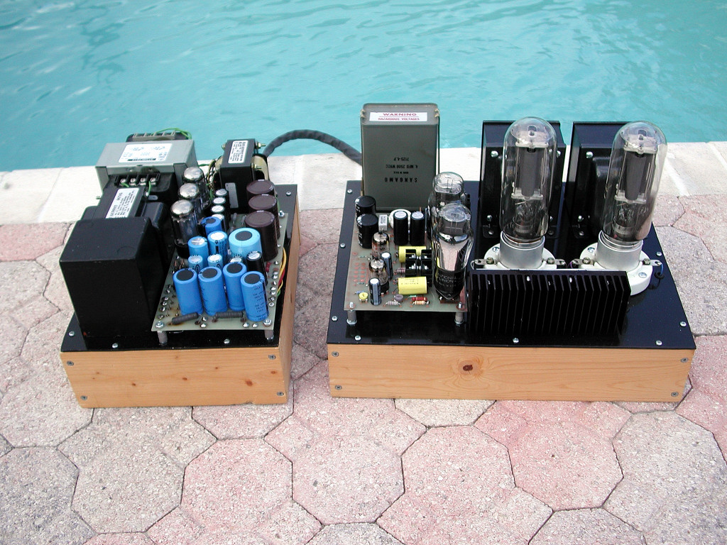

Almost 20 years ago I built a tube amp known on the internet and some paper magazines as the "poor mans Ongaku." It is a big SE amp using an 845 tube on about 1000 volts. I believe it was sold in kit form or part by part from Audio Note UK. A coworker had purchased all the expensive parts, transformers, tubes, and sockets, but wandered off into the battery powered class A mosfet world before ever building it.
I built that amp, but did not like it. It measured bad (lots of IMD involving mains frequencies) and caused serious listener fatigue. I just got annoyed with it and wound up turning it off after an hour or so.
I ripped it apart and redesigned it into something I liked listening to. The redesigned amp had silicon in the signal path. The first two stages were on a PC board, a prototype of what became the Tubelab SE, and now the TSE-II.
I rarely used the 845 amp because it put over 500 watts of heat into my small room to make 30 WPC. After an hour it was too hot to be in the closed room, and I had two air conditioners.

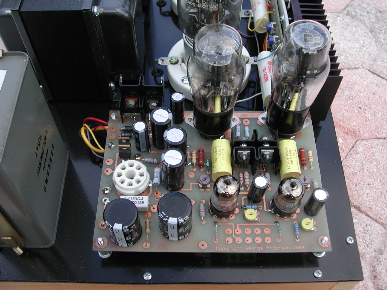

The driver board went on to become a successful amp design using 45's, 2A3's or 300B tubes. When I first published the design on the internet the response was overwhelmingly negative. Several people even suggested that i change my name to Transistorlab. Now over 15 years later, sticking "sand" in a tube amp has become almost trendy.

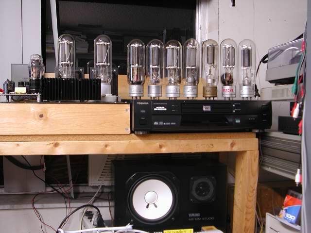

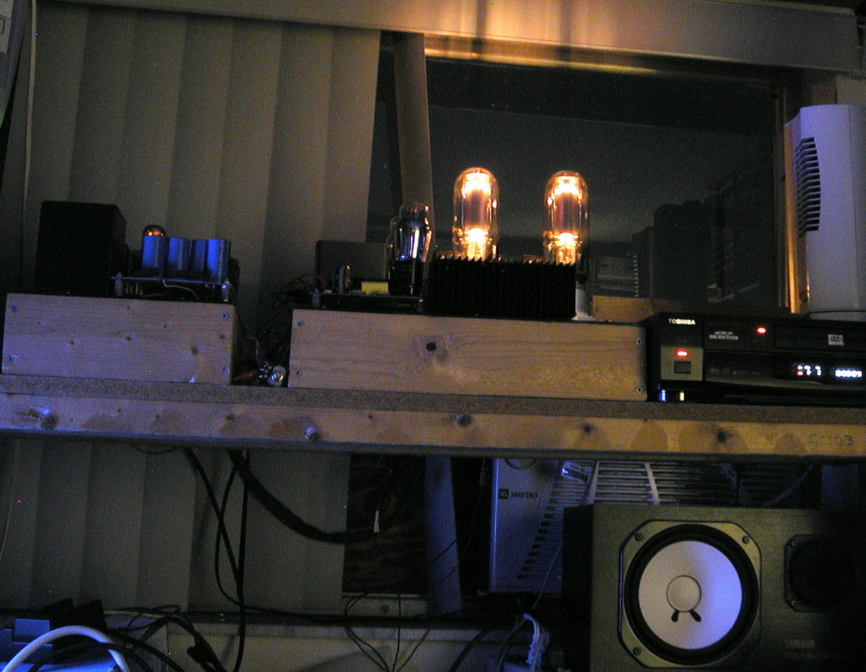

I spent 41 years at Motorola, most of that as a product design engineer, or research engineer involved in "advancing the state of the art in radio frequency design." I will use the best part for the job, regardless of what it is.
I may be known here for abusing, and blowing up vacuum tubes, but the truth is that I have fried far more silicon, GaAs, GaN, and SiC in my life than vacuum tubes, and even got paid a nice salary for doing most of it!
The first picture, almost 20 years old, shows the real early prototype. Yes, there is silicon on that heat sink. Its driving the big tube. The 5th picture shows the second prototype of a Tubelab TSE board being used as the driver in the finished amp.
The finished amp sat up on a high shelf to minimize room heat. A window air conditioner can be seen below it (behind the speaker). It is one of the better sounding amps that I made, but still I only used this amp at night due to heat, and once I learned to build more efficient amps, not at all.
It's still on a shelf in the basement, but due to the presence of curious grandkids and exposed 1100 volts, it has not seen power in years.

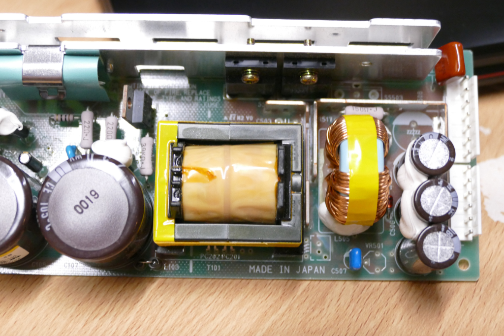

These are not the typical cheap power supply. They are "commercial grade" and still sold by Digikey for $160 each, even though they appear to be about 10 years old. They are "Made in Japan" and full specs and data sheets are downloadable. The isolation spec from any of the three possible combinations is 500 volts DC (which will be violated) and 500 to 3000 volts AC, the 500 volt spec being from output to safety ground (again, will be violated).
A full inspection of the board reveals the reason for the 500 volt spec. That brown capacitor in the upper right corner of the board goes from output to safety ground and it is rated for 630 volts. It will be removed. There is a nice wide isolation barrier between the input and output marked on the board. The only things that cross it are the optocouplers (2200 volt spec) and the previously mentioned cap.
The installation instructions state that these can be simply wired in series, but I'm sure that they didn't foresee the dumm blonde one wiring 13 of them in series, so I will include a big reverse biased diode across each output, and some higher voltage rated caps and inductors in an output network.
This series string of supplies will feed a bank of mosfets for choosing different plate and screen supply voltages, since I don't plan on running the amp at the 1KW power level most of the time. Provisions for shutting off some of the output tubes are an option too.
