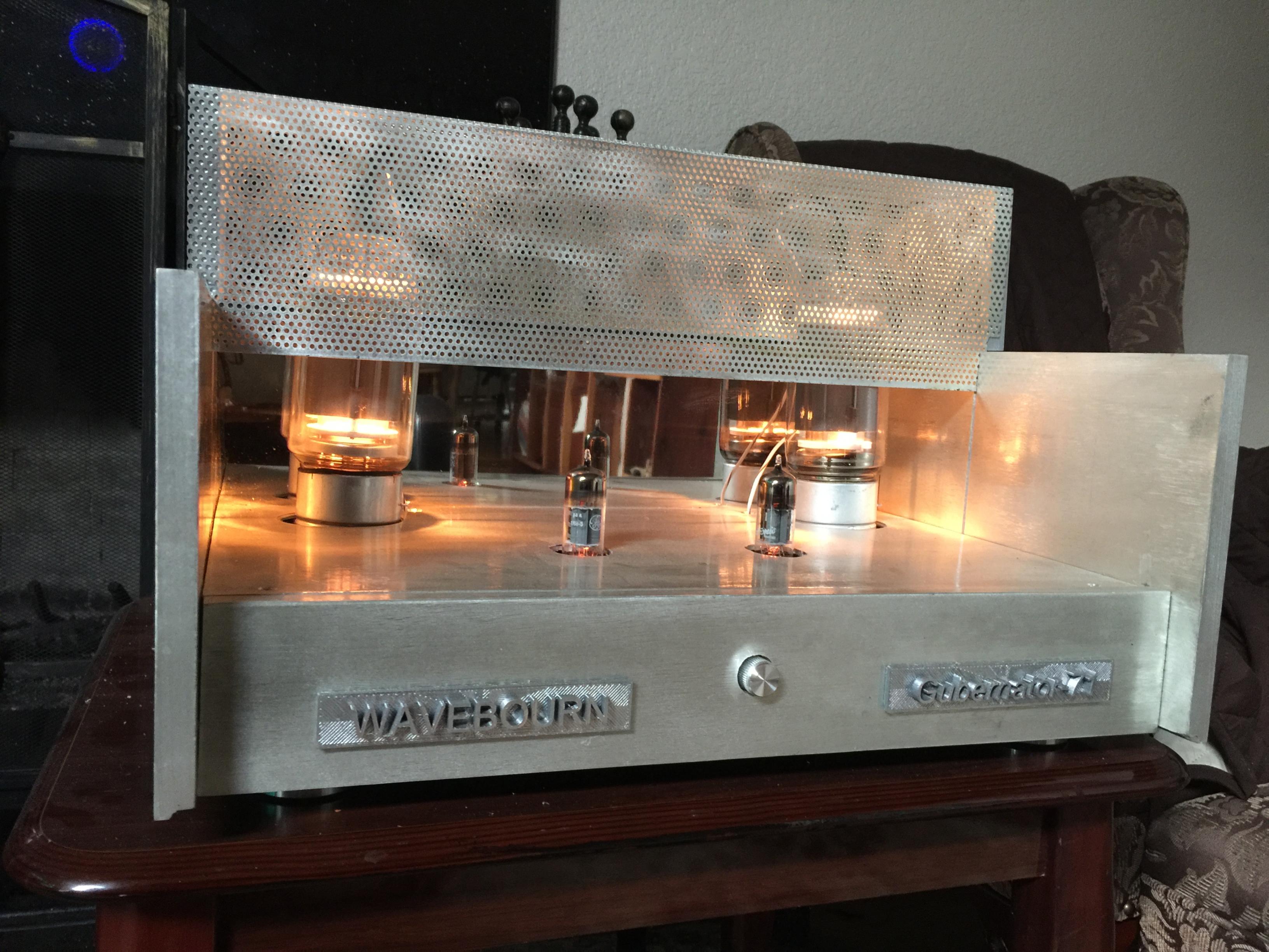

Hi everybody!
I finished lately my "Tim Mellow Project" with little changes from original.
Biggest difference is power supply which is made on 6 SMPS. Four of them are working for +/- 150V rail (L&R channels separated), one is providing 6,3V for pre and driver stages and one is just for 24V supportive source (timers + fans).
Result: the amp is dead quiet and the dynamics feels endless...
I named it Rolling Stone - couple of pics as well...
