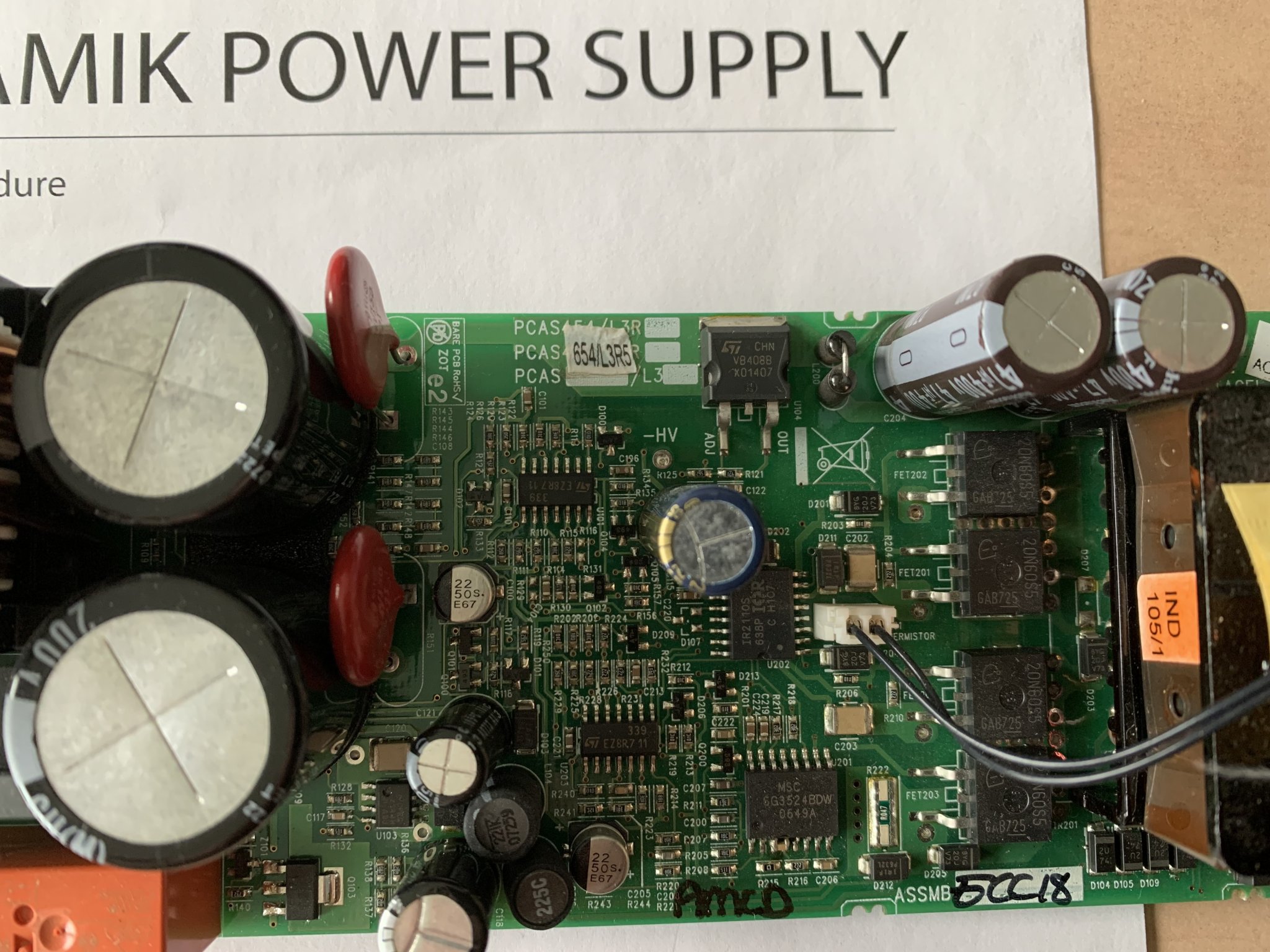

If it's of help to anyone, I have just opened up my AV5125 to measure the SMPS output voltage. It's a pre-Dynamik PCAS254/L4R, just like the one in the original post. It is +-30 V on pins 1, 2 and 11, 12 out of the psu. The demand voltage on pin 4 i 3,3V and of course used for the signal sensing standby feature. I verified the voltage to be the same going into the inductor 029.
The reason I checked is I because recently got hold of a Select Dynamik psu cartridge that was switched out for the new Utopic psu. I was hoping to be able to hotrod it somehow into my amp, but it has a much higher voltage at +-45 V. It also has a +25 V and a +12 V rail as it is used for both pre- and power-amp functions in the modular Selekt platform. I have to do some more research to see if i can use it for something else or regulate it down. I doubt that the AV5125 circuit could handle that much overvoltage, even though the output chips definitely can.

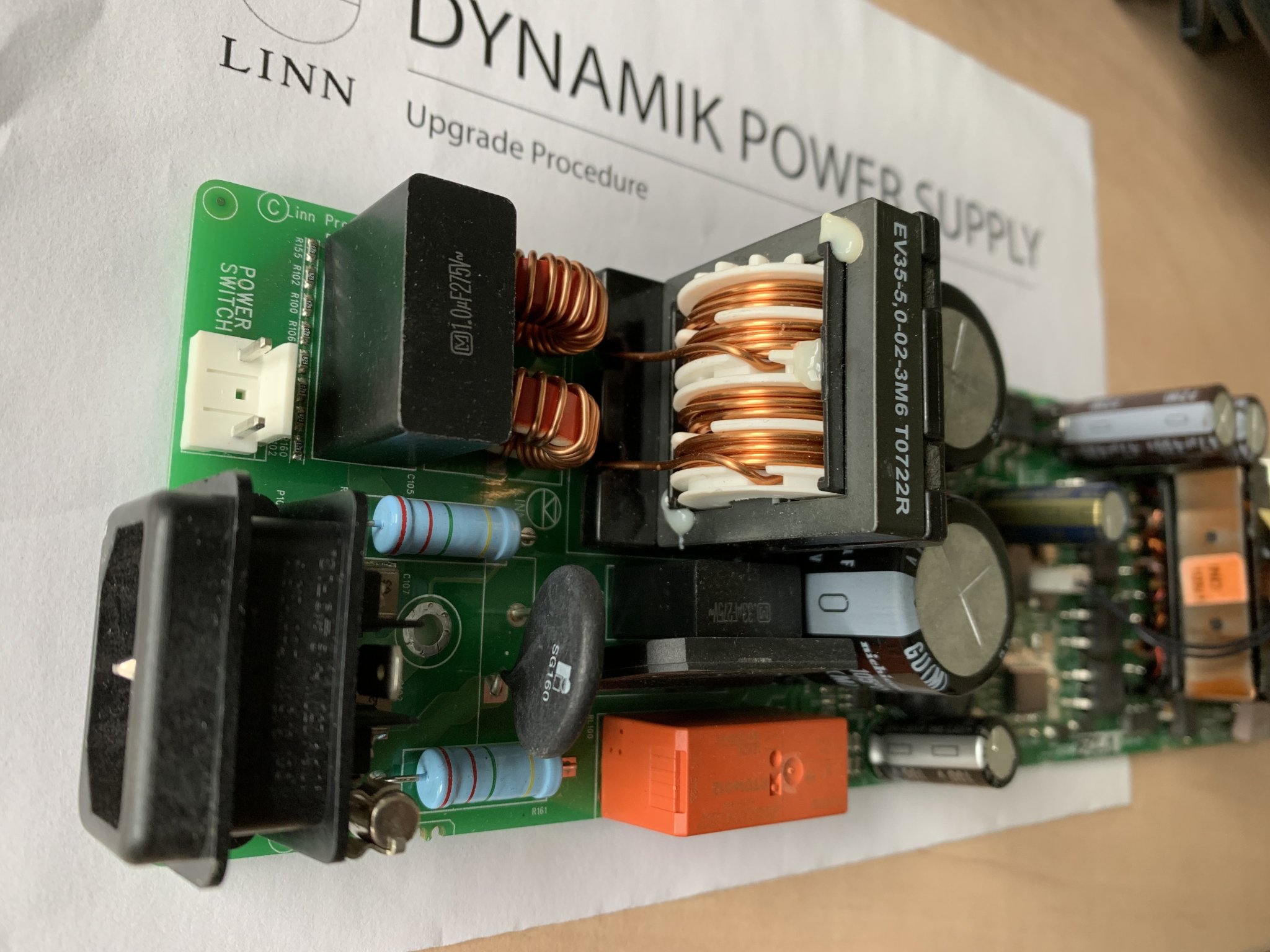

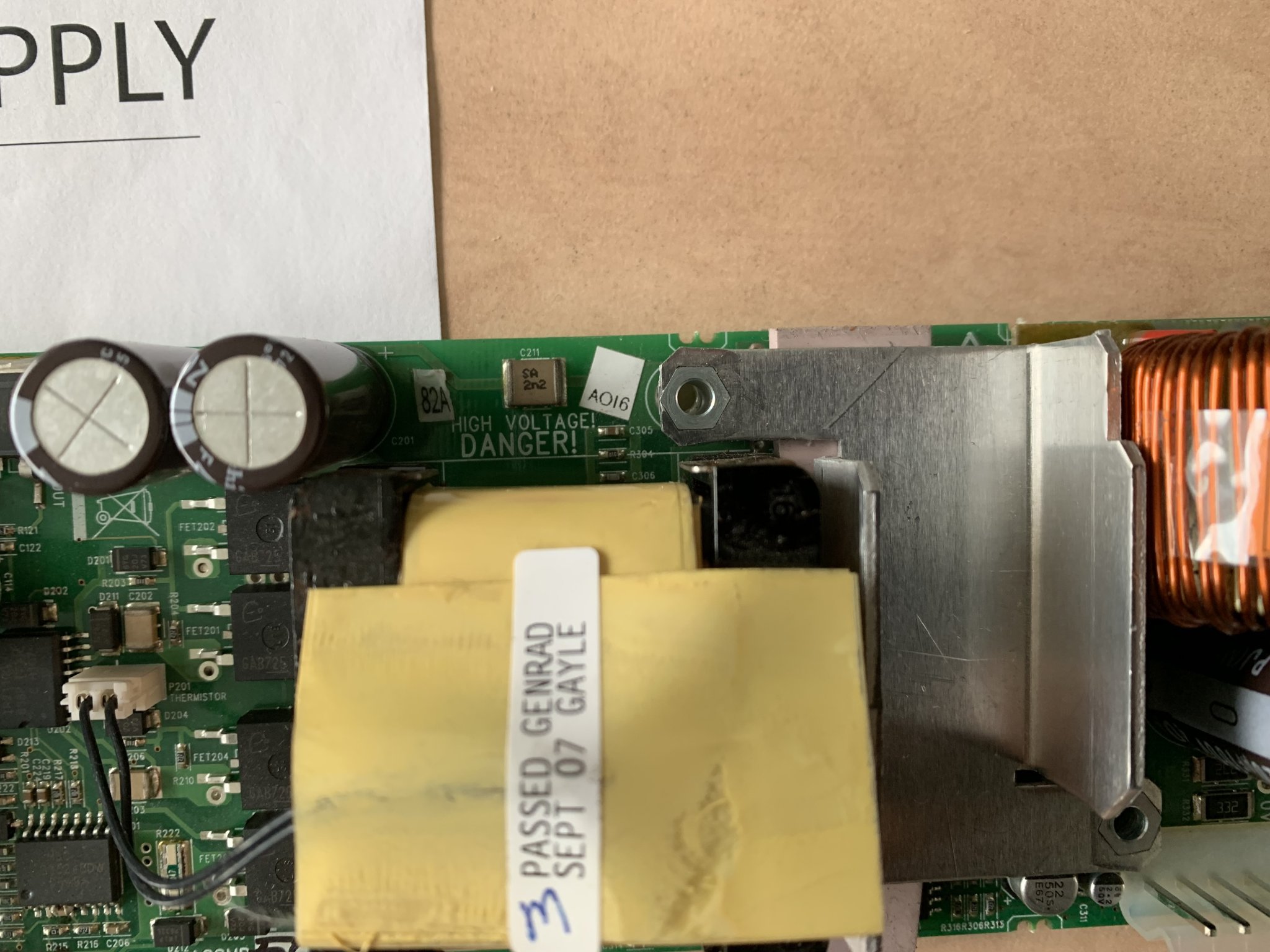

This is very old thread and I don't know if the OP still look for power supply. I have old unused LINN DYNAMIK power supply brand new in a box. I just measured the output voltage +/- 30 (more precisely, 29.6 V with my DMM). I'm about to build an amplifier with this power supply, but it doesn't necessarily require LINN brand. So this can go to whom really demand replacement of LINN PS. I then anyway need a good SMPS with 28-30 V thus requires some budget covering shipping, though.

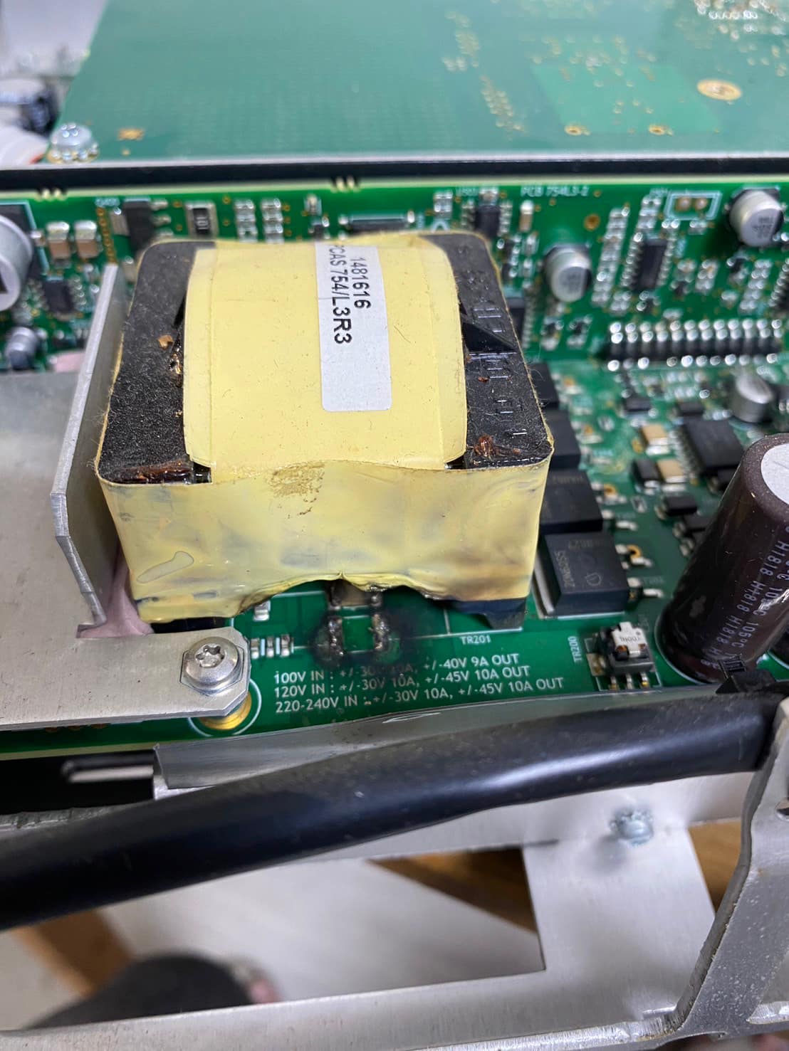

My PSU been broken due to the thunder shock. The transformer been burn out, but I don't have the data sheet for it.
So need the whole PSU or the center transformer. Also my linn unit is Majik DS.
