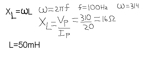

Don't wish to sound anti-climatic, but maybe a better solution is just to use a choke after the mains bridge rectifier. It creates a simple PI-section filter. It does not give a high PFC, but I think it is good for audio. Here is an example where the choke value is chosen for 20 amperes peak to charge the primary capacitor from full wave-rectified 220vac. I have been using this method on my projects already. The file below shows the simple calculations for the example above.
Not using switching devices (switches) before the filter capacitor prevents dead spots in the response where the rectified voltage has dropped below the useful range of the switches when they are under a heavy load. At that time efficiency has fallen very low as well. There you have my simplified take on things.
