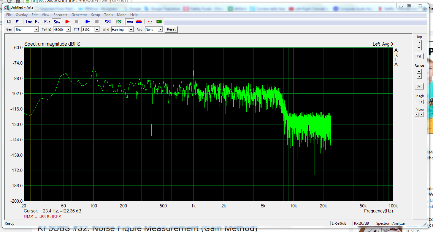

But first i need to understand how to get those graphs of noise ... i see mentioned ARTA software as a valid tool.

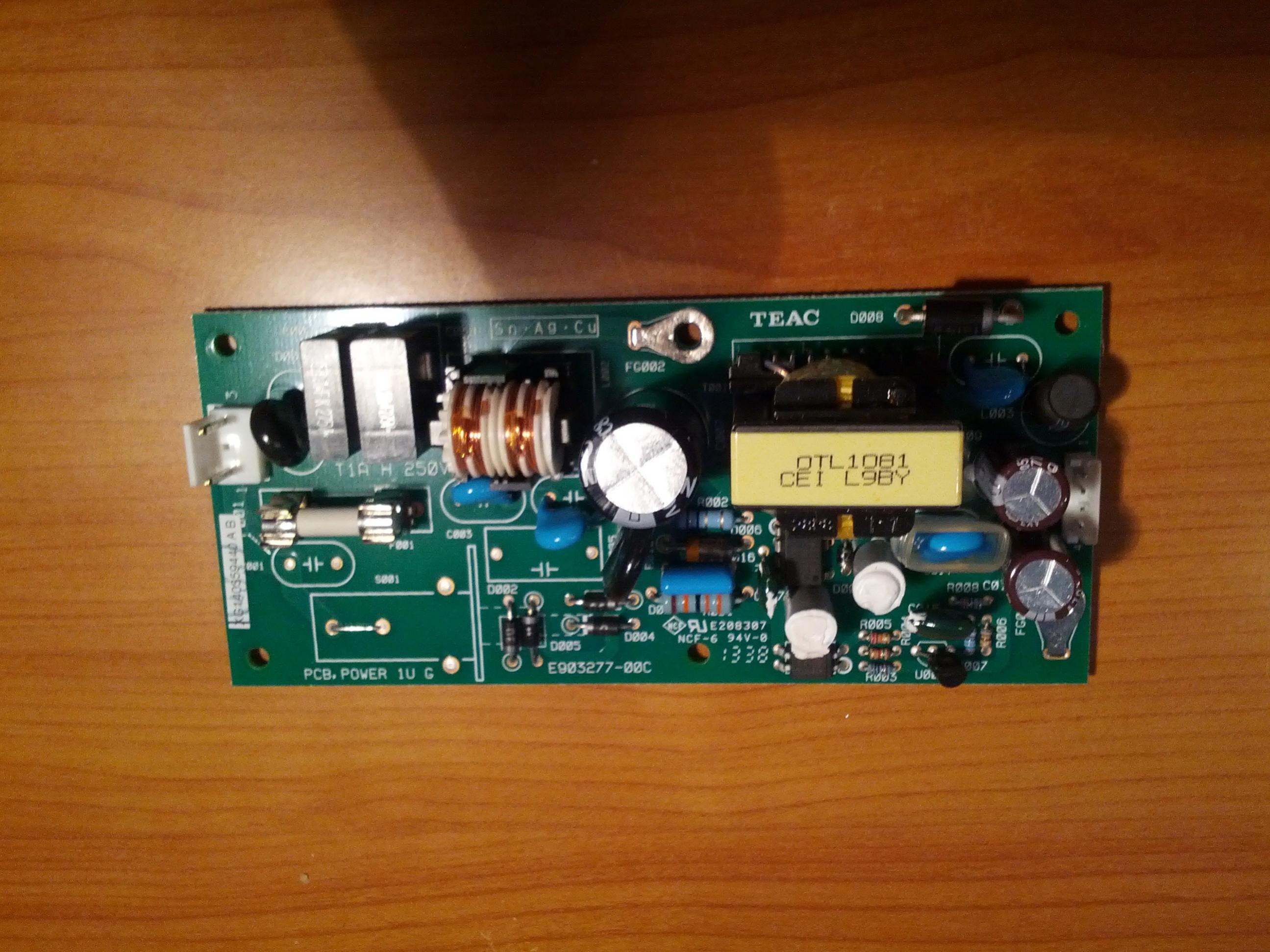

I am attaching a picture of the smps pulled out from the box.
I checked and there is one input for the 230V and just one output with 4 wires but they are connected together 2 by 2, and 2 are grounded.
So in the end it is a single output power supply !!! good !!!

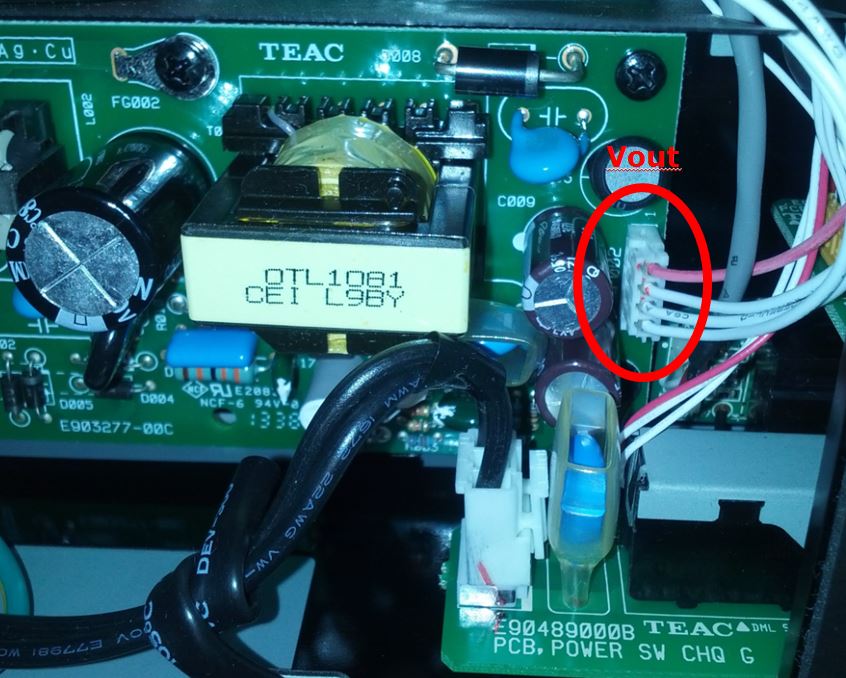

I read that Vout should be around 11.2 V ... now that the smps is out i am a little scared to connect it to the mains to check the Vout 😱

You know that -120 dB is one part in a million, yes? Your noise problem is a million times weaker than the signal...that means there really is no problem!Still please follow me a moment ...

That grey four-pin connector is the power supply DC output, right?Now the big problem is to measure the Vout of this blessed smps.
You can turn the power supply PCB over, and use a voltmeter to measure the voltage at each of those four pins. (The black wire from the voltmeter needs to be grounded - you can clip it to the metal chassis, for example.)
The board must be on an insulating surface (wooden table top is fine). Obviously, no pets or small children around. Be careful to only touch the insulated handles on the voltmeter probes during the measurement, and stay away from the AC end of the board - there are dangerous voltages there. If you like, you can also wear protective electricians (insulating, rubber) gloves, as an extra layer of safety. (Google for "Class 00 electricians gloves" if you want more information.)
If you're not comfortable making the measurement, you may be able to find an electrician or electrical engineering student who will do it for you.
With the scale corrected the peaks of the bumps are at around -100dB. In some graphs the Y values are not correct.
If they were really at -120 i would agree.
I am attaching a picture with the output 4-wires connector. 2 wires are ground and the other 2 i guess V+.
So in the end is a single voltage out unit.

Thanks a lot indeed ! i would buy absolutely a pair of this glove immediately.
The thickest one available 😉
I think that with the glove i could try to measure it.
However there is already a value of
The original outputs 11.2 V, so 12 V ought to be fine

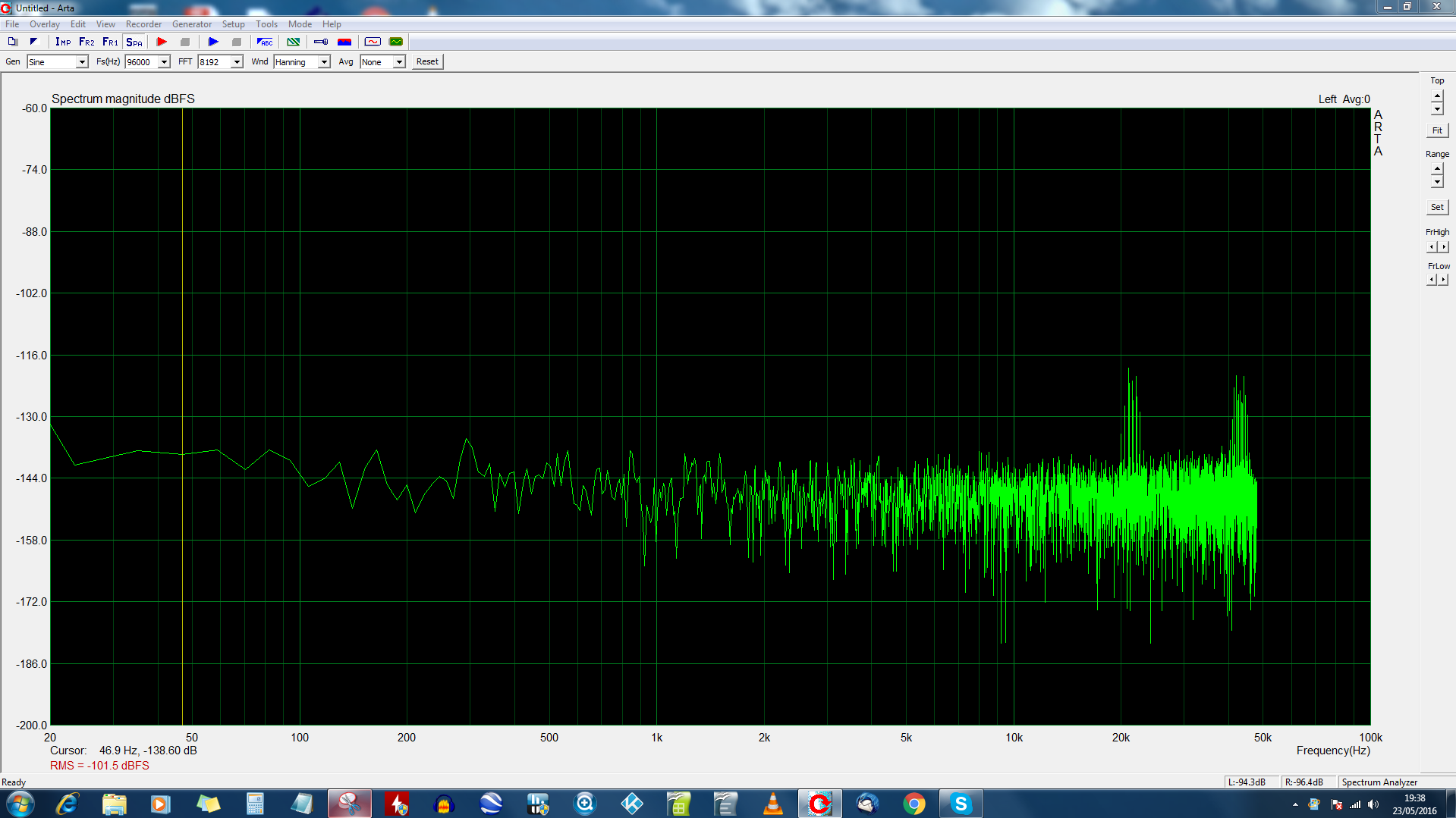

Tascam UH-7000 power supply noise
If i think that just a humble Seasonic SSA-0601S-1 would give something like this ... 😱
Y axis is not correct by the way. A -120/130 dB noise base line could be more realistic.
This unit has a big potential for high-end. Because the AD and DA converters on board seem really top notch.

Do not focus the absolute values on the Y axis ... they are not correct.

In the meantime i have found a huge discovery ... the ARTA software
You can see my request for support here 😱
http://www.diyaudio.com/forums/soft...measurements-arta-_-tutorial.html#post4720735
It provides a spectrum analyzer function that i have tested on my usb headset of which i am attaching the spectrum (my 1st spectrum ever !)
Of course next i will try some usb interface to see how silent they are.
Then maybe in the future some distortion measurement.
It looks like a really great SW indeed.
I am very excited.
Kind regards, gino

Hi again ! yes ! this is exactly my idea.
But after seeing that 400V cap i am a little scared by open frame smps.
They are like bomb ... to do this i also should find a suitable box for the smps.
All you need is to find or make a suitable adaptor cable: a four-wire cable with a 4-pin male header on one end to plug into the SMPS (grey) cable, a 4-pin female header on the other end to plug into the original header where the SMPS cable now goes.
It is here that i am lost. I have looked on ebay and there are thousands of different types.
The grey cable you see it is a signal cable going to the headphone out.
Actually this i find quite weird. The headphone out on the pcb is completely opposite of the headphone out on the front of the unit.
Then there is this long grey cable running through all the unit and i am pretty sure it is not shielded. What a nice antenna for noise ...
However ... i am getting a little mad because the 1st thing i would take care of is to separate power supply from the circuits .. at least with a shielding partition or even in two separate boxes connected with an umbilical.
To be more clear, the smps has just one AC in and one DC out (4 wires cable with one wire red and 3 white, but they are connected 2 by 2 so in the end it is a single voltage supply ... it should be 11.2 VDC from what i read). I am attaching a picture of the output 4 wires cable.
You have already removed your SMPS from the chassis, so just extend the wires as described above, and you have what you want...and, it's an easily reversible modification if you do it the way I suggested.
(By the way: -100 dB is still one hundred thousand times lower than 0 dB. I guarantee you do not have 100 dB of signal to noise ratio in your recording studio. If your loudest sound is, say, 90 dB SPL, and the background noise level is 30 dB, you only have 60 dB dynamic range.
The tiny, out-of-audio-band, noise in your TEAC is still a hundred times lower than the background noise.)
-Gnobuddy

Hi Guys!
yes the noise is there .... 🙁
The sad thing is that the basic line is down to -140dB (!)
If i think that just an external ac adapter could have erased those nasty peaks ...
it will take some time .. but one day those peaks will go away for sure.
Kind regards, gino

Hi again !
i have studied more the issue.
I have come to the conclusion that the solution of putting a smps in the same box of sensitive audio digital circuitry is very challenging and often when shielding is not cured enough really a recipe for disaster.
These things spit EMI/RFI all over the place.
I think that in the end the smartest move will be to remove the internal smps and use instead and external power supply, even a smps but encapsulated. Actually this is the much more common solution adopted by other manufacturers and what i will do for sure.
The problem maybe now is to select/build a decent AC adapter.
But i am pretty sure that almost any will give better noise performance than the present solution.
I will post the graph with the external power supply.
Thanks a lot again for you very kind and valuable technical support.
Have a nice day !
Kind regards, gino
