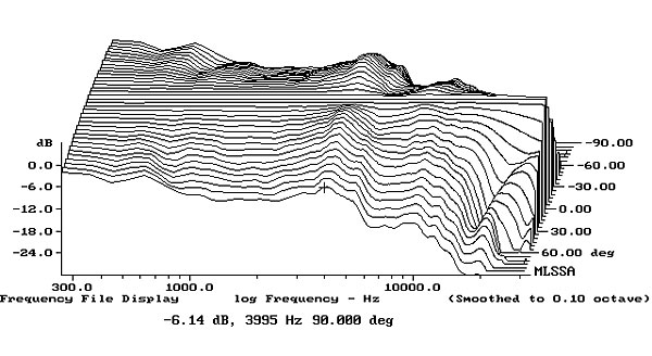

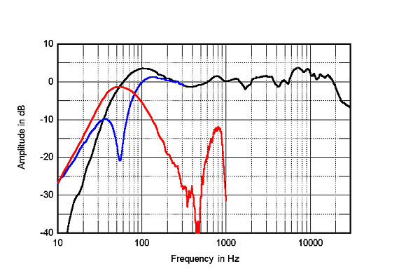

You are missing the fact that most speakers are not very well behaved off-axis - very few are. So just going off axis does more than just a small falling of the HF response - the whole frequency response gets all messed up. You can see this very clearly in my PolarMap database of real speakers. It is the rare exception where the response off axis is smooth and near flat.
I've seen many speaker FR's both on axis and polars. Many of the good ones I've seen that have very good on-axis FR's also have reasonably smooth off-axis polars as well.
Here is but one example from Mr. Atkinson's vast measurement library. You may take issue with his methods now that you've developed your own polar measurement system and that's okay. I visited your site but found I needed to download the polar S.W. and some database files in order to view the polars you have. I gave up at that point.
Dynaudio Excite on axis, left and polars, right.

That's too bad, because I think that Atkinson's polars are flawed and that my technique is the best out there. Your loss I guess.
The example that you show is actually pretty bad, but with plots like that it is not easy to see.
