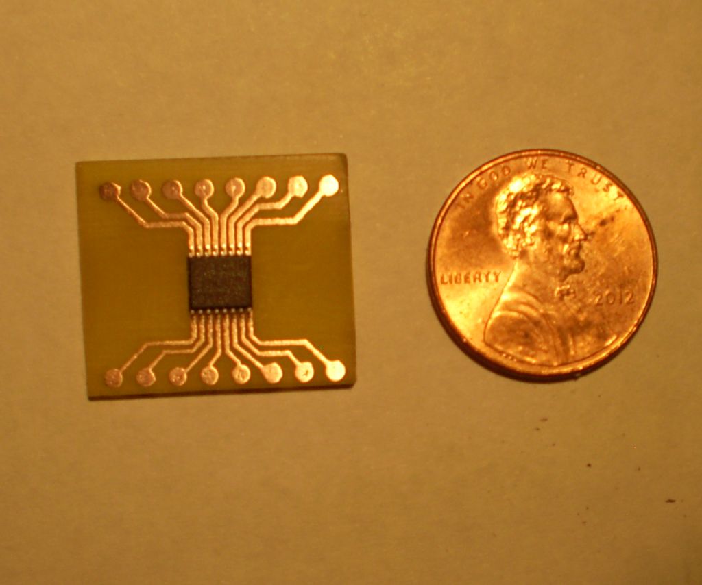

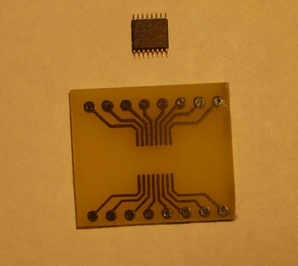

Hi there !!!
I just took my First plunge into the world of SMT today so I thought that I would share it with all of you as well.
This is a board that I made using DIP Trace and my Samsung ML-1865W laser pinter at a 1200dpi setting for the graphics.
I also used HP double sided photo paper.
It it took 5 tries to get the print transfer process to come out properly.
The First board came out a bit smudged with ragged edges and was not suitable for use for fear of solder bridging some of the traces.
So I used that as my practice soldering board.
After total of 5 tries I got it down very well and the second board came out perfect!!!
It was much easier than I had expected considering that it is the smaller TSSOP SMT package and that I had hand soldered the pins.
I used Radio Shacks 62/36/2 .022 Dia. solder (Cat. 64-013) and their Non-Spill Paste rosin flux (Cat. 64-022).
I should have used the smaller diameter .015" solder for this package but it worked fine just the same.
I looked all over town to try to find some Solder-It solder paste and nobody seems to carry it any more even though I have seen it on the shelves a few years ago.
Eventually I will get some proper syringe type solder paste via mail order so that I can just use a heat gun, But these products worked just fine much to my surprise!!
Being that this is a TSSOP-16 part it is about half the size of a SOIC-16 part and I had my doubts!!!
But not anymore !!! 🙂
It is about the smallest there is as for as pin spacing goes, although, I know there are a few that may be even smaller but not by much!!!
I don't expect to be using anything smaller than this for the most part.
I had stayed away from this technology for many years only to find that it is much easier than I thought it would be to work with.
You need just is a little patients, lots of light and a good magnifying glass is all.
Oh,and a fine tipped iron as well.
I got a new fine tip for $2 and ground it down to suit my needs.
Once had I got my pattern save in 1200 dpi format I used IrfanView to duplicated it, as dip trace only allows you 300 pins per project.
I then printed out a whole sheet of photo paper with about 20 to 30 patterns on it in order to not waste any of the paper.
Now I have several more for other projects as it took 5 of them to make just this one (two) board ! 🙂
Here are some pictures of my little adapter board for the M74HC4094TTR 16-TSSOP serial in/parallel out shift registor latch that I made.
I am going to use this with a TLC548 8 bit A/D that is in a 8 pin DIP that I have had for years but never used.
Cheers !!!
jer 🙂

Very nice work and just goes to show what can be done.
A good work around with Diptrace for the 300 pin limit is to use single pads for resistors and so on. I've found I could work past the limit doing that.
Pin pitches are quite common at 0.5mm these days, there are some 0.4mm QFNs appearing. BGA's are also appearing with pitches of 0.5/0.4mm and smaller ones are being developed. This makes routing boards quite a challenge and when dealing with this size of components will use microvias and HDI PCB design
Thanks for the tip Mooly!!!
I was wondering if using just pads would go against the pin count issue.
I will give this a try!!
jer 🙂
jer 🙂
