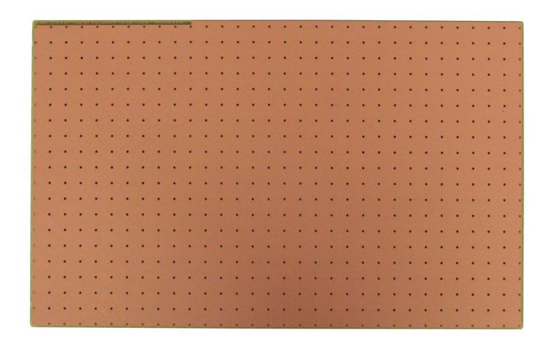

Has anyone used this type of SMD protoboard?
"Grid of 42 mil square pads on 50 mil centers allows SMT components of various sizes and pitches to be mounted."
(I found this one and other types at allelectronics.com)
50mil = 0.05"
That seems a big pitch for many smd footprints.
sot223 is 2.3mm pin pitch
sot23 is 1.9mm pin pitch and the third pin (collector/drain) is offset by 0.95mm
50 mils is 1.27 mm - small enough but if pitch is off it won't line up with pins on popular ic's. The concept is nice if they perhaps provide various size pitches. The last one I did was 0.65 mm pitch - tiny.
Most modern SMD devices are hard metric pitch and much smaller than 1.27mm (this is the pitch of SOIC IC's).
0.95mm SOT 23
0.65 and 0.5mm SON SOP DFN QFN QFP TSOP
0.4mm QFN
For SOIC based op amp circuits it will suffice quite well with larger SMD caps and resistors.
0.95mm SOT 23
0.4mm QFN
