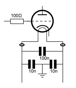

Looking at SMD components to minimize area on PCBs, but kind of lost in what components to use.
In particular I want to add some caps/ferrites to stop noise/oscillations and wanted to know if I should go for PPS caps for the 10nF/100nF, and what to look for for ferrites. In through-hole components I am using MKP for the caps, ferrite beads on some wire and 150R tantanlum resistors but this takes up more space than I would like (even when using resistors/ferrites vertically.
Not sure what to look for in SMD equivalents. Anyone with experience in SMD components?

For capacitors probably the lowest distortion readily available type are PPS or C0G ceramic, but they can be bulky for high values. Type-II ceramic distort a lot, they are not for the signal path. SMT electrolytics are readily available for larger values, but I'm not sure bipolar electrolytics exist in surface-mount packages.
For SMT resistors thin-film means metal-film, thick-film means metal-oxide. Thin film have lower distortion, but many times more expensive (although that's not actually that expensive!)
For single-sided boards zero-ohm resistors in larger sizes like 1206 make handy cross-over links. Zero ohm SMT resistors are a thing, they are actually a few milliohms of course, but notionally zero.
Murata make a lot of magnetics, they are reputable, but you have to understand your requirements and the device datasheet to figure out if something is suitable.
SMT devices have to survive a reflow oven, whether a particular sub-miniature tube would be happy I've no idea. They have a lot of thermal mass which means they are likely not to be surface-mounted as it would take longer than other components can tolerate.

Some (potentially unwelcome) advice: When choosing and placing SMD parts for tube circuits, make sure you maintain the required spacing for clearance and creepage for your situation. This applies both to part-to-part spacing and to the terminal spacings within any given part. It's easy to ignore voltage ratings for e.g., resistors. But even if you don't, verify. A part may be able to withstand higher voltages than is considered safe for the clearance between its terminals.

@lauda Indeed. These parts are for the filaments mainly, so they should not go above 6-12V in my case.
I've been playing around with the SMD caps, but they are not that much smaller than the through-hole variants. In my case it would only make sense for the ferrites. Not sure on the sonic quality of the SMD resistors, so that grid stopper will stay through-hole as well.
SMD seemed a good choice to keep it small, but it's turning out to not be that beneficial.
