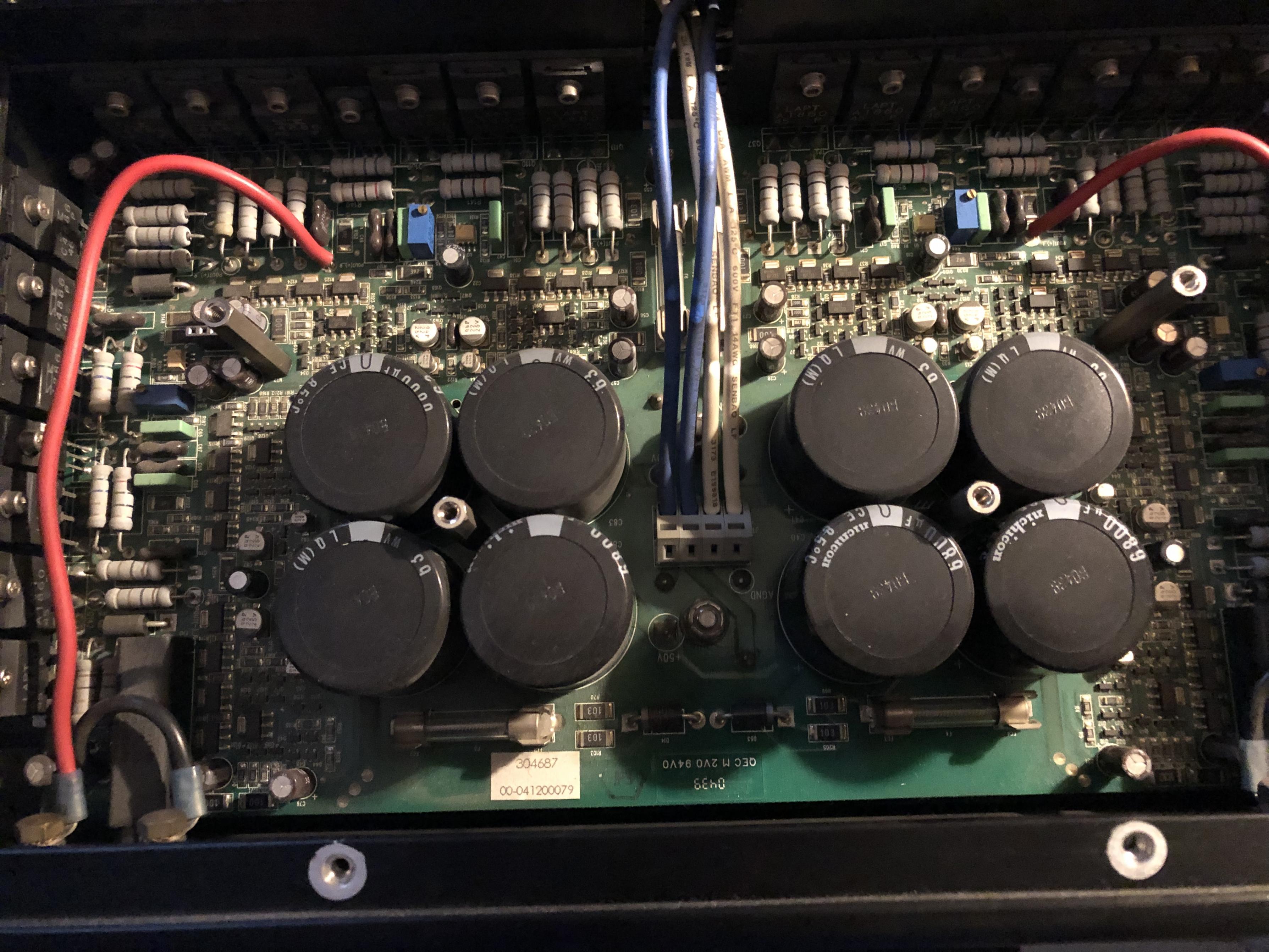

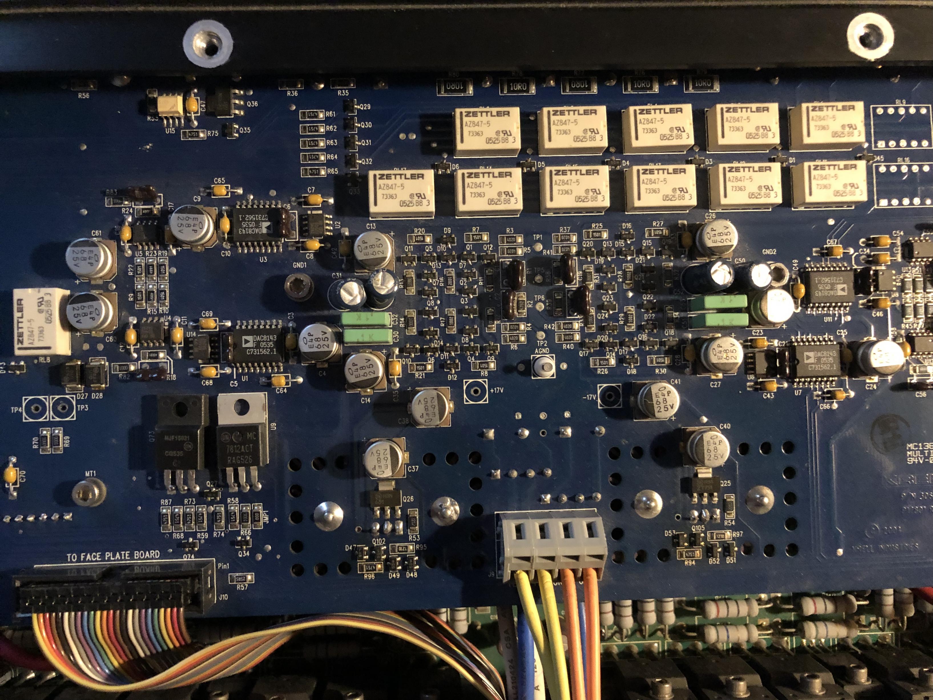

Have krell kav400xi, and maybe it is time to recap.

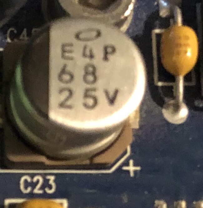

On the preamplifier board (but on the power section too), there are dozen of SMD capacitors of unknown brand and, more important, type.
Done extensive search on google, but no results returned.
Attached picture of one of these.
Appreciate any help

These are standard aluminium electrolytics that should be available from pretty much any major component retailer. Be very careful with polarity if you remove any, perhaps take photos of the board first as a record.
Thank you very much for your answers.
I was told that in kav-280p (so, the same kav series), those caps are actually aluminium solid/polymer type- so they should not be replaced, as they are od long life and high temperature endurance.
To be honest, the amp worked excellent until recently, as I have noticed a subtle sound thining. The most obvious reason for such behaviour could be the power supply caps in the first place- but what if the problem is somwhere in a zillion smd caps, since notoriously known pretty high working temperature of this model.
Shortly, I’m in doubt to start ful recap and what to replace at all.

It's a little hard to get size scale from that pic but I'm guessing size D.
https://industrial.panasonic.com/cdbs/www-data/pdf/RDE0000/ABA0000C1184.pdf
First page, lower right "dimensions" shows size codes B through G.
I've not worked on Krell amps but on lots of broadcast gear. When I
buy parts I look for ripple current (most), temperature (105, 125C) and
obviously size, value and Voltage. Odds are very high that the caps you get
today will be a higher Voltage for a given size. Higher Voltage is no problem.
Most places the height isn't a big deal but pay attention. Some of the
early (the Krell is from 2003?) SMD low profile caps can be difficult to find.
Note the base of the cap has 2 of the corners chamfered. That is the positive
terminal. Just line up the outline.

I was confused mainly by the fact (if it is true) that the corresponding kav280p are polymer caps. If so, it seems logical to me for kav400 too, since its preamp is derived from kav280p.
Further confused by the fact that there is no information about the unusual marking on the top of the capacitors.

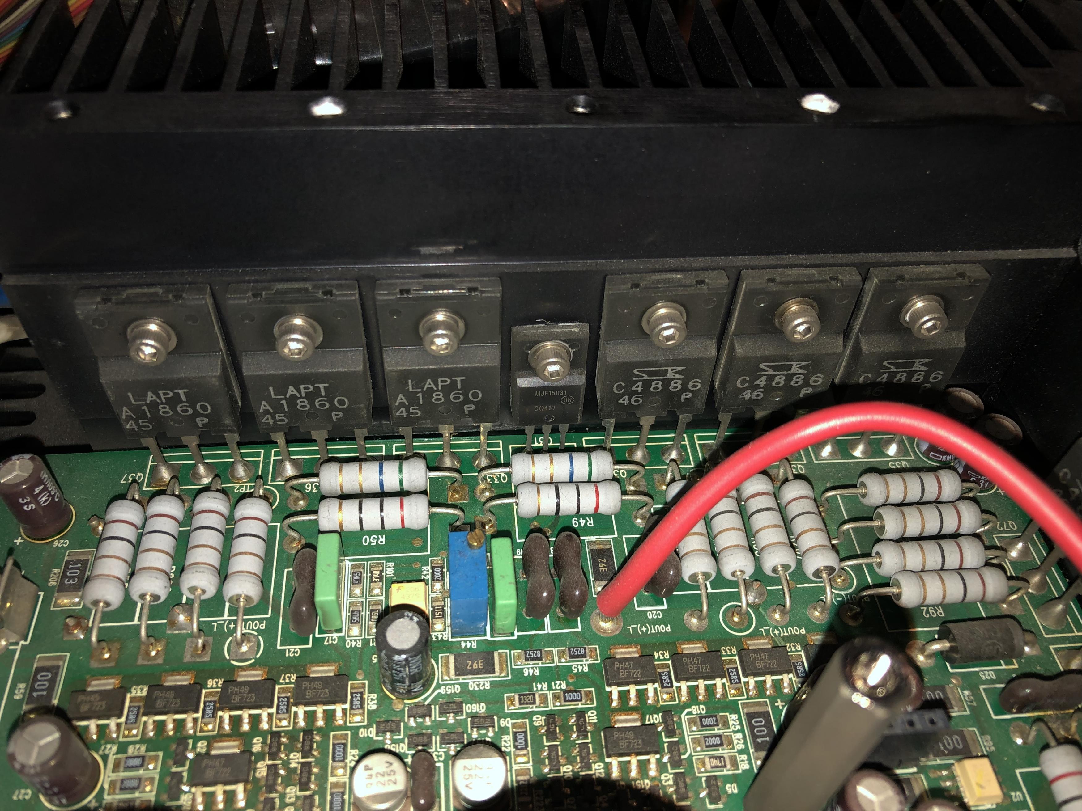

I’ll attach here some more pictures, just to show a whole amp.
No one capacitors seems bad, even those standard electrolytics being very close to heatsinks (united chemicon standard 105C caps).
And, yes, I afforded the Krell not new, but as second hand unit, and really love it&#55357;&#56397;&#55356;&#57339;
