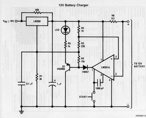

can we have a look at the circuit?? I can't seem to find it anywhere...other than a post which describded it...but no schematics...
Maybe you should try this circuit
The content of that page is not written in English but I think the schematics are easy to understand. I think this circuit comes from one of the datasheets of NS regulators but I cannot find it now. When the battery is low, this circuit charges the battery with an adjustable constant current. After the battery is fully charged the circuit will turn into a constant voltage source and hold the voltage at 13.8V. The relay cuts all active devices from the battery when the AC power supply is pulled off.
The website is in Taiwan and the PCBs are already sold out. However, it should be quite easy to do it P2P and won't cost you more than $5.

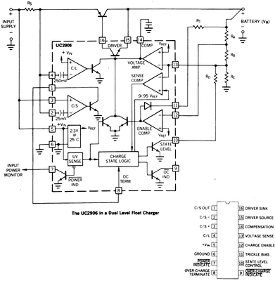

we're talking about 24V (2 batteries here) a L200 regulator seems to be an all-in-one thingy for 12V...
Have you checked UC3906 from Unitrode? IC made for charging lead batteries.
