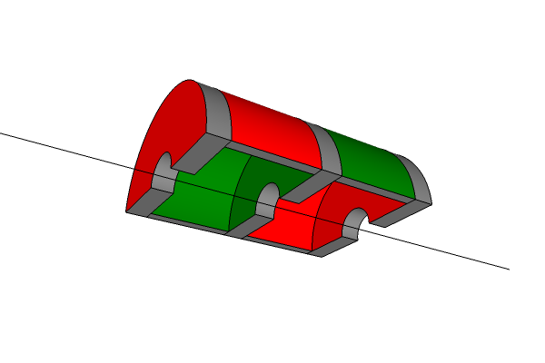

Such magnets assembled together, is one (but giant) NEO 8" toroid magnet magnetized by thick. I saw, it's used I can maybe to say often in magnet motor construction similar like in most used ceramic toroid magnet motors. There pole pieces is logically something thicker, but not so much like I expected, because they probably wanted to push even something higher magnetic flux in gap
Maybe I wasn't interested for such magnet construction in woofers, because of not more thick pole pieces there - shorter magnet gap, at least not like in radial magnetized motors (see: B-Hive Motor, some Vifa NEO woofers, or Critical Mass UL12). Such radial and similar constructions is just WINNERS for long linear cone excursion, with of course underhung voice coil like Spatz mentioned.

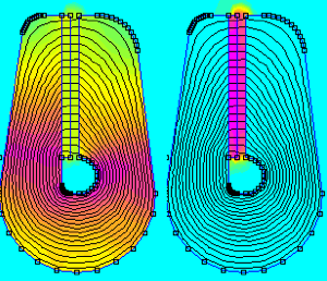

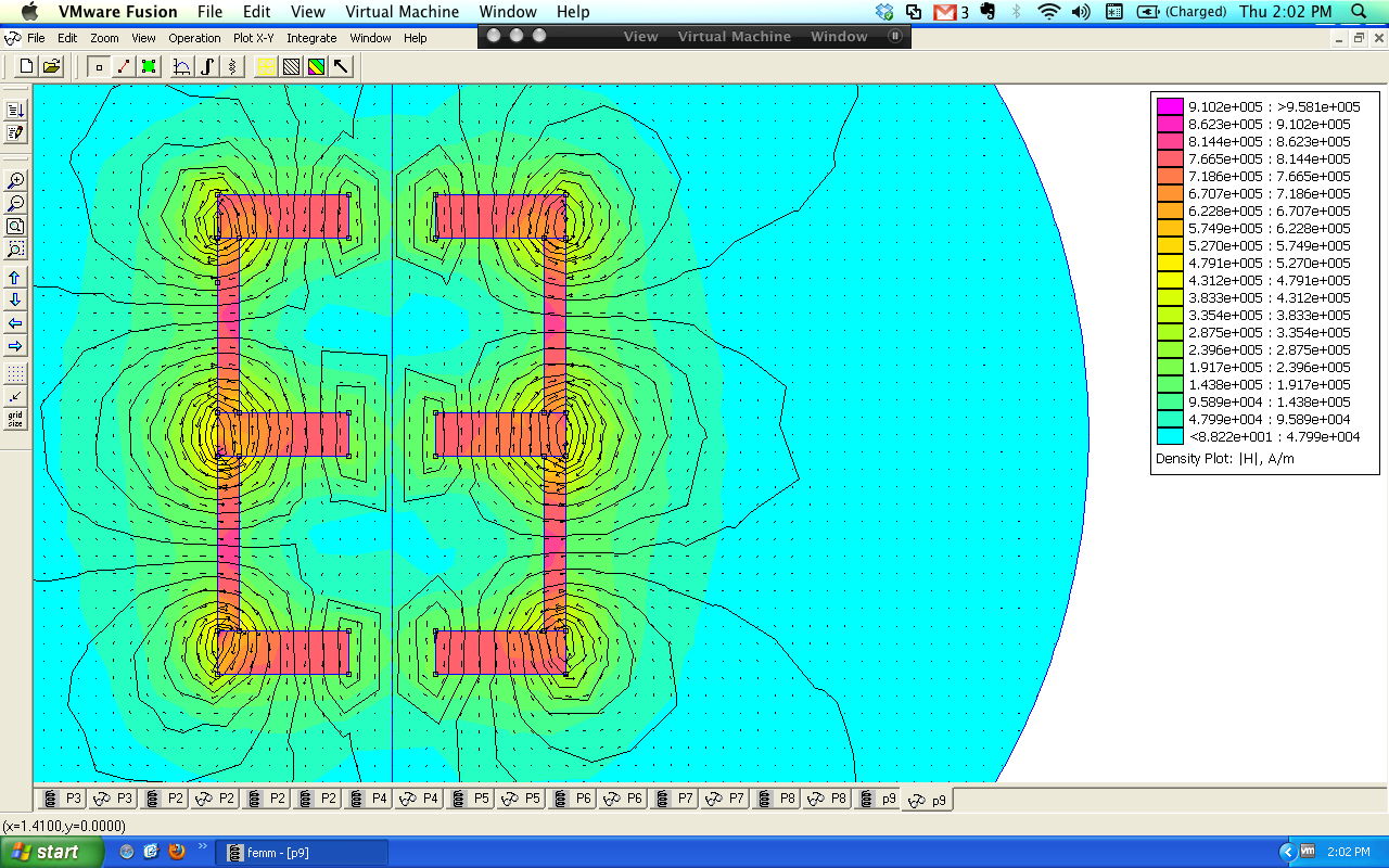

- Unfortunately neo radial is not as strong as you might think. You are correct about needing more steel in the return structure, the field strength is not enough to saturate the gap for this configuration.
- To truly saturate the air gap you must use the steel to concentrate the magnet surface area down to a smaller air gap.
IMO you are trying to squeeze too much into a small package. You will not find a 130mm cone + surround assembly that is suitable for 20mm +/- excursion, and a spider may exist but not for a 130mm chassis.
Peca,
I was incorrect. You can saturate the gap if you have a solid pole piece.
Thank you very much Neo Dan!
Yes, your simulation thumbs show exactly what I think. But there also is possible for sure in such magnet construction to push something stronger field with also longer gap
, disregard whether than iron pole pieces will be enough fat for some the best (better) optimum result.
