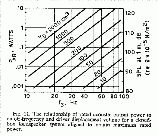

potential SPL at a certain frequency is simply swept cone area x displacement.
this spreadsheet will tell you what you can get:
https://www.linkwitzlab.com/spl_max1.xls
(note this tells you nothing about distortion, power limitation, room modes, etc)

Yeah, first determine authority. If its nice loud listening volume without too much distortion, say 90db at one meter, then look at chart to get volume displacement required.
Perhaps 170cm3 volume displacement makes 90db at one meter 25Hz. 5" driver has cone area of roughly 80cm2 so excursion would need to be about 2cm. Four 5" drivers would make perhaps low enough distortion 0.5cm excursion.
90db of low bass is not as loud as 90db of 1kHz, usually we need more, much more, say 100db. According to volume displacement graph ~25Hz at 100db takes 15" driver ( Sd around 850cm2) to make ~0.5cm excursion, perhaps some authority already? This is roughly 5x 5" drivers doing 1cm excursion. 5" driver have around 10 times less surface area than single 15". Adapt to each situation.
To really have authority, 15db headroom, shoot for the 1 acoustic Watt territory, 2000cm3, or 50x 5" drivers doing 0.5cm excursion, or couple proper 18" or 21" drivers.
