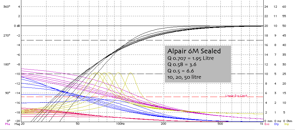

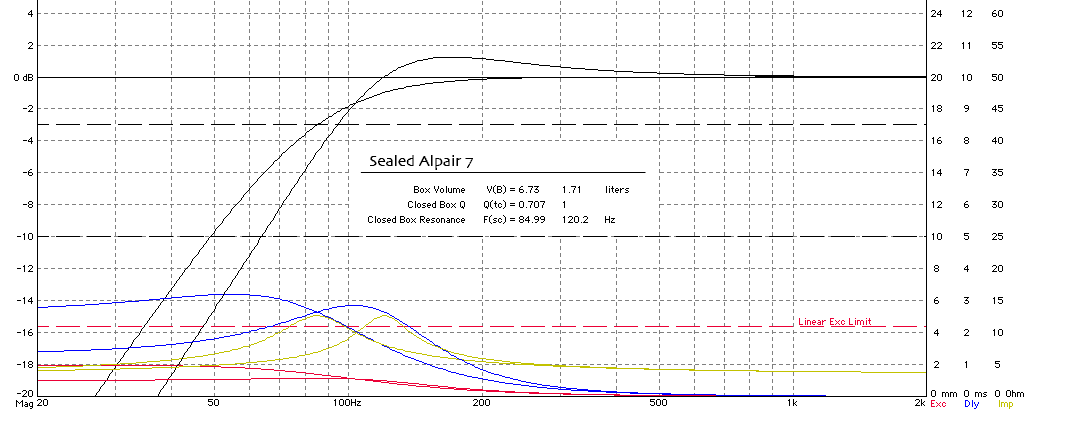

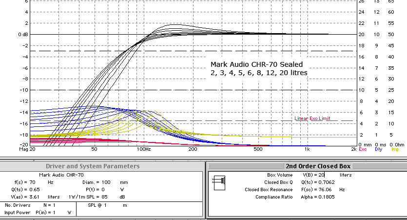

A designer friend wishes to build a wall-mounted phone and iPod docking station and place-for-house-keys-and-stuff. I'm steering him towards Mark Audio drivers - he likes the look and I've assured him that he'll like the sound, too.
I think he's OK with using a subwoofer. Perhaps an overly broad question: For each of the new-shape Alpair series, what is the smallest reasonable sealed cabinet volume? I.e. the Alpair 6P and 6M, Alpair 7, Alpair 10.2 and Alpair 12? And perhaps the CHP-70 as well ...
Or alternatively, is there something in the T/S parameters that you can look at to get a very rough estimate of a good cabinet volume?
Thank you!

Excellent information! Thanks. Exactly what we need to get started.
The designer had anticipated an internal volume of about 8-18 liters internally. According to this AJdesign box simulator, an 8-liter box could support an Alpair 10.2 pretty well, with a -3dB point of ~70Hz.
