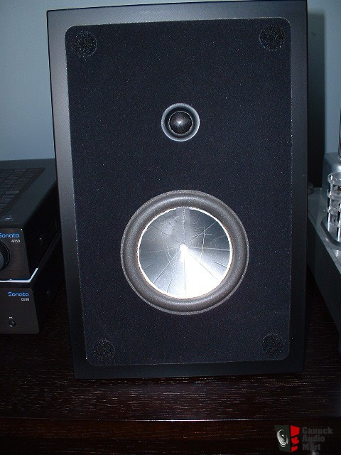

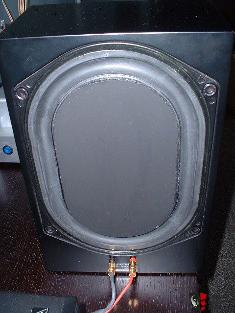

The Swiss made Pawel Acoustic Ensemble Reference speakers utilized a KEF PR mounted on the back of the speaker. The woofer was a unique Gorlich design that sported a pure cone shape (no dust cap) and foil-covered honeycomb sandwich constructed cone. Very fast response. The cabinet was stuffed to the max with fine Polyester fiber. I don't recall the exact KEF p/n for that PR but some searching should turn it up. It had an oval race track shape.
You need to use a box program like UniBox - Unified Box Model for Loudspeaker Design, that has a Passive Radiator calculator. This will allow you to see how well the driver and PR will go together (F3, xmax and xmechanical in particular) and how much weight may need to be added to the PR.
Peerless has a couple of smaller PR's that when doubled up might also work for a small box application.
