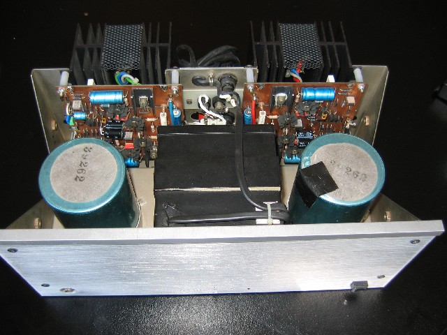

AndrewT said:Hi Pooge,
Taken further, could higher fTs allow a slightly smaller Miller comp cap to be used and still retain the same GBW product and the same phase margin?
My chosen VAS has slightly less Cob, so effectively my PCB has slightly less Ccomp already, so further reduction in Miller comp cap will have to be investigated carefully.
Actually, you may have to increase the lag cap to make up for the lower Cob of transistors used, to maintain the same GBP. It is the parallel combination of the lag cap and Cob that is the factor. This isn't a bad thing, since the added cap is more linear than the transitor Cob. Therefore, lowering Cob and raising the lag cap to get the same overall capacitance is good because it reduces modulation in the VAS.
AndrewT said:Hi,
the drivers run at about 5mA to 6mA depending on voltage but mostly on the r51 value.
They work as a mini output stage supplying quiescent current through each other and none to a quiet load. As the load demands current the drivers send some to the output. On alternate half peaks each of the drivers takes a turn to supply the current and the partner driver gets less quiescent current. As the load current increses the drivers continue supplying the extra current until one or other driver has almost no quiescent current flowing through it. Just before output current reaches this stage the drivers will be running at nearly double Iq and nearly zero Iq. This is the end of the ClassA portion. As the driver stops supplying current the driver pair start to work in a sort of ClassAB supplying all their current to the output stage.
For my output stage with hFE of about 80 to 100, the drivers move into ClassAB at about 400mA to 500mA of load current. The output stage went into ClassAB way back at about 200mA to 300mA depending on what output Iq one set up.
If I have this right then the amp transitions into ClassAB at two levels:- when output current reaches 2*Output IQ and again when output current reaches hFE*2*Driver IQ. I am wondering if there could be any or even a slight difference in sound quality/technical performance if the driver Iq was increased.
BTW. I have already substituted ALL the BOM transistors for what I think are better versions, with particular attention to hFE and fT, even at the expense of more fragility. I do not use 4ohm speakers.
Have I got the circuit operation correctly described?
reference to fig13 shows Leach stating "Q14 and Q16 Do Not Cut Off" but equally it also shows NO MODULATION of driver current into the opposite current peak. I believe this implies that the driver supplies no current to the output stage after it uses up it's reserve of Driver Iq.
Looking again at the right hand half of the graph shows the driver current (Ie16) rising to about 15mA to 20mA for an output current (Ie18+Ie20) of about 1.2A. It appears that output hFE=60 to 80. This requires about 9V output into an 8ohm load. This is well short of the maximum ability of the amp and the simulation graph shows behaviour upto about 5W output rather than all the way to 120W output (Ie18 +Ie20=5.4A).
If the graph had shown the full range of currents I think you would appreciate even more, that the drivers have effectively stopped supplying current into the other half peaks at a very early stage in the hand over process.
Again have I got this right?
Feed back please!

Hi Pooge,
I'm glad to see at least someone is prepared to read my hypothesis and be ready to argue the point being made.
The 400mA to 500mA figure I have used
PS. do you type the author in your quoted extract or is that generated by the Forum Software?
refer to LOAD current not base current. At this level of output current the amp is delivering just 800mW of sinusoid power into an 8ohm load. At the Iq level of 140mA the output stage goes into ClassAB at about 280mA (or slightly less) and drives 310mW of sinusoid power into an 8ohm load.the drivers move into ClassAB at about 400mA to 500mA of load current.

There are different definitions of Class A.
See, for example, Elliot's class A page:
http://sound.westhost.com/class-a.htm
where he defines class A as conducting for 360 degrees, or never reaching cutoff or saturation.
While your definition is one of the definitions, I think it is more common in voltage gain stages rather than current gain stages. In the amp output, the voltage gain is around unity. Also, remember that current from the predriver is also available.

this is what i understand to be the way those drivers operate, jim bongiorno also explained it like this for his GAS amps..
this is one area where ESP got it completely wrong. He had to rewrite his ClassA section to correct the faults and misunderstandings of how a Push Pull ClassA stage worked.
I believe he still does not UNDERSTAND this part of the subject and for this reason I could not recommend ESP as a source for ClassA information.
Class A is all about current NOT voltage.
Change from high ohm speakers to low ohm speakers and an output stage that was pure ClassA for all output powers becomes ClassAB when the stage output current exceeds the ClassA current.
the input resistor to ground r17 is usually set to 22k to match the NFB resistors.
I have built two versions and both have a 20 to 25mV output offset.
If I change r17 to about 33k the offset moves to almost 0mV and seems to hold quite steady over a range of temperatures.
Why is it necessary to UNmatch the input and NFB resistors to zero the output offset?
Is there a component I have used that is causing this slightly high offset? Where should I look.
The 33k for r17 better suits my input filter ( I would prefer 51k) and I'm likely to keep it this way, but I would like to understand what is causing the offset.

R17 and R11 of Jens' boards match R1 and R2 of Leach's, according to my notes.
It is R17 and R11 that should ADD to 22k to match feedback network R12 + R13 of 22k.
This is what Leach specified.
Also, you should measure this with the input open. If you short it, it will upset the balance.
I'm not sure why this specification is so important, because when you connect to the output impedance of the preamp or the like, you are putting in a parallel impedance of 100 ohms or so, which, in combination with R17, reduces the value below 100 ohms. I fell into this trap of measuring when I added an input transformer, which output impedance threw off the DC balance.

If this were implemented then r17 would be less than 22k. That in turn would make the output offset worse not less.It is R17 and R11 that should ADD to 22k to match feedback network R12 + R13 of 22k.This is what Leach specified
Quite why Leach arranges his input components this way is a mystery but he must have had a reason/s.
The Leach arrangement , which many others also adopt, deliberately unbalances the input conditions on the two sides of the LTP.
But I come back to the "understanding" of why the need to unmatch the input impedances is necessary to zero the output offset.
Similarly DC couple the NFB and AC couple the input does not balance out easily.
Either AC couple or DC couple . Do not mix or you may have wierd DC output offsets at various times from cold startup to quiescent running to gentle background to full on party night (annoy the neighbours) temperatures
Warning !!! DC couple and then inadvertently add a DC blocked output from another pre-amp and at a stroke you have a mixed AC/DC coupled amplifier. Take care, or install two input RCAs, one DC input and the other AC input which Jens allowed for on his PCB.
you are into the realms of partial DC coupling i.e. DC couple the non-inverting input but AC couple the NFB. This is really difficult to balance out and retain sensible impedances around the LTP stage. Don't!!Also, you should measure this with the input open. If you short it, it will upset the balance. .............connect to the output impedance of the preamp or the like, you are putting in a parallel impedance of 100 ohms or so, which, in combination with R17, reduces the value below 100 ohms.
