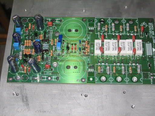

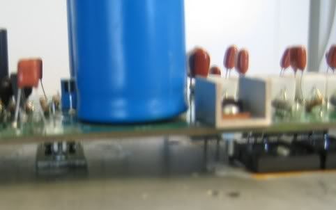

Here's the pic I promisied. As you can see they fit fairly easily. Whether or not to use them is you own decision.
Blessings, Terry

still4given said:I do have a question though. Does the value of L1 matter all that much. Will an 8.2R resistor work there instead of a 10R? Isn't the resistor more just for a frame for the coil?
Thanks, Terry
The resistor should be ok as 8.2R... it is there to dampen any ringing in the inductor.

still4given said:Well I've already soldered them in so I guess I'll hear it like this first. If I hear something bad I'll think about changing them.
Thanks, Terry
Terry, you may not hear anything bad with these resistors. I am just trying to build the best amp that I can, so I'm trying to get the best parts, not the cheapest, to match the quality of the boards. Along with the 1% tolerance and the non-inductance, the Mills have a TCR of 50ppm compared to the 300ppm that you are using. They have all welded construction for reliability and are non-magnetic. They are said to "sound" wonderful, but I have not directly compared them to others. Whether anyone wants to spend the extra money for them is up to them. The high-end police will not be knocking on your door if you don't.
The 8.2R resistor is fine. Leach actually raised this value from a lower value in previous versions of the amplifier. The lower value should work even better, according to Self, in its function as a damping resistor. Self showed that damping improved down to 1 ohm. Don't know why Leach raised it. Maybe it was because it is easier to obtain.
L1 value is also not critical. With the split feedback path in the Leach amp, L1 is not as important to prevent oscillation from capacitive loads as it would be if the feedback was not split. The value is around 1uH, which keeps output impedance down at higher frequencies compared to, say, typical 6 or 7uH values, which is about the limit for good extended frequency response, according to Self. Leach even said that L1 may not be needed with the split feedback. However, it is good to keep it there to prevent RF injection into the feedback path from the speaker cable antennas. Remember to use a non-magnetic resistor to wind L1 around, though, so it doesn't saturate. One trick I read is to wind L1 around a pencil, first, before sliding it on to the resistor. Makes it easier to wind.

I'll go ahead and use the 8.2R for L1. Leach shows R51 as 10R 2W. Is there a need for it to be 5W? I couldn't find any 5w at the store but I have 2W.

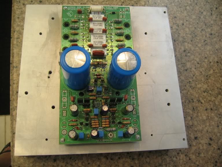

Well. as you can see from these pics, I am almost done with the boards. I would still like to try building a regulator for the front end if I can get a PCB together for it.
I may just install R1 & R23 so I can test to see if I've messed anything up.

Actually, if I'm looking at the boards correctly, they are to fuse the backend when running the front end seperately. I am still hoping to build regulation for the front end and run them seperately, in which case I might use F3 and F4.
Those heatsinks were planned for the superamp that I couldn't get working. They are probably over kill for this amp.

Boards look good! But you might want to reduce the length of the pins on those caps in the output stage... big risk of blowing fuses as any short curcuit between the cap pins will short the rails to ground!!!!

Hi Terry,
your heatsinks when oriented vertically will leave the input end of the PCB at the top of your case (stereo?). How about RCAs or XLRs fitted into the top instead of the sides? Then the cables from & to the ancilliaries will just rise up to the adjacent equipment. The output transistors will cool better if they are slightly below the middle of the sink, so do not be tempted to turn the sink upside down. Your driver sinks are a tight fit!
Your case will only need two more sides. To make building and future maintenance easier make a frame to hold the panels in place and then any or all the panels can be removed at any time. The floor panel could also be demountable if the transformer is hung from a strap bridging between the sinks, this may reduce some mechanical noise getting into the case. It might make maintenance safer if ALL the mains connections were only accessible from the bottom as well.
BUT it is really important that any demountable metal panels EACH have a permanent earth lead back to the mains safety earth point.
If and when you go regulated front end, then piggyback the small reg PSU PCB above the input end of the main PCB and arrange the interconnections to just drop straight between the respective boards. Keeps all the leads short. Or bring all the leads to an edge so that the reg PSU can be folded sideways for access to underside and to the main board.
