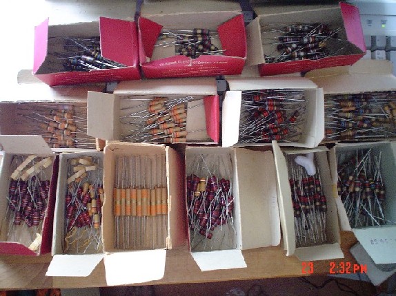

Looks like with a minimal amount of postage, a few of those carbon comps could easily get to my mailbox. 😀
