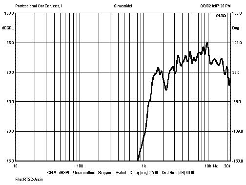

I have 4 amt monitors and I have been playing around with several ribbons; HiVi RT2-C, Dayton PT2, Neo3PDR/FP and the NEO8PDR. The HiVi I have in a center channel with the AMTs as the L/R this is a good combination, but you must cross the HiVi above 2K. I am in the process of designing a MMT with the NEO3 PDRFP. I tested the NEO3PDR in a dipole and could not hope to get a flat response so I ordered the face plate kit. This should make them a little flater. I also tested the NEO8PDR and came to the same conclusion so using it as a single tweeter is on hold till I can design a rear enclosesure to flatten te response. I havent tested the PT2 but it looks like a cheaper cousin of the RT2-C
Here is a spl file I have on the RT2-C
MES said:I have 4 amt monitors and I have been playing around with several ribbons; HiVi RT2-C, Dayton PT2, Neo3PDR/FP and the NEO8PDR. The HiVi I have in a center channel with the AMTs as the L/R this is a good combination, but you must cross the HiVi above 2K. I am in the process of designing a MMT with the NEO3 PDRFP. I tested the NEO3PDR in a dipole and could not hope to get a flat response so I ordered the face plate kit. This should make them a little flater. I also tested the NEO8PDR and came to the same conclusion so using it as a single tweeter is on hold till I can design a rear enclosesure to flatten te response. I havent tested the PT2 but it looks like a cheaper cousin of the RT2-C

So, in you opinion, are these tweeters comparable to the air motion transformers or not?
YES!, they have a folded element just like The AMTs. They use neodinium magnets. They do not have an open back, dipole configuration though. They even have a similiar response curve, though I didn't post the AMT, as the file is on my dedecated Clio pc and not on this pc. They do not have the power handling and they will not go as low. I think most of this type of tweeter will sound similiar because of the way they work ie the voice coil is the driver cone.
