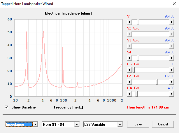

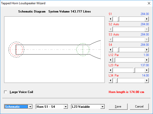

The only practical way to model this thing is to model it as a tapped horn. That's because the woofer is mounted inside of the port. I made an Akabak model, and the Akabak model was consistent with hornresp. The pic above illustrates how you model this. The mouth of the port is "S4." The woofer is mounted at "S3", just as in a tapped horn. The chamber of the vented box becomes the throat chamber of the horn. Basically the woofer is mounted inverted, with the basket IN the throat chamber.
Again, if none of this makes sense, I have an Akabak model that simmed very similar, so this method seems to be repeatable.

If your diagram is drawn to scale, I'd be concerned about the woofer blocking a bit too much of the port. Maybe if it's countersunk rather than mounted directly on the side panel...
Have you tried moving the woofer's location along the vent to see if that could minimize or eliminate the null that's appearing at just over 100 Hz?

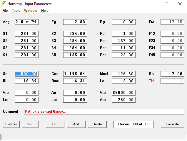

Oh, try the "TH2" alignment in HornResp. With your existing choice of alignment, the drawing does not match the hornResp sim (the expansion starts at the driver's egdge, not its center).
Oh, the other problem you're going to run into with that design is that the woofer's pole vent is likely to be blocked too much (unless of course you use a woofer that does not have a pole vent 🙂. Now, if you can shift the woofer to be on the expanding section...
I have an Akabak model that's consistent with the diagram. To model it properly, you need five segments. (Hornresp only supports four.)
I wanted to make the design as simple as humanly possible.
I am using a woofer that I bought from Craigslist for $32.50, so I didn't want to do anything "fancy" like mounting the woofer on the expanding section.
I intentionally used cheap wood, because I wanted to see if it was possible to make a fairly decent performing home theater sub for under $100. Basically wanted to find out if I could exceed the performance of a 'Wal Mart' subwoofer using cheap drivers off of Craigslist, cheap wood, and easy construction.
I left a very very small gap between the pole vent and the wall, about 1/2". This isn't a high power sub; this is designed to be a cheap sub that can play 30hz, doesn't cost a lot of money, and is intended to be one sub of a subwoofer array.

I think it can be modelled in HornResp using the "TH1" alignment option, which puts the tap at S3 instead of S4. See below.

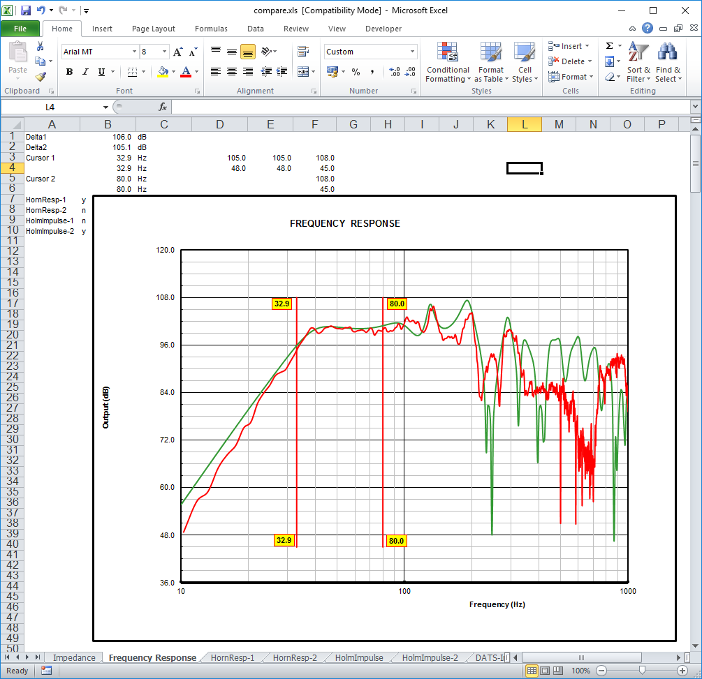

It's difficult to compare sims vs. actual responses just from images, particularly if the graphs have different minimums and maximums for their axes.
I've got a simple workbook that makes the comparison simpler. Basically you just export the HornResp predictions to a data file, then copy that data to the appropriate spreadsheet in the workbook. Ditto for DATS measurements and measurements from HolmImpulse (though it can be jigged to support REW quite easily.
See example below - predicted vs. measured response for my B1 TH design.
Drop me an e-mail if you want a copy.
Note: higher impedance at low frequencies usually also means higher cone excursion for a given voltage input. Probably not the best place to apply a boost 🙂
