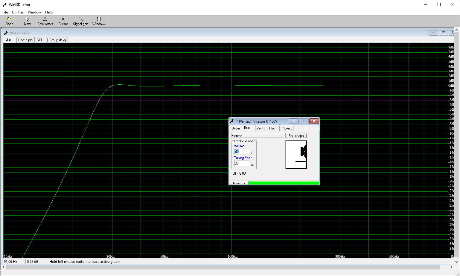

I've been given two of these woofer, almost for free:
KT 100 V - 4 Ohm | Visaton
Since I have them, I was thinking to build a small subwoofer to be added to my HiFi system.
The idea was to build a small cabinet that could fit under a furniture, so it will be practically invisible.
To increase the perfromance and even reduce the size, I'm contemplating the idea to mount the two woofers in an isobaric configuration:
Isobaric Subwoofer Design — VUE Audiotechnik
I do prefer the vented cone to cone solution.
So, I simulated the thing with WinISD, and it seems to be flat down to 30Hz, with a cut-out frequency (at -3dB) of about 26 Hz.
Mounted in a 11 Liters vented box.
The simulation seems interesting.
Before to start the construction, however, I'd like to hear from you what do you think about this idea.
Anyone here with real experience with these drivers?
What do you think about the idea to having two small drivers in isobaric configuration?
Could someone simulate the configuration (on the maker site you can find the relevant driver Thiele-Small parameters)?
Any suggestion, doubt, idea?
Do you think is it worth to build such a subwoofer?
Thank you in advance.

Haven't tried those drivers, but the relatively small voice-coil overhang concerns me. Combined with the small cones and isobaric design (ie, you effectively only have 1x 4" cone), you won't get much SPL.
With a Qts of 0.56, a 4th order bandpass might be worth a try.

If you feel adventurous, you could design an 8th order bandpass box. Maximum bass output for a given driver, except for horns. It will be picky to Thiele / Small parameters, so these need to be measured first.
For your stated use your subwoofer will not be man enough for the job. According to the data sheet you have a driver with a SPL of 80dB (-10dB @ 30Hz). It's a 25w driver. Somebody else can do the math but I'm guessing the maximum SPL of the driver at sub frequencies is around 87dB. (90dB for both drivers being driven by an amp capable of 2 ohms. Or a stereo 4 ohm amp.
You state the you're trying to augment your existing hi-fi. A pair of bookshelf speakers are likely to produce a 1 watt output of over 90dB. For your sub to create a flat bass extension it will need to be cranked up to full power when your main speakers output is 1 watt each.
The sensitivity rating of your drivers is the lowest I've seen. The are many 4" drivers that will achieve the same volume using only 25% of the power.
Surtsey,
The datasheet sensitivity number doesn't really apply here: we're operating in the Thiele-Small region, where the cabinet + driver combination will determine the sensitivity.
I threw together a quick 4th order bandpass using Hornresp. It's not a small box, at 33L internal. It does, however, manage 84dB at 2.83v with the drivers in series. ie, 1w into the 8ohm (nominal) load. The bandwidth is approx 40Hz-90Hz.
Pushed against a wall or into a corner, the SPL would increase dramatically, and might turn it into a useful little subwoofer.
Rear chamber = 24L
Front chamber = 7L
Port = 44cm^2 area, 46cm long.
There are certainly better drivers in the world, but these aren't entirely useless.

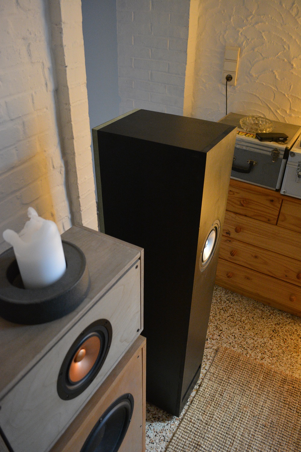

Wel, i don't agree, you can get a satisfying bass out of smaller drivers. I do it with a 6" fullrange in a big MLTL, and get a good bass out of it to about 32Hz F3 in a room of 3.5x6x2.5m. But that driver, the Mark Audio CHN110, has decent xmax (8mm) and BL (5.82), and i use a huge cabinet that emphase the bass (see pic of the cabinet, still in prototype phase).
That Visaton does not have the xmax or BL to do that, and a 4" cone is very small, so very hard to impossible to get loud bass out of it. Even in an TL type of cabinet it won't give loud bass. And it's true that a bigger cone can do it easier. But you can get a decent bass out of the right small cone in the right cabinet.
