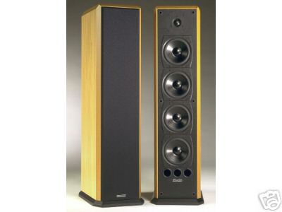

I agree with Bob, though you would have about the same displacement as a larger woofer, this would only increase your theoretical SPL at all frequencies. Also, your woofers will need to be wired in phase. Though, I've always thought that this would not work without EQ because you can't have the natural resonance that a larger woofer comprises without such circuitry; and, the previous comments confirm the latter.
Anyway, I'm still interested in building a line array some time, preferably an OB line array.
BTW, Polk Audio used to use some 3-4" drivers x4 in their older TL models. Not sure if they still sell them or not, but I remember seeing them and their power ports in the bottom.
